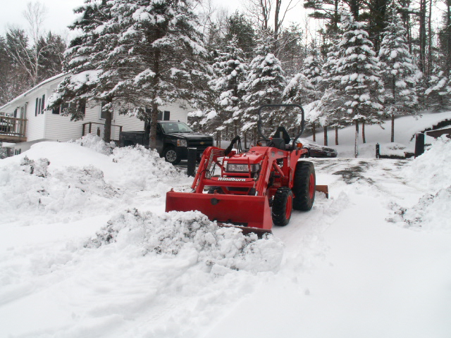

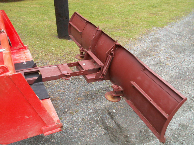

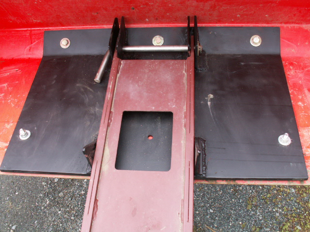

I've useing this type setup since 1995..yet to have problem.
Pull one pin plow free from bucket.

Jonnyc...I built it myself.
When plow set at 45 degrees..both angles..plow should touch bucket for more pushing support.
Theres times the old way still the best way,beside gives one chance to loosen the legs when switching angles. ;)

If you pan to 45 degree plow,I found blade should be least 6" be on rear wheel.
1/4" metal for frame also bracing as you see fit.

Here's a tip: the pivot pin that is used for the blade angle should be soft- think shearpin. When (not if ;) ) the edge of your blade catches something solid and you are plowing a bit too fast, your mass should shear the pin instead of breaking something important.
You already have the springs for when the bottom edge of your blade catches something.
Carry a few spares with you. You never know what is hidding in someone's driveway! Ask me how I know :p Mine was a rear blade in the middle of that big snowstorm. Broke 4 pins that week, but it was a state of emergency.
