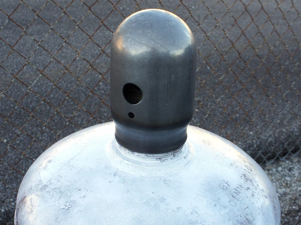

Propane 100 lb. bottles/tanks are supposed to have it's cap on when transporting. Like this one...
   / Moving 100LB Propane Tank with FEL? #56
Yup, great practice true for all compressed gas tanks being transported at all times. Nobody wants a sheared valve. There are "caps" that allow for regulators to remain attached, but I have no idea on the legality of that. It might meet the letter of the law, but it doesn't pass my sniff test on the spirit of the law to protect the tank valve.

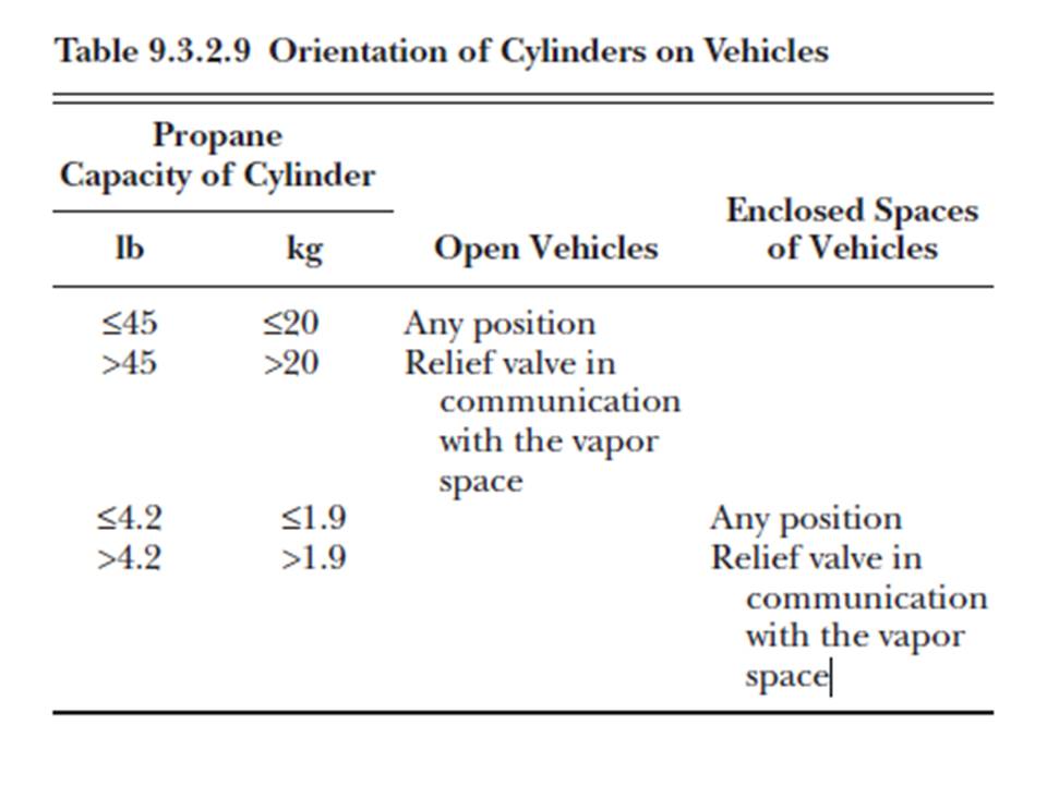

Your correct, less then 45 lb can be in any position an greater then 45 lb must be in vapor space. From 2014 edition
Guess its one of those some fill stations will let you lay them down and others say no. Since trucks normally require at least 100 gallons to be delivered, I'll still have mine filled and haul back laying down in back of the pickup
Thanks for the table.
I'm looking to transport a 30lb'er in my Escape. It should fit in the backseat standing up and strapped in :)

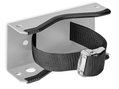

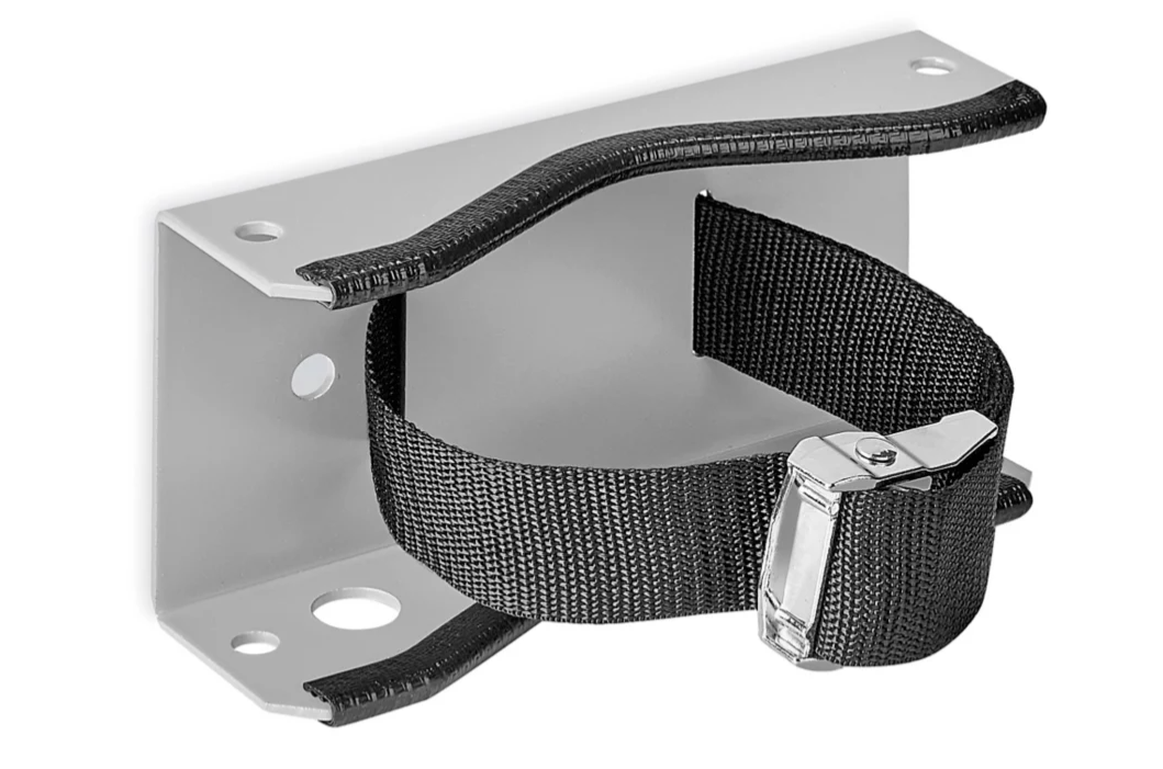

I use this bracket bolted to a hand truck:
I fetch the tank with the hand truck, lift it by the handle with the FEL, put it in the truck bed and move it into position for transport.
Makes it a snap to move around.
