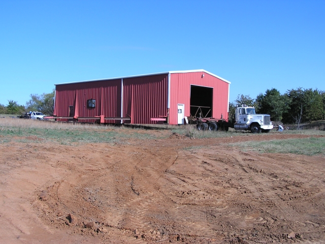

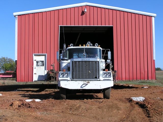

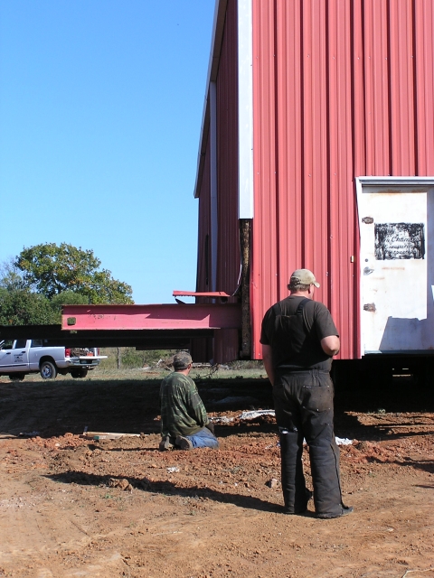

So here are some pix of the barn move.
1. Barn in tow coming through pasture
2. Made the turn to align with the piers (Big truck, huh)
3. Getting lined up over piers.
4. Checking to ensure cut off column bases are in alignment with the piers. Note excess steel I beams sticking out.
5. Pier is 18 inches in diameter with "mushroom" top. The 6x6 weld plates were not well located by cement guy's low dollar help so some were dead on and some were off by varying amounts. I devised a mating system that accommodated considerable imprecision in weld plate location. Pix to follow on that.

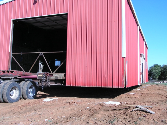

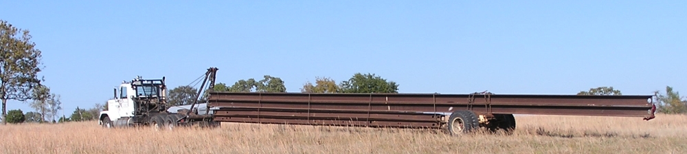

6. Here is the Mac after the steel was removed from the building and reloaded for transport. The longer beams were 80 feet and the shorter ones 50.
The longer ones were running longwise of the bld with the shorter ones transverse atop the long ones.
Lateral resistance to wind forces was supplied by the 3 ft of 6 5/8 inch pipe columns (5/16 wall thickness) buried below the slab surface into a large footer. As I attached the bottoms of the severed columns to the top of the piers (will act like a hinge) there is little wind resistance and the entire bld could be collapsed like a parallelogram by a decent wind. So... I welded braces between the columns and the roof trusses to form triangles to resist lateral loading. These are high enough up to not get in the way of most operations.

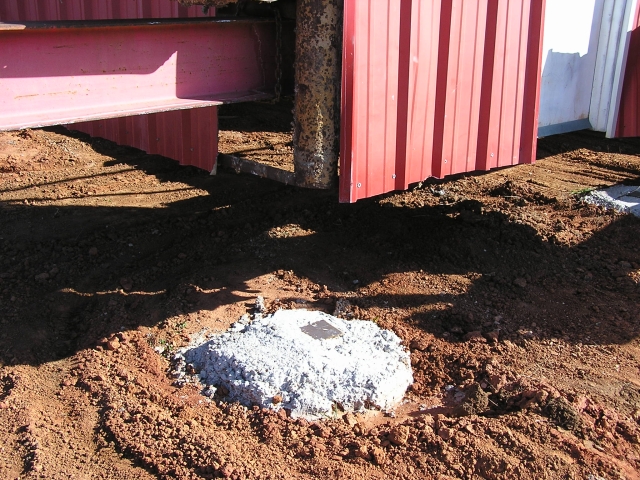

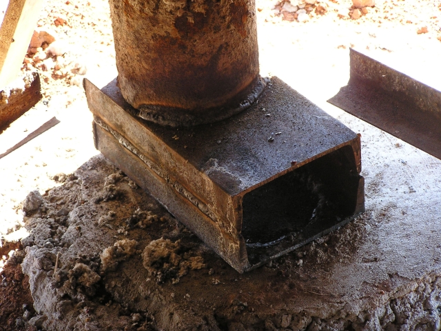

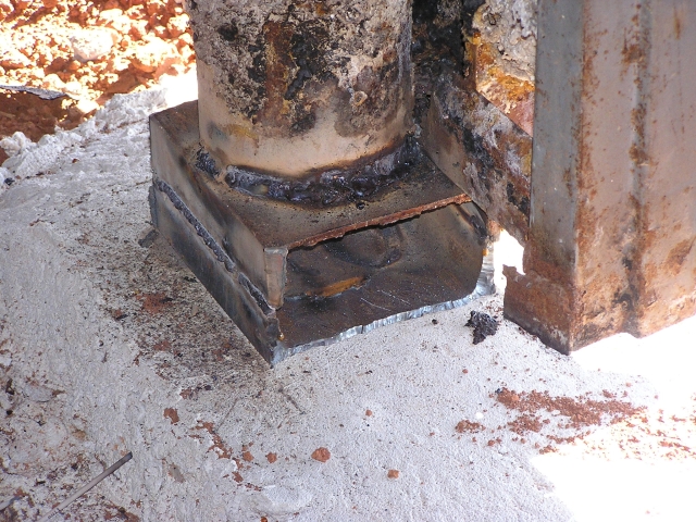

Here is some detail on how I "fixed" the mediocre weld plate placement. (and other stuff)
1. In this view you can see inside the box formed by two pieces of 2x8 inch HD channel iron. Inside the box the careful observer can see the 6 inch diameter hole in the channel iron. This allows turning the channel in any direction so that the column will rest on the box. The circumference of the 6 inch hole is then welded to the weld plate affixed to the concrete by J bolts. In this first shot the fit is just fine, the column came down right directly above the weld plate.
2. This shot shows a column not directly over the weld plate but it rests firmly on the channel iron box and the weight is carried by the pier. Lateral strength is more than adequate given the pipe is 3/16 wall and the channel is way heavier (overkill actually but I paid only $2/running foot for the channel so what the heck.)

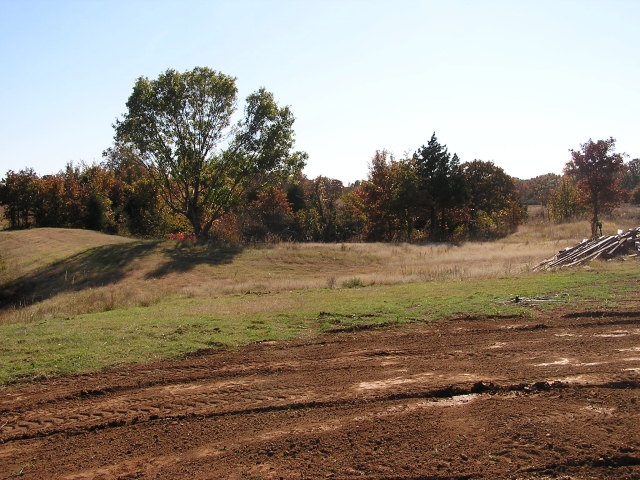

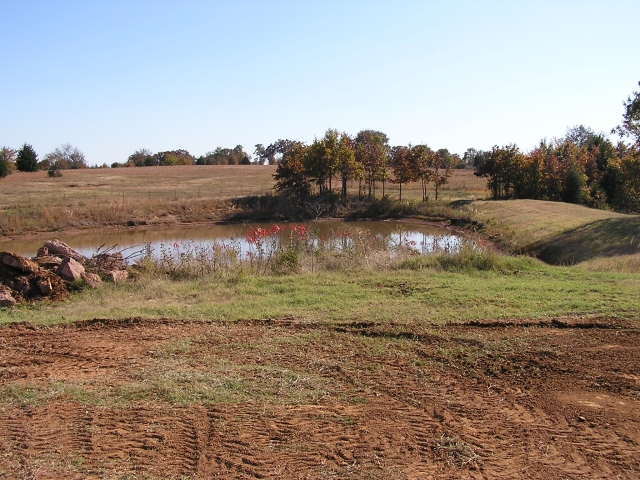

3. This third shot shows the location of the barn WRT the house. Perspective is quite distorted in the picture as the barn is well over 100 feet from the garage.
4. This is the view from the east end of the barn looking south across the catfish pond (they are gettin' rather big and eat like horses.)
5. Foreground is the nearly flat area at SE corner of the barn the greenest of the grass is all volunteer Bermuda that has grown since the pad was built. view is of the catfish pond dam on the left and a copse of trees beginning to show fall colors along the margin of the 2nd of three backyard ponds (below line of sight in this shot.)
