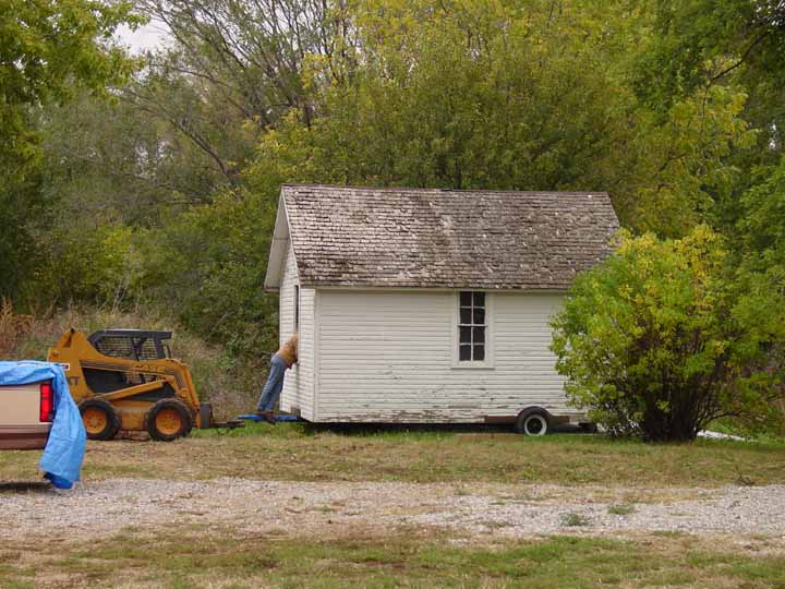

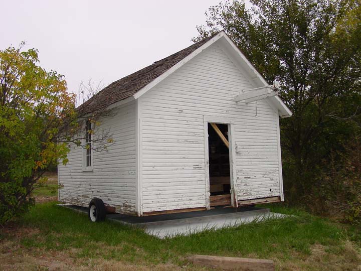

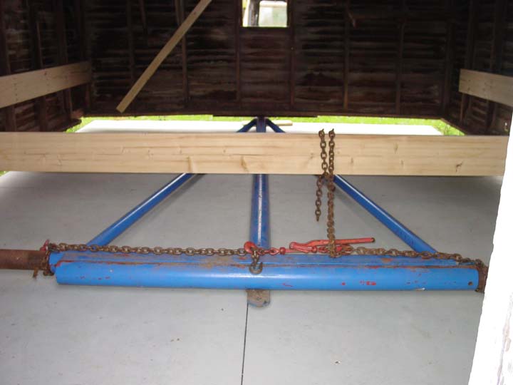

I asked the same question a while back. Here is how the movers moved a much smaller building of ours, 14x18. I don't know if this could work with a larger building.
   / Moving a Pole Barn #26
last one, on the move
