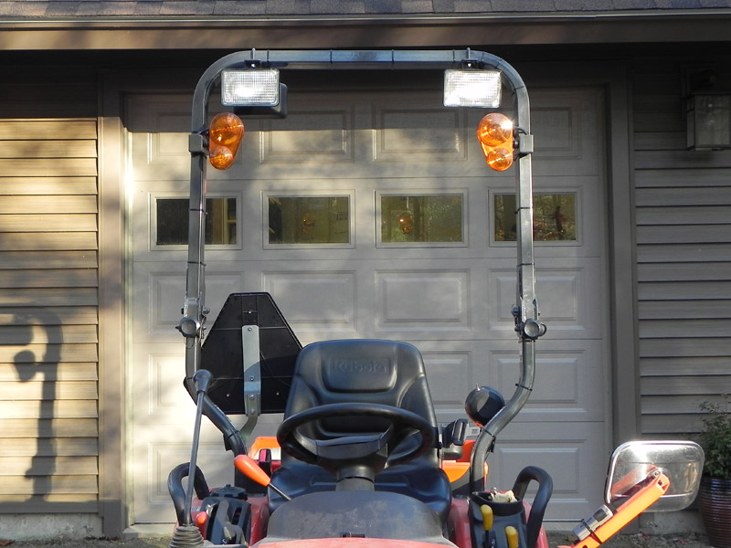

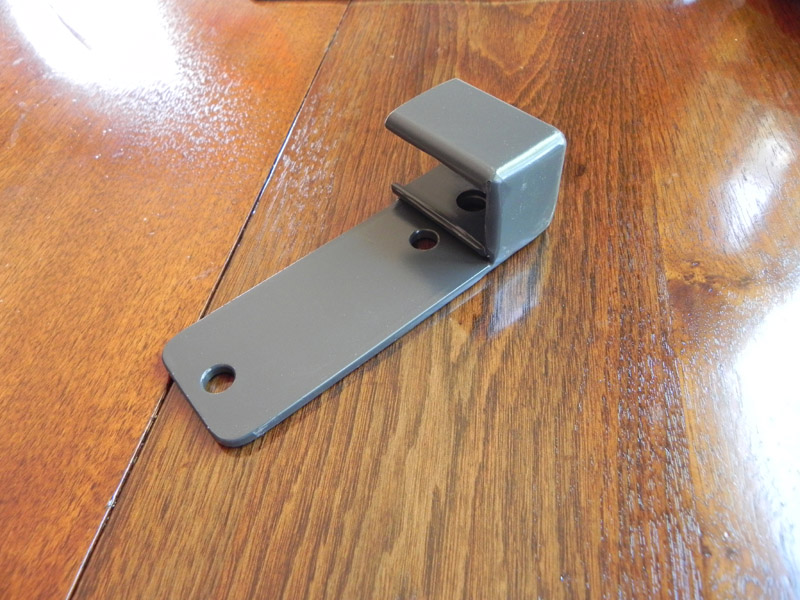

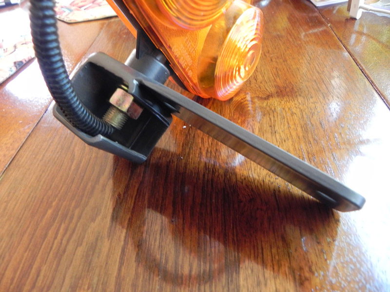

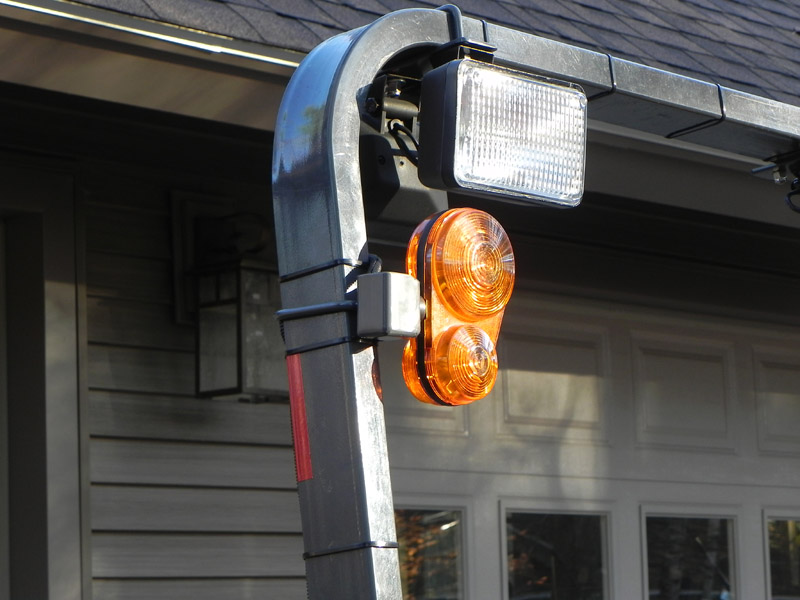

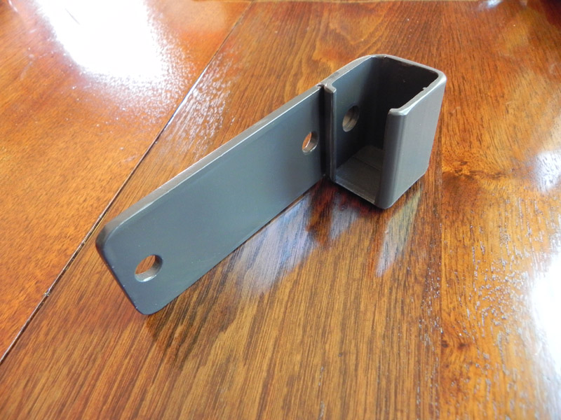

Well I finally got off my duff and got this mod done so I'm now just bringing closure to this very old thread. I fabricated some brackets and mounted the flashers up where they can be seen. I made the brackets so the flashers would be in front of the ROPS instead of between the uprights for side visibility. The photos show what was done. Thanks for looking.

Nice job! Is there enough slack in the wiring to fold down the ROPS?
Thanks, Bob. I ran the wire loom down the back of the ROPS so it's not a problem to fold it down, although it always stays up.
