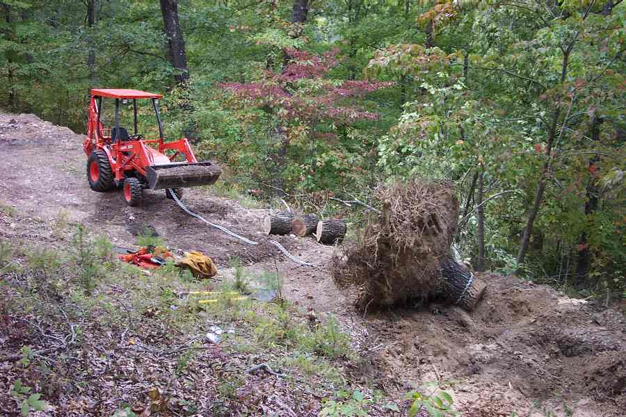

If you don’t care about the stump just use the chainsaw. If you’re building where the tree is or just don’t want the stump it’s easier and cheaper to remove the whole tree unless you own a stump grinder.
I’ve taken out about 25 trees, mostly oak, ranging in size up to 28” in diameter with my little B21. Smaller trees can easily be pushed over with the FEL or pulled down with a chain. The higher the push/pulling point the better. Bigger trees require digging around the base in order to cut the main roots. I start digging where the BH can cut through the roots.
Once the tree is down I cut it up for firewood. If it’s a large tree, I scratch down the root ball first using the BH. This is easier to do with the trunk still attached. Scratching the root ball off reduces its weight so it’s easier to manage with the tractor. Most of them still weigh more than the tractor but I flip’em or drag’em down to my holler for disposal – see attachment.
Be careful… I’m better dropping a tree where I want using the chainsaw. When pushing/pulling them over they can easily go +/- 45d from the intended direction.
