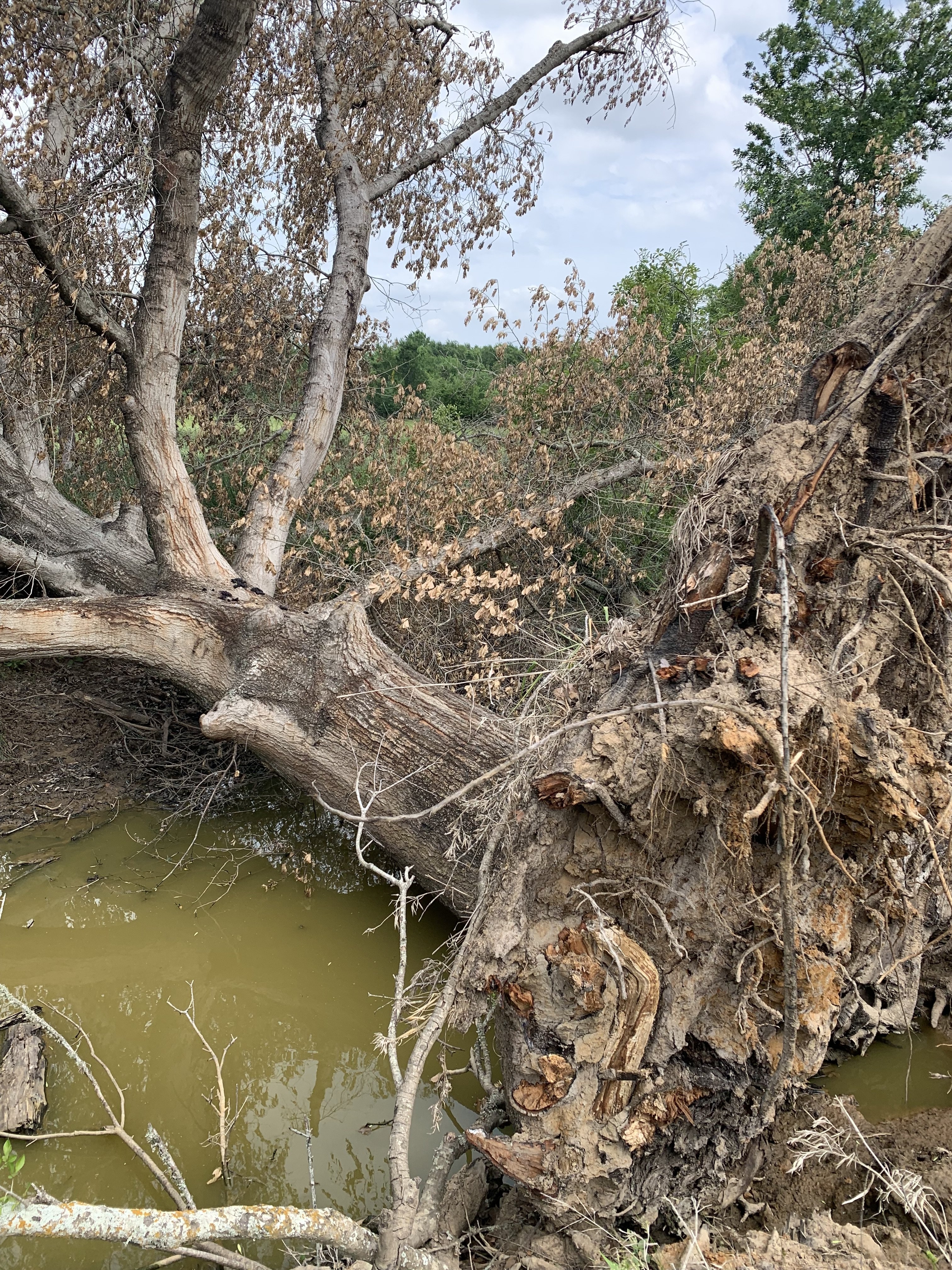

All information is appreciated. I’ve been exposed to many different concepts and educated thanks to all. In the end I’ve decided to have a dozer move it.

That's a lot of firewood!
