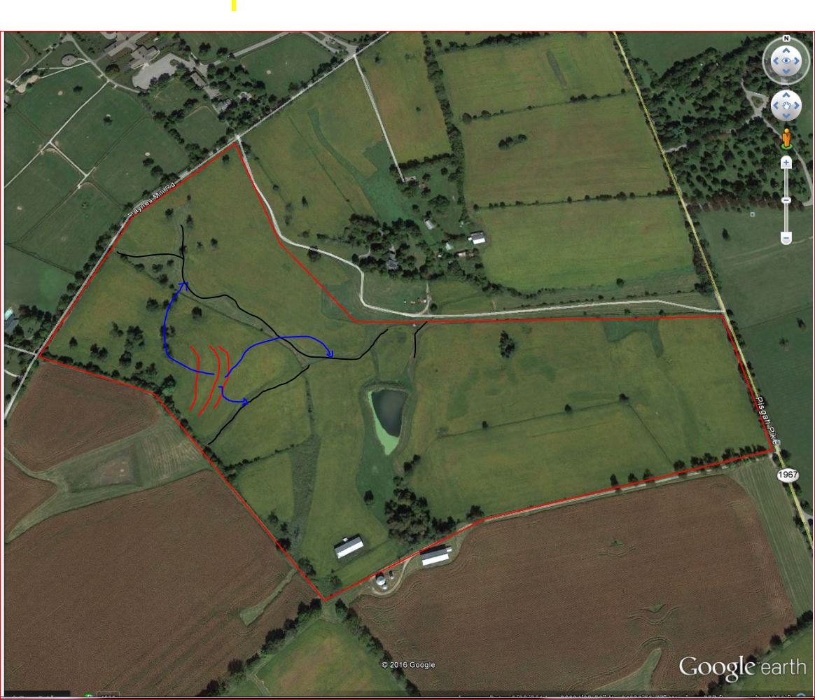

I'm currently working on building a new horse farm out of an old bean/corn farm.
I have some dirt work to do, not a HUGE amount, but enough over the next couple years, that I think investing in something which will move the dirt around my 84ac might be useful. I know... I know... 'Hire it out, save yourself' is a truth and I understand it. But $$$ and work interval is an issue. ie, I'm not exactly sure what and when I will need different things done. I have a general plan, but to hire all the dirt work out would be very expensive, if done all at once and even more expensive piecemeal. Besides... I bought the place to enjoy the work, not hire it all out.
So, what I have need for 'NOW' is to smooth out some small berms build along a small hill, in order to reseed it back into pasture. The berms were built for the beans and corn. Sod will prevent any washing... in fact, I'm surprised they were put in at all, given the gentle slope. But, they would be a problem for running horses, so out they must go. I have a place that could use this 'berm dirt' about 100yds away, a shallow wash area that has some small wash ditches, again from the cropland washoff. The pasture just across the road has the same terrain and has no wash issues, but it is in pasture rather than crops.
I will also have other dirt moving needs around the place, I'm sure.
My tractor is a 100hp JD 5100e. Cat 2 hitch. loaded tires 900+lbs each. Ag tires - slightly worn, but still in good condition.
I've been thinking about the monstrosity box at EA
But I'm uncertain whether this can move the dirt I need reasonably the distance I need it moved. I have never seen a video or in person, in which someone actually is moving real amounts of dirt any appreciable distance. I've seen ponds cleaned and small piles spread, but never anything approaching what I need done. I don't know whether that is because it is a rare need or whether they just don't do the job. EA... if you want to test this out, I would be happy to make videos with your big box blade moving dirt all over my acreage... just send me the blade and I will put it to work.
Its just that a $4K+ investment in a box blade that doesn't do what I need it to do, isn't a reality. And 'trying it out' with a smaller box blade and failing, doesn't really show me whether at reasonably heavy blade would have done the trick.
So... that brings me to pull scrapers. I KNOW they will do the trick... but then again... they are really One Trick Ponies... as far as I know. I can take that $4K and put it into a used 3-4cu yd scraper and move all the dirt I want. But then again, when I'm done, I'll have a nice rusty yard ornament until I need it again, down the road. I'm leaning this way, because I know it will do the job. But the versatility of the box blade is much more palatable if it would do the job I need.There is a local 3cu yd available for purchase. Nothing for rent. Farm dirt moving.JPG
I'd like to know your thoughts and experience. I'll need MUCH MORE than what I've shown on the pic, but this is the current 'need' and will have to be done this fall if not sooner. I'd like to get it moved before I get the whole thing drilled into pasture. I can drill the parts that I won't be messing with to the Southeast, and leave the 'work area' undrilled so I can work on it. But I need to have a plan for getting the dirt moved... and I'm running out of time.

I'd use the box blade to break down the berms to level ground and kind of pile up the spoils pushing them into piles. Then I'd use your loader for transporting the piles to where you want redistribute the soil.
Box blades are great tools. Use mine a lot for driveway maintenance and leveling spots or dragging earth from one area to another, but my dragging from one area to another is nowhere near as far as you'll be dragging yours, hence my comment about using your loader for transport.
If you will do a lot of box blade work, a top-n-tilt set up would be really nice to have. I don't have one so I manually adjust my box blade when using it, but mainly I attack my work from different angles a lot to keep from resetting the box blade frequently so the main adjustments I make are only setting the depth of the ripper shanks for either really breaking something up or more scraping off layer by layer.
I wouldn't hesitate to tackle what you're looking at doing with a box blade and loader by yourself instead of hiring it out. It will be fun tractor therapy for you.

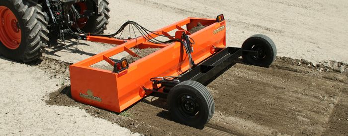

You're not too clear on just how much dirt you need to move around. :confused3: But if it's going to be 4-digit yardage, I wouldn't bother with "garden tools". You should invest in some heavy equipment unless time is of no concern. Don't rule out rentals and/or farming the job out either. A loader, dozer and dump truck can move more dirt in one day than you could do with small farm equipment in a year. After it's moved then you should consider a Land Leveler or Draw Grader for final grade and maintenance. Many of these have 20' blades and up.
Here's a 20' Notch Leveler: NOTCH 2' Land Leveler - YouTube

The Durabilt scraper you are considering would help with moving the dirt a longer distance. The problems I see with this simple type are shallow cutting depth of 1 to 3 inches and using the 3 pt hitch for height adjustment. If you need to finish grade and move dirt it would be a poor choice.
The better scraper designs control the blade height with hydraulic cylinders so that you can cut to grade and carry the dirt a longer distance. These models do cost more though and you may not have enough work to justify it.
A six ft. wide terrace row that is 18 inches height would have roughly 4.5 cu. ft. of dirt per linear foot. That is about 4 or 5 trips /100 ft. of terrace row using a 3.5 to 4 yd scraper. A 5 yd wheel loader could do this particular job fast and cheap imo. The money saved hiring this out could be better used in other places on the farm as there are countless things to spend money on.
