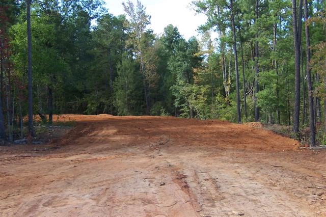

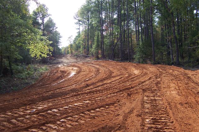

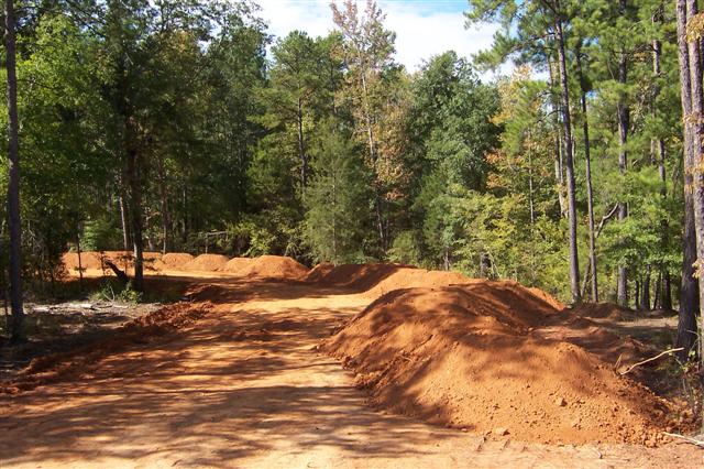

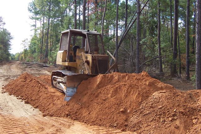

Here's a few more pics on the road project. The rains made it too muddy to move dirt with the dump truck for a few days, than I had a few good days, and now it's raining again. Yesterday the forecast was 100% for rain for last night and today. For once, they got it right!!!
I had about 40 loads all lined up and decided to smooth it out before it rained. Dirt piles are like a sponge when it rains. After a certain point, the dirt just absorbs all the water and it's impossible to work it. The only solution is to spread it out a bit, let it dry, and spread it some more. Not fun, and it takes months to get it dry enough to be usable.
The first pass is just to knock off the tops of the piles and start spreading the dirt a little. It takes allot of passes to get it where I want it. The ground slopes down quite a bit on one side because it was a drainage area, so it's taking twice as much dirt on one side than the other. It's impossible to get the dump truck into that area, so I build up my piles and spread with the dozer.
I'm leveling it by eye for now since I'm only rough grading it. I still have several more feet of fill to build it up, but I'm not wide enough all the way through yet either. The road needs to be 36 feet wide across the top when finished. I need to have two RV's be able to pass in oposite directions and room for people to walk along the side of them.
