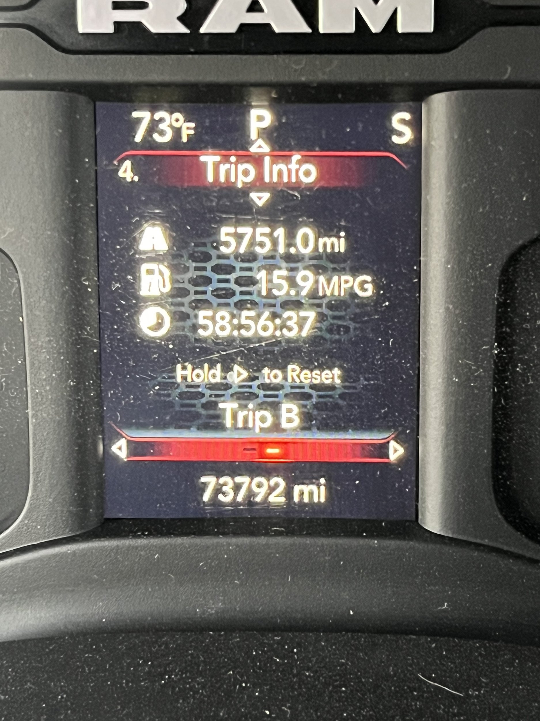

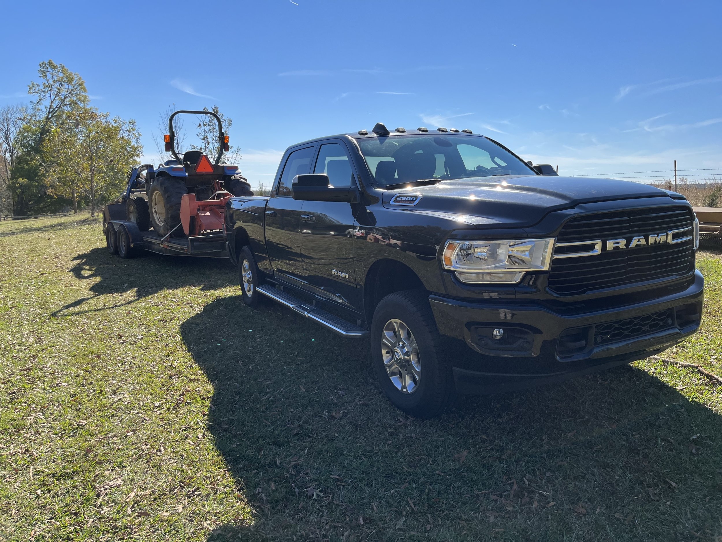

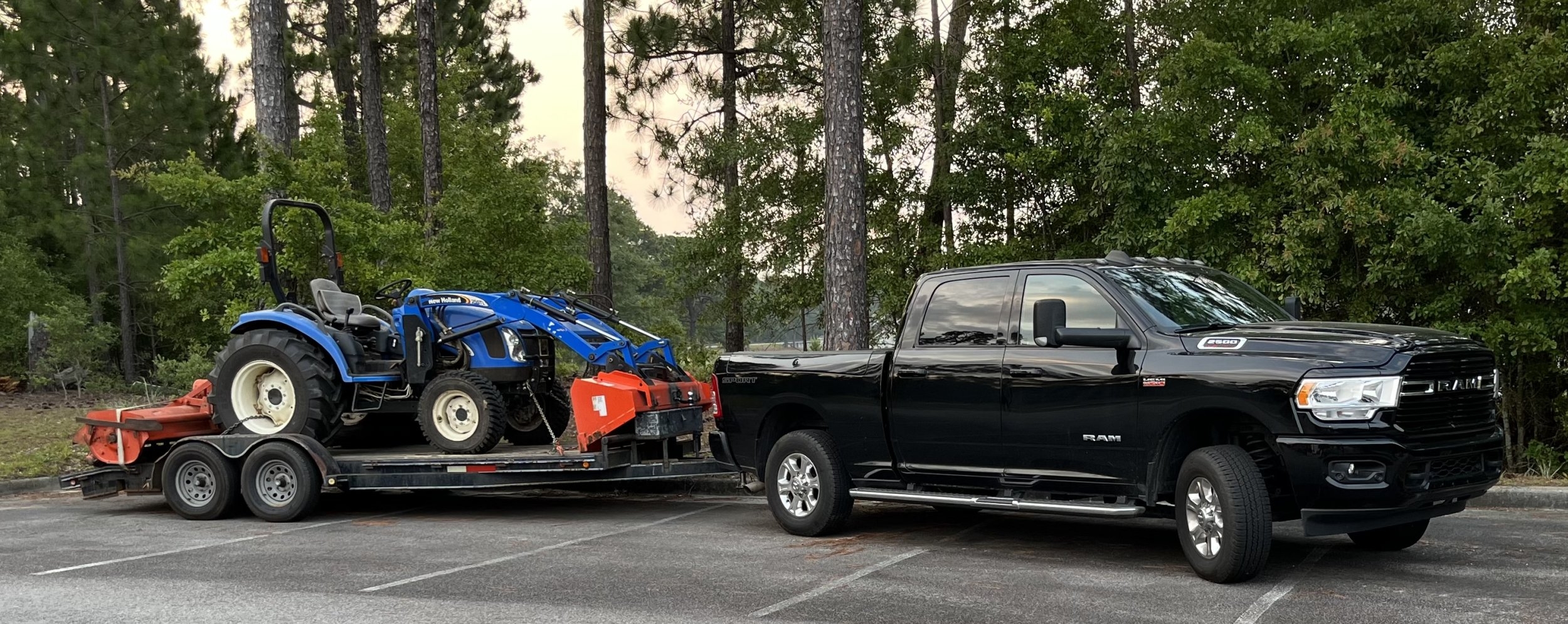

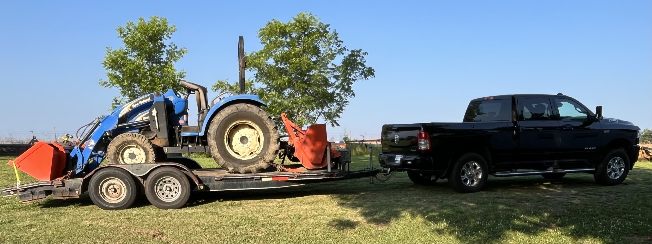

About 15 months ago I got a 2020 Ram 2500 with the 6.4 gas engine and 4.10 alex ratio with 63k miles on it. I like the truck and it tows good. I can’t speak to how it will do over the long term since it’s been just less than 10k miles that I’ve owned it.
The Ram 8 speed transmission is nice and I really enjoy it.
Over the last +5700 miles it’s averaged 15.9 MPG, but I hand calculated my MPG it is about .5 to .7 less than the computer shows. That 5700 miles includes multiple trailer towing trips (hay, tractor and camper trailer) and haul hay.
It’s a Bighorn with cloth seats, but it’s nice. In an another 9 years I‘ll know for sure if its a good truck.
One thing is Ram has a 10,000 lb limit on 2500 HD trucks gross, but I have 2800 pounds of payload.
The rear coil springs on the 2500 ride nice. Air rear springs are a factory option that replaces the coil springs.
It replaced my 2000 Chevy 2500 with the 6.0 and 3.73 gears and the Ram at 70 mpg gets better MPG than the Chevy at 60 mph.
