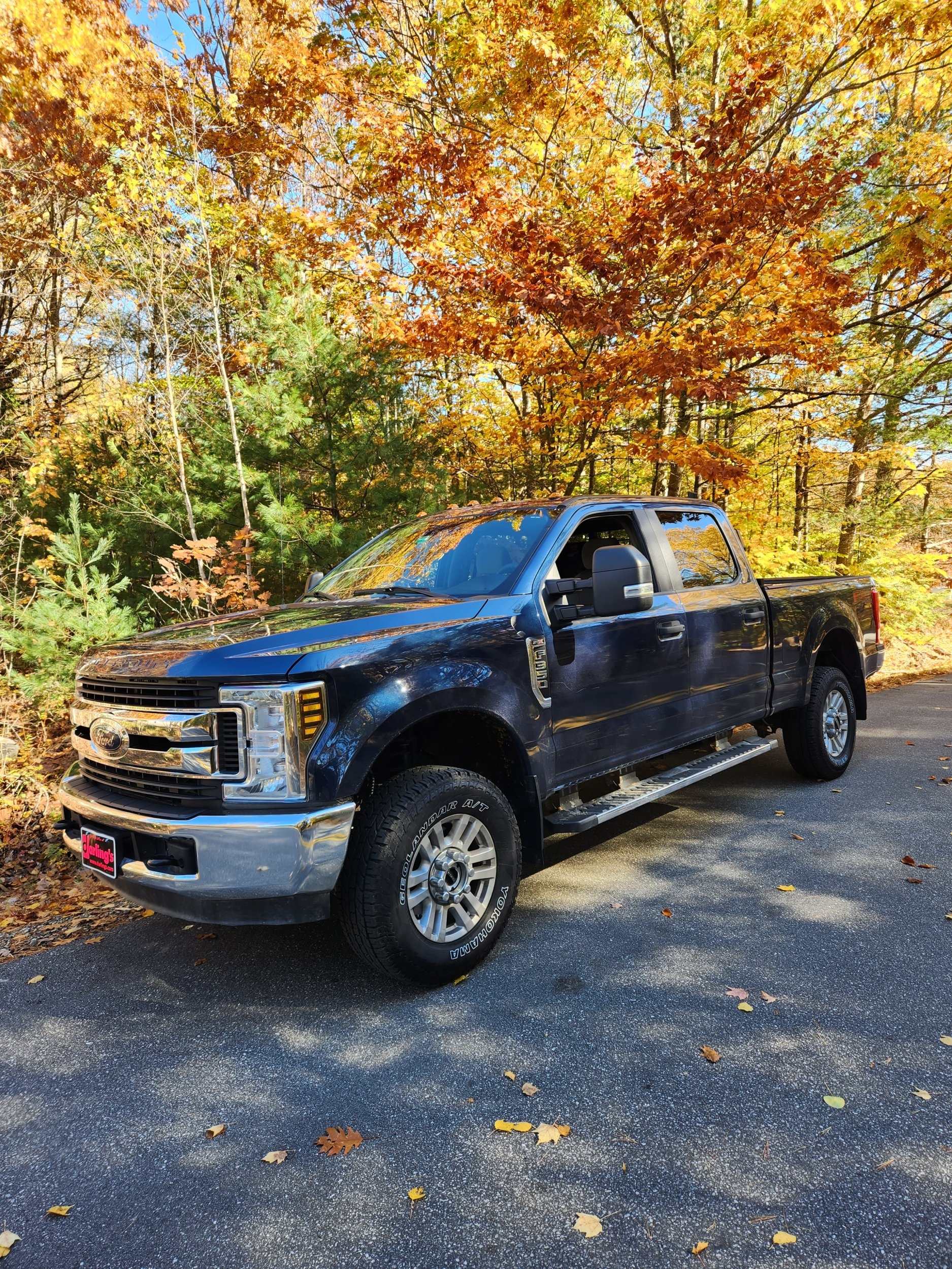

Around this time last year I totaled my RAM half-ton, a truck that I had spent months looking for. I wasn't about to find a replacement at an affordable price; well, not locally anyhow. So I just started watching for potential values, and just stumbled on my F350. I was on a Ford lot, jokingly looked at the truck, and the more I looked the more appealing it became. Then the kids fell for it; it's huge to them, like an overgrown Tonka truck. That was the final nail in my checkbooks coffin. 🤣
Anyhow, moving from a half-ton 2018 RAM 5.7 to a 2019 1 ton Ford 6.2 was just as I expected. I went from averaging 16-18 mpg in a truck that felt like it up and moved, to an 11 mpg slug that could pull my house over. I love it, and find it a blast to drive because it's ridiculous. This Super Duty reminds me of the old land barges I used to enjoy, but the truck is actually a better ride in every way.
