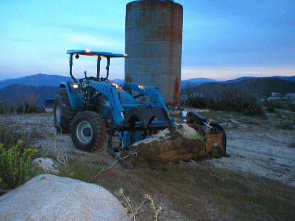

Well, I will agree that they will rust sometime, but they can be had where they are lined on the inside and I believe that those actually end up rusting from the outside and not the inside. If I remember correctly, the expected life time is very ,very long. My 10,500 gallon tank is made of 16 gauge corrugated metal and is very old. They don't build them like that anymore. But even it is coming to the end of it's life span.:(

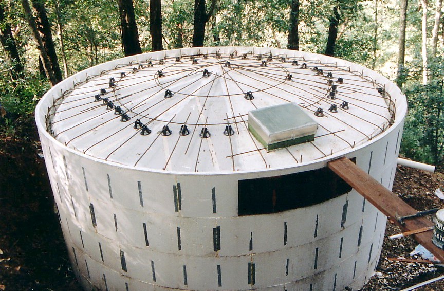

I think that doing something like you describe could work. You would have
to do something to hold the 2x4s in place. It is not obvious at all that the
plastic will buckle when you first cinch the straps down. The pressure is
spread over the length of the straps and the plastic does not seem like it
would buckle. If you can make sure the straps stay put just over the top
part and the bottom part of the tank, then maybe it would not buckle there.
As for the concrete tank, I did post about it and it has made the rounds on
an old ICF website. Here it is just before the pour. Floor, walls, and top
were poured monolithicly with about 7cy of concrete pumped thru 500' of
hose and an elevation of 150 feet. I did the structural design and
calculations, based on guidelines from an ACI paper on cylindrical concrete
tanks.
As for steel tanks, I talked to Salinas Tank, a Norcal manufr, and I used the
same asphaltic sealant they use on their tanks. Not all sealants are safe
for drinking water.
