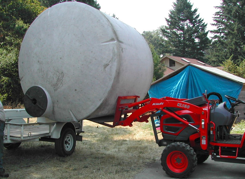

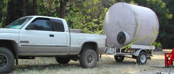

It seems that for those of us in the boonies, you can never have too many
water tanks. The plastic ones, made of cross-linked polyethylene (PEX) or
linear polyethylene, are the most economical, but how do you transport them?
When you buy them new, the seller delivers them and rolls them into position
on your pad or foundation. Not too difficult since a 2500 gallon unit may
weigh only 400#, plus or minus. But what if you buy one used and need to
pick it up? How do you lift these tanks up onto your pickup truck or trailer?
This one is a white PEX unit and is about 8 feet in diameter and a bit less
than 8' in height. (Most of them sold around here are black or dark green to
reduce algae growth.) Tipping it on its side and rolling it was easy for the
3 people used in this move....we had to go about 100 feet and around a
bunch of trees and other items. I then used my Kioti fiixed forklift to lift
the tank and roll it onto the trailer. It was quite a ballancing job as my forks
are only 36" and the back rest is maybe 30". I DID use a piece of plywood
on the fork tines to avoid puncturing the soft plastic with the forks.
When all loaded on the trailer, we strapped it down snug. In the 25 miles of
driving on curvy mountain roads, the straps had to be adjusted a few times
as they tended to collapse the plastic.

I was hoping the guy with the Dodge PU was going to get a flatbed trailer
with low deck so we could tip it up onto it. The tank could then be carried
upright. From our experience tipping it on its side, I know we would still
want help lifting it onto the back of the trailer. The forklift could have
provided that last little lift/push in that case.
This tank was shaded by trees; many other around here (usually black
in color) are not. I don't know how UV-tolerant they are, but the white
one needs to be painted IMO. If the manufacturer says keep it out of the
sun, you should. I would if I bought a new one for $1000!

I see that you only strapped vertically. Eek!
Yes, eek is right. If you saw the photos, you may have noticed when I strapped down at the yard there were only 2 yellow straps with red ones going over the yellow, but when I arrived at camp they were spread apart.. That is because like you said, eek, it started to slide backwards on the highway. I was very luck to notice a strap that was not taut in the rear view mirror so I pulled over. The tank had shifted back all the way against the tailgate ... I had not thought of placing it that way because I wanted to center the load ... wrong. I under estimated the wind force.
So once it was all the way against the tailgate, I spaced the (red) rope straps around it equally and it held very firm the rest of the way home. The best part about the story was making that giant tourniquet so we could position and turn the darn thing. It was BIG.
As far as Brian's question, I never priced a metal tank because my well guy told me to get the plastic one.
