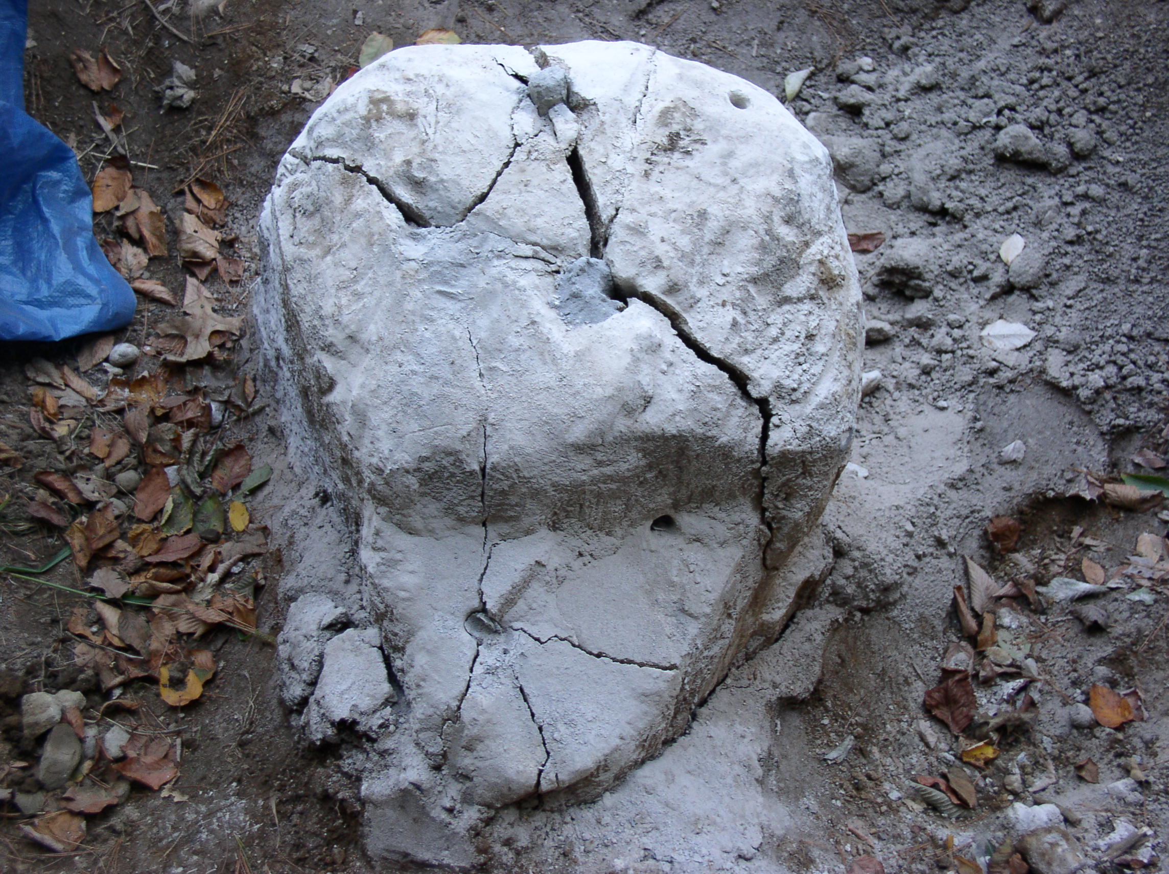

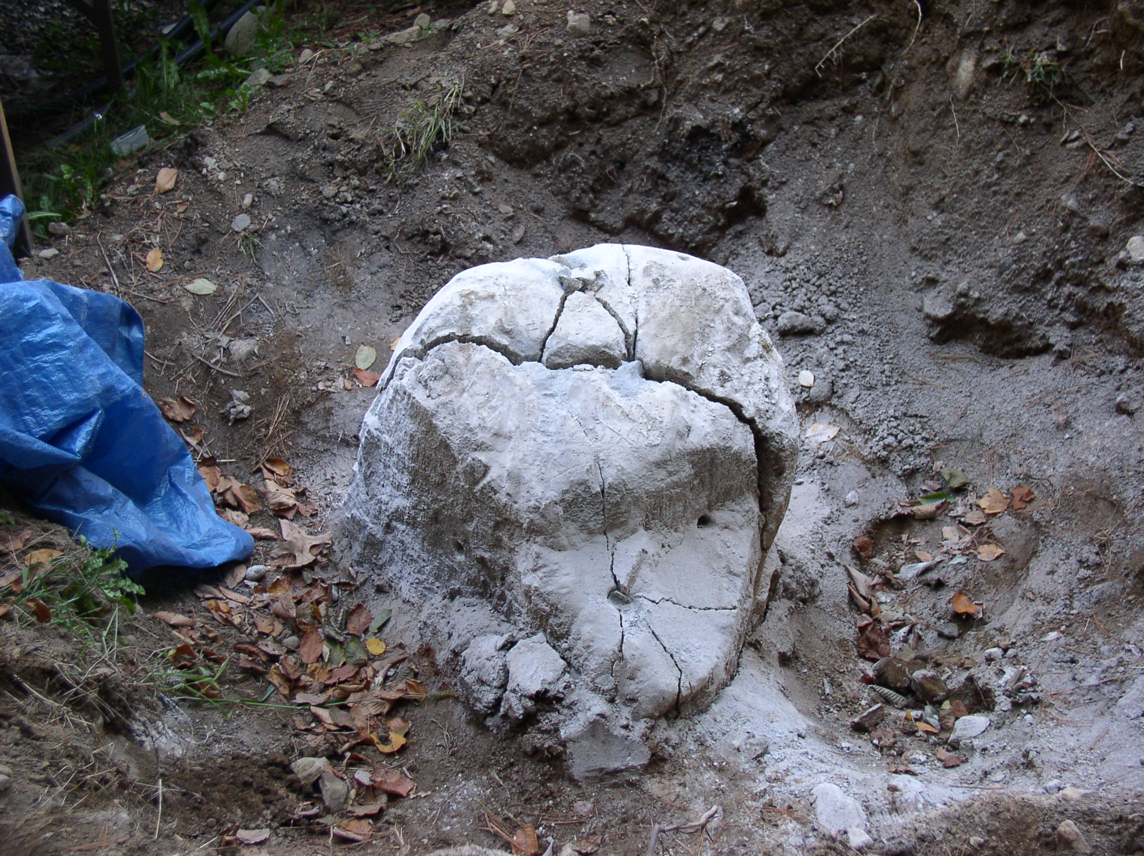

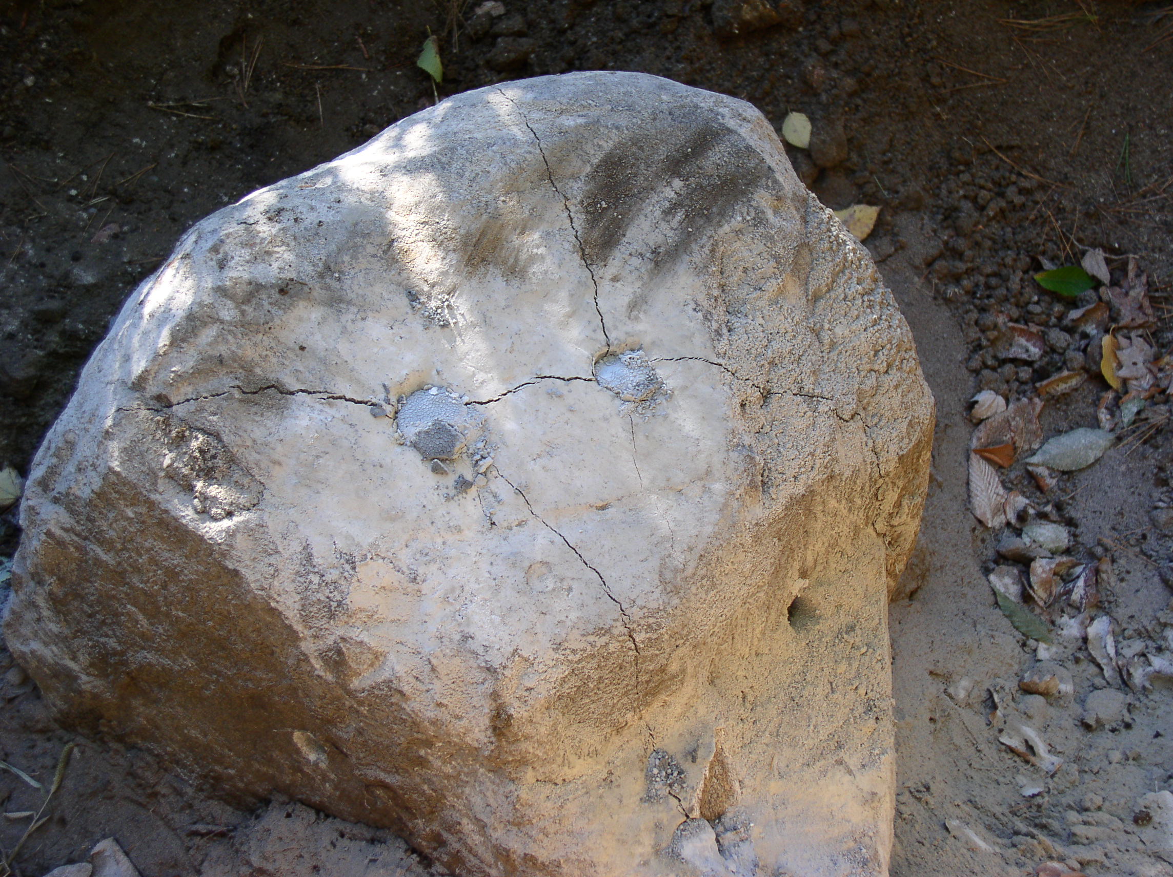

Joel,
I had the same problem last summer. What you need if Betonamit. You can get it at Taylor Rental in Concord. A 5 lb bag cost $60 and will handle most size jobs you have. Do not use a chuck drill. You will burn it out drilling into rock. You need a hammer drill, specifically a 1 1/2" drill bit. You can rent these also. The hammer drill will make life so much easier for you.
You drill 3 - 4 holes, mix the betonamit and pour in the holes. Cover the rock with a tarp and leave over night. In the morning the rock will be split in half or however you set your series of drilled holes. A friend used this when making his water fall, & I had to use it when I decided to dig up this "little rock" in the lawn. It ended up being 3 1/2 feet wide by 7 feet tall stading on end. I couldn't budge it with the backhoe. After splitting it I pulled out the top half and burried the bottom half. If I can dig out the pictures of it, I'll post them for you.

Ductape & Joel
As promised, here are the some of the pics on the rock splitting. Also, I meant a Rotary Hammer Drill.
/ Moving Really Big Rocks #19
Lets try that again,....
