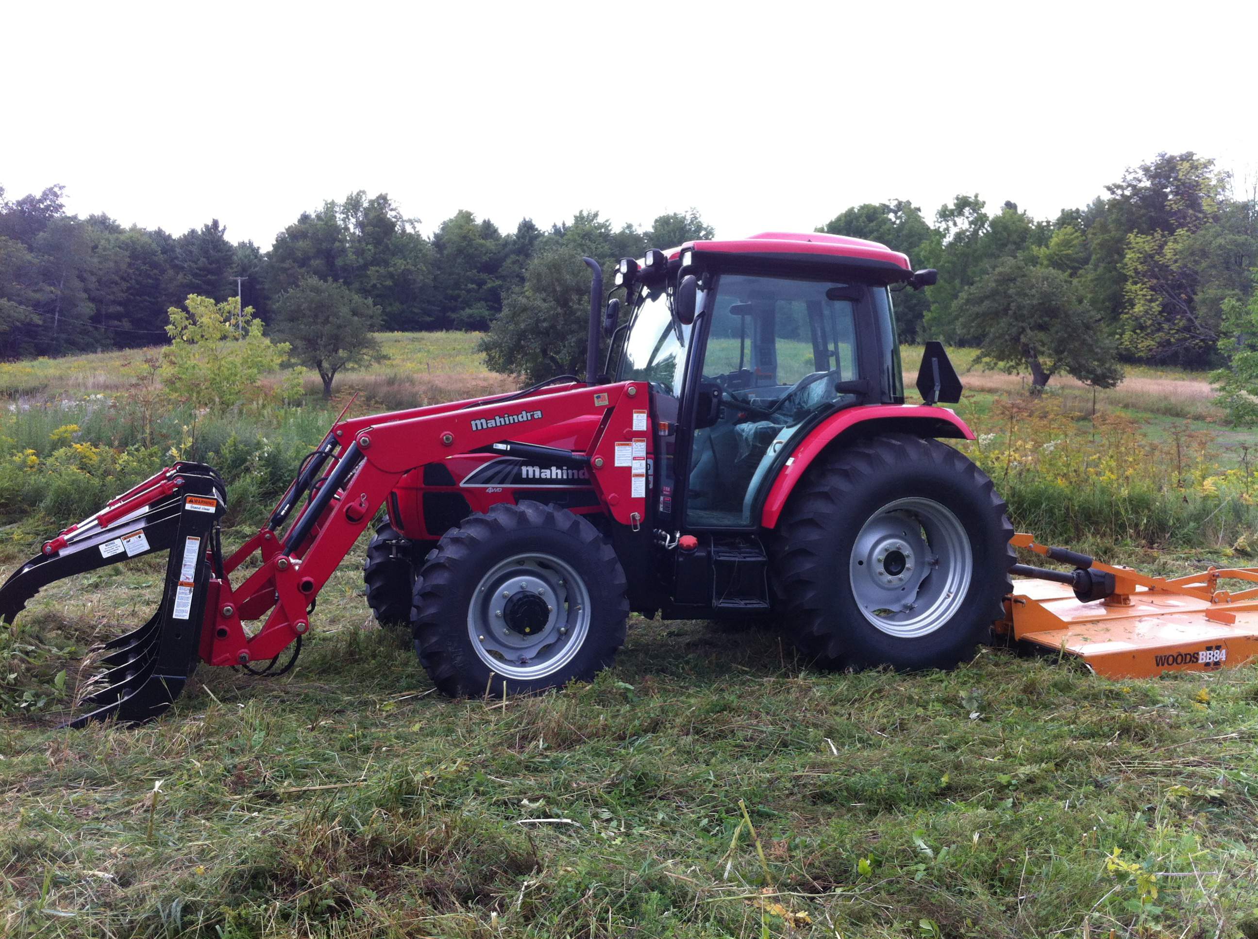

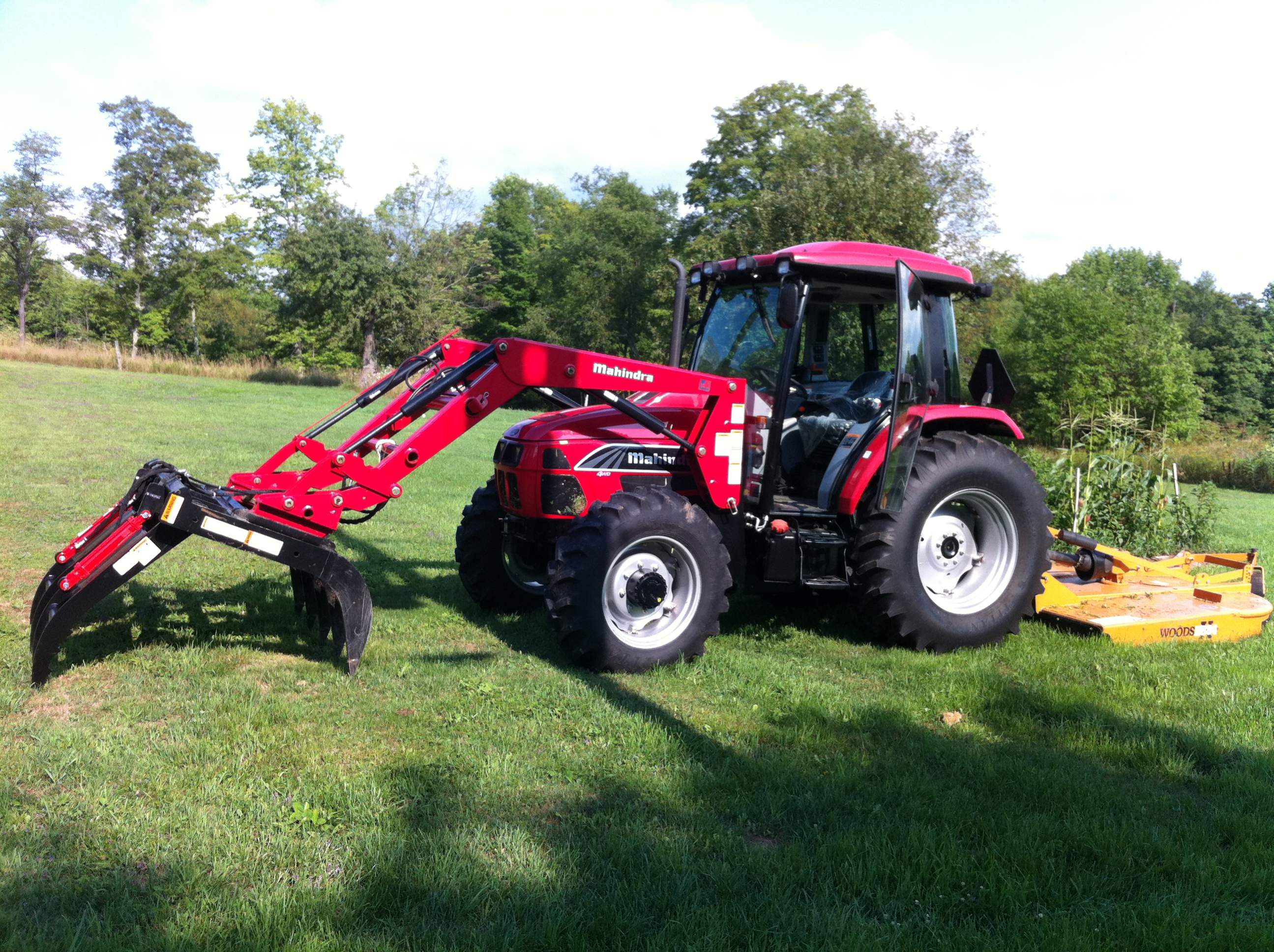

10.jpg13.jpgThanks for the input guys. I don't know how far down these rocks go as they all seem to be piled up from fields that were once planted. I do have a mini excavator that could certainly tear the walls apart allowing me to just scoop the scattered rocks with the bucket. Before I drag the mini 150 miles to this house from it's current location I'm going to try using the grapple to tear the walls down. I'm not going to drive into the walls but rather use the scooping motion of the grapple to see if I can push the wall apart. In other words..appraoch the rock pile with the grapple in the position seen in the first picture and then rertact the hydraulics to put the grapple in the position seen in the second picture. I don't think those hydraulic rams are strong enough to bend anything on that grapple and I would simply push the rocks off the pile. The next step would be to use the bucket to scoop up the mess and relocate.
