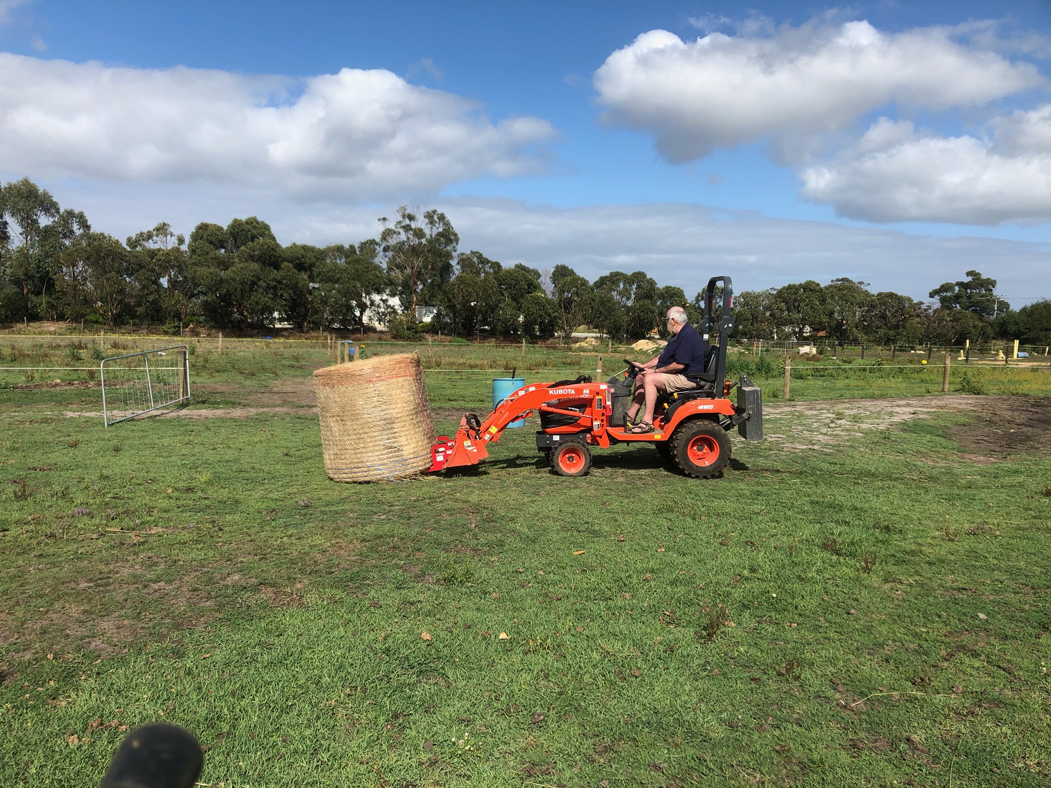

It can be done!!
With the forks on the bucket I can get under the bale and tilt back slightly, the forks then act like a sled across the paddocks, 4WD is a must as the back wheels come up sometimes but overall low and slow gets us there without incident, apart from being harassed by hungry horses.

Is that the smallest tractor made along with the tiniest round bale ever baled?

The 18 is smaller, we have a hay shed full of round bales about 4' instead of the standard 5', stacked 3 high we push them of, tip them over with the forks then slide them out, they weigh about 300kg plus the 4 in 1 bucket and the forks, it doesn't struggle and is the only way I can get them out rather than rolling them, we take the wraqp off when it arrives and put a feed net over them so the horses don't destroy and scatter it everywhere.

And if you had forks directly attached to the FEL instead of hanging off your bucket, you would have a heck lot more of lift!

True.
And I'd lower the counterweight on the 3PH to mid so that it hangs out a wee bit more.

I use the forks to move pallets around with bits and pieces as well as 1000 litre water tanks (empty), they cost about $200, I cannot justify a set of dedicated forks.
We have just sold our property and will be buying a bigger tractor when we move but that is another can of worms as I have no idea what to get as yet but it will need to be able to lift round bales, full size to store them when we cut hay.

Kind of wonder about front axle stresses from overloading like that

Having ""adequate counterweight on 3 pt hitch"" greatly reduces stress & wear on frt axle when handling heavy loads with frt end loader.

We are pretty flat except for a few drains which I avoid, as stated it is being 'slid' around so unlikely that it is going to tip.
The BX also has a very low centre of gravity but I am not one to take chances and risk injury to myself or my wallet by tipping it over.
The forks get used a lot for moving fence posts around, not heavy but too long to fit in the bucket, also pallets of bits and pieces that need moving from place to place and left for a while, once again not heavy but beats using a wheelbarrow.

Make sure your tires are inflated to the point where they’re not having the sidewalks squishing out. When the sidewalls bulge out a lot, it can damage the inside of the tire. Tire will look fine. You won’t know it until it blows out.

They are not but thanks for the insight, I'm using industrials (R4?)

First thing I learned... slow and low. Don't be in a hurry, that's usually when **** happens.
