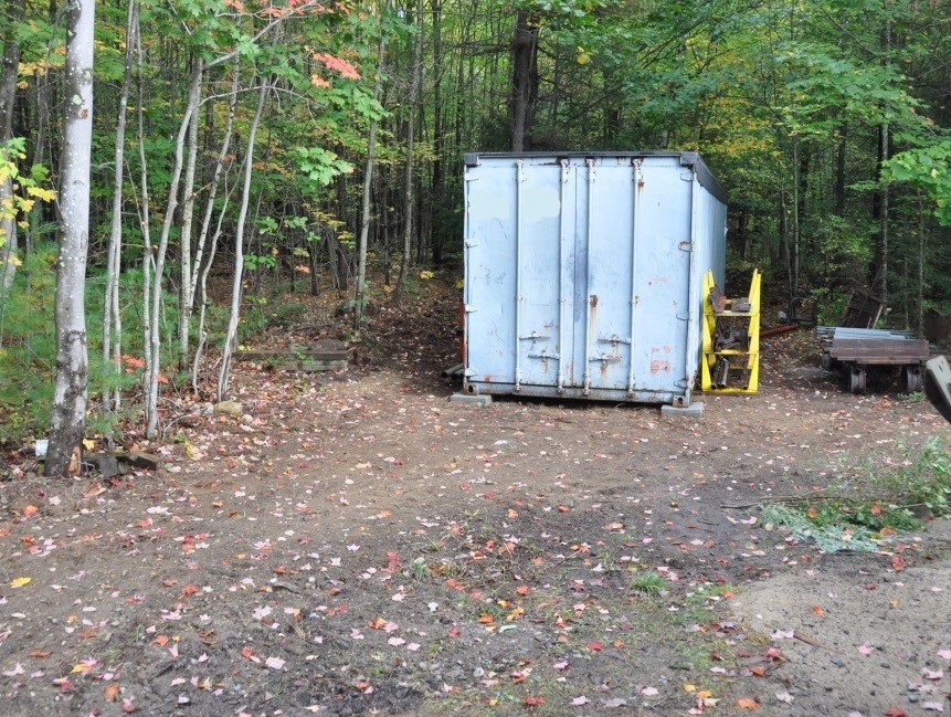

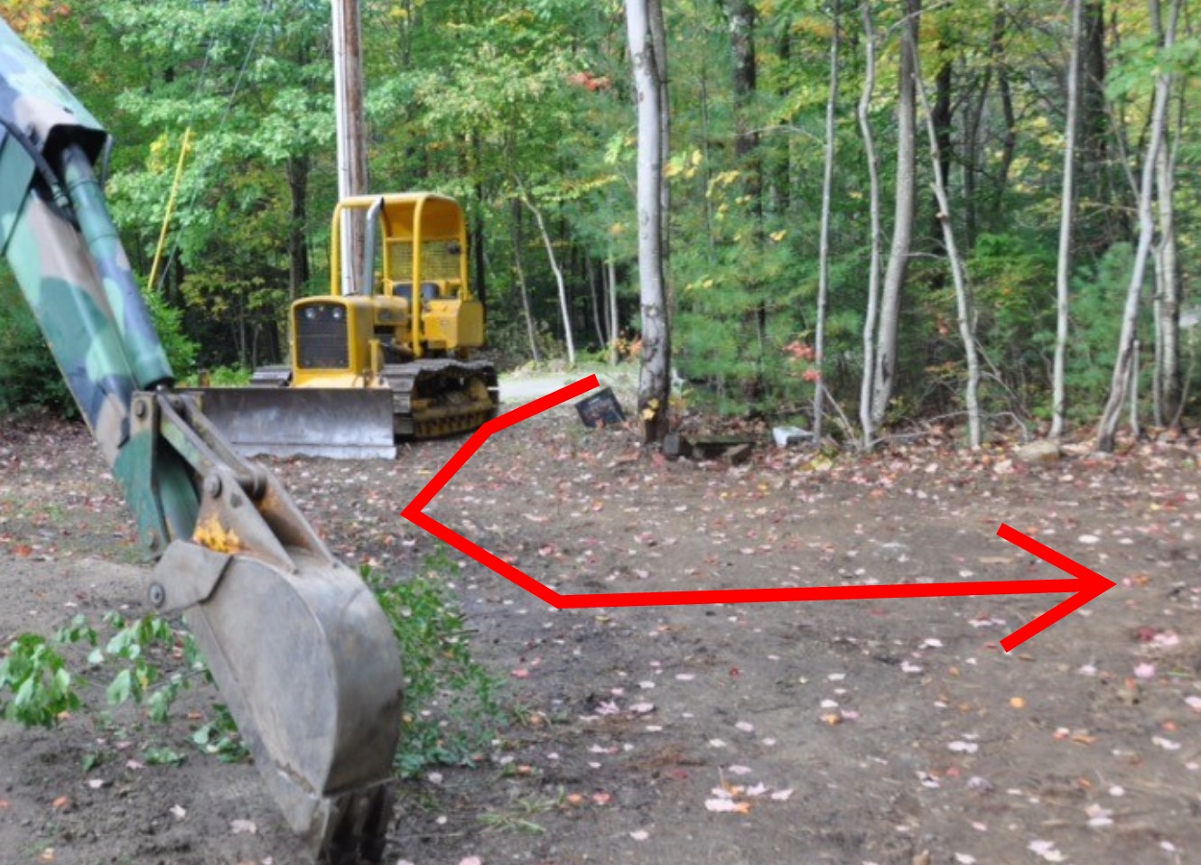

I have a 40' standard height (not the high cube) container and it is probably every bit of 9k lbs. I had to get it moved from where I got it to my place and hired a towing company with a 40' 50 ton Landoll. He winched it onto the trailer and was able to get it to my place but the last 50' I had to go with it I needed to make a 90 degree turn and then drag it into place. The spot was too tight for him to be able to back it in there. When he was sliding it off I had set it on wood 4x6's to give it more of a point load to slide it on. Pipes or other steel would have made it slide easier but there is NO WAY I could have just dragged it across the dirt. I worked my JD 350C dozer hard to get the container dragged into place and at one point even needed help from our 580CK backhoe to help pull it along (I was in loose but dry dirt). The JD 350C is about 10k lbs and has brand new tracks with aggressive grousers. With the container empty my 350C can barely pick up one end of it. Your 550J is about 18k lbs (and 28 years newer) so it should be a bit easier for you to maneuver it.
In the first picture, the container was dropped off right where my dozer is parked with one end of the container about 10' closer to the camera than where the front blade is sitting. I had to drag it around that corner like the arrow shows.

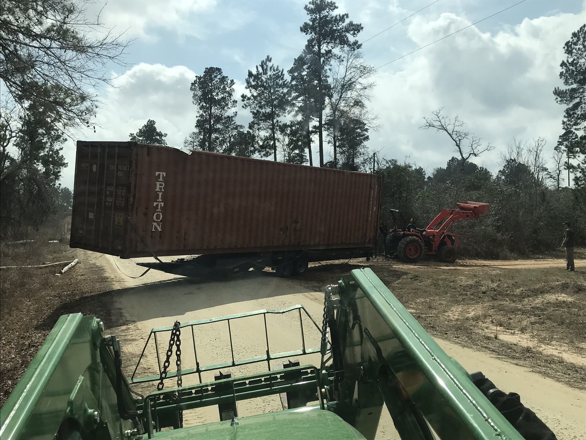

I sold our 40 HC to a buddy across the street. We hauled it on his 20+5 Trailer. Was a mess but worked. My 100 hp Deere lifted it enough we could back the trailer under it. There痴 way to move them but they are a pain. You have the equipment and knowledge for sure. We didn稚 have any issues with door alignment. It痴 been moved 3 times since I had it

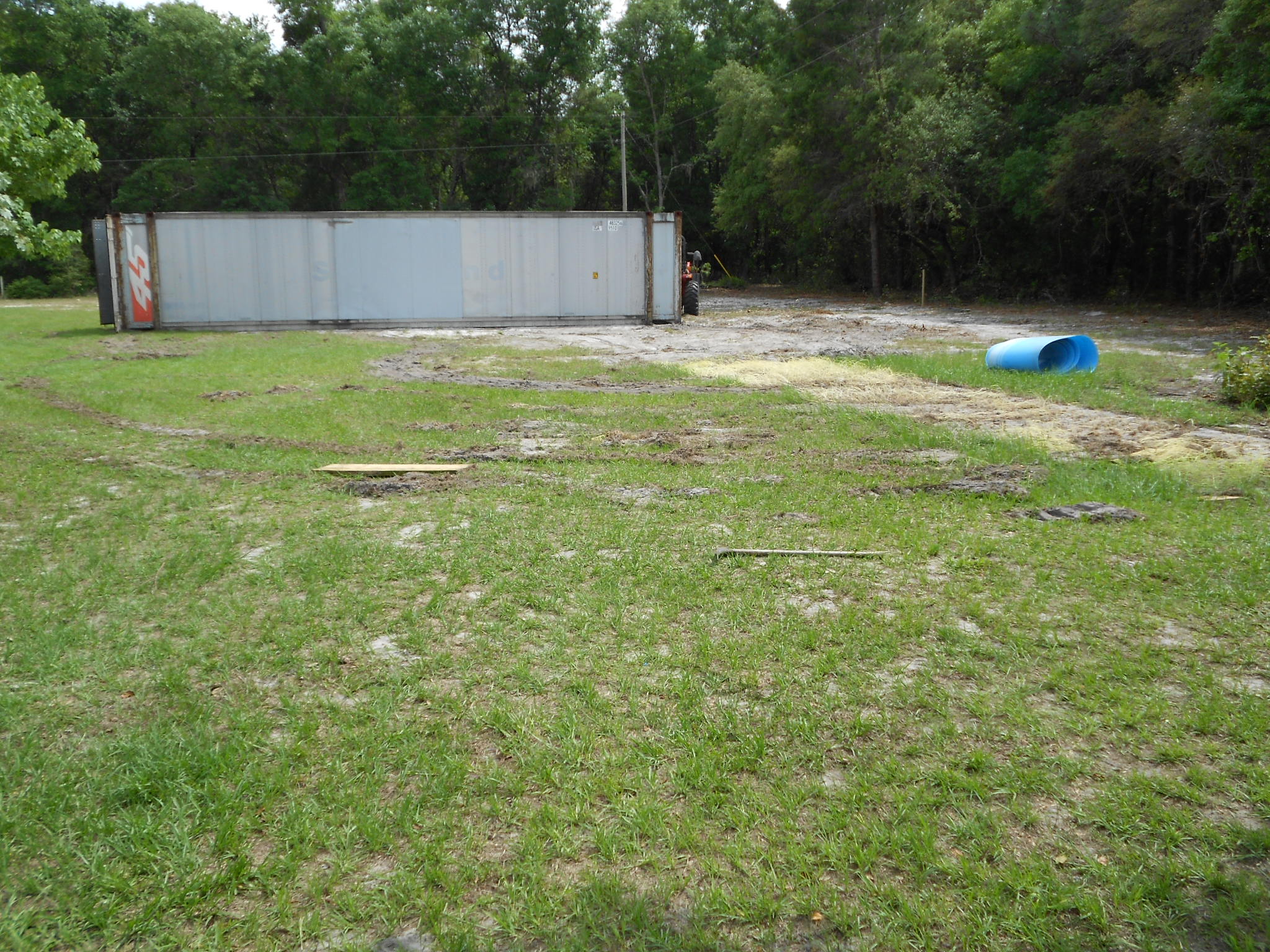

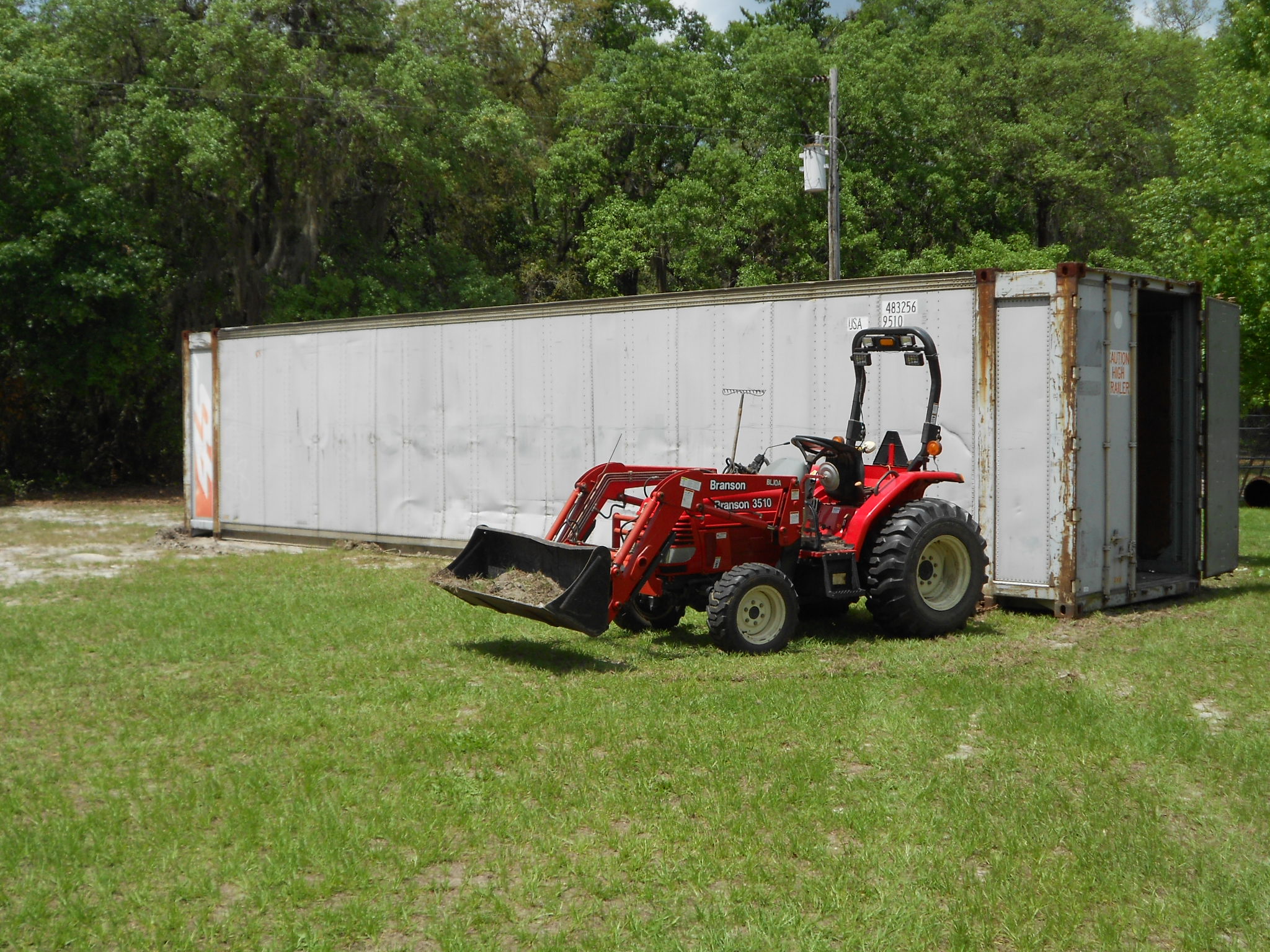

I used to repair containers, move them with a stacker/packer and pick up and deliver with a 48' Landoll and KW Semi.
Used to own a 20'er and now a 45'.
I had my 45'er grounded and then later needed to move it so I could put up a 40' X 60' red iron building.
I hooked my 3 pt onto one pocket at a time with my 3510 Branson and lifted it, sort of and dragged it.
It wasn't easy but I got it done.
20'ers are in the 5000 lb range and 40-45-48'ers are in the 10,000 lb range.
You can jack them at all 4 corners under the pockets to level and square up the doors to work properly.
Second pic you can see how far I moved it and turned it 90*.

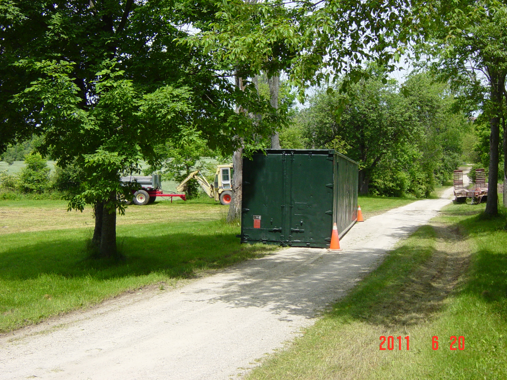

Each of my loaders can lift one end of this forty footer, but we basically just dragged it 500 feet to it's new location. They are quite robust. The excavator surprisingly couldn't lift it, but I think he had cylinder seal issues.
Pushing it in among trees was a harder, slower process.
