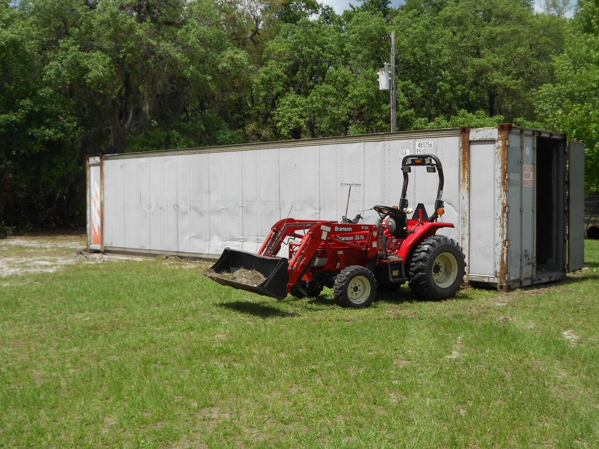

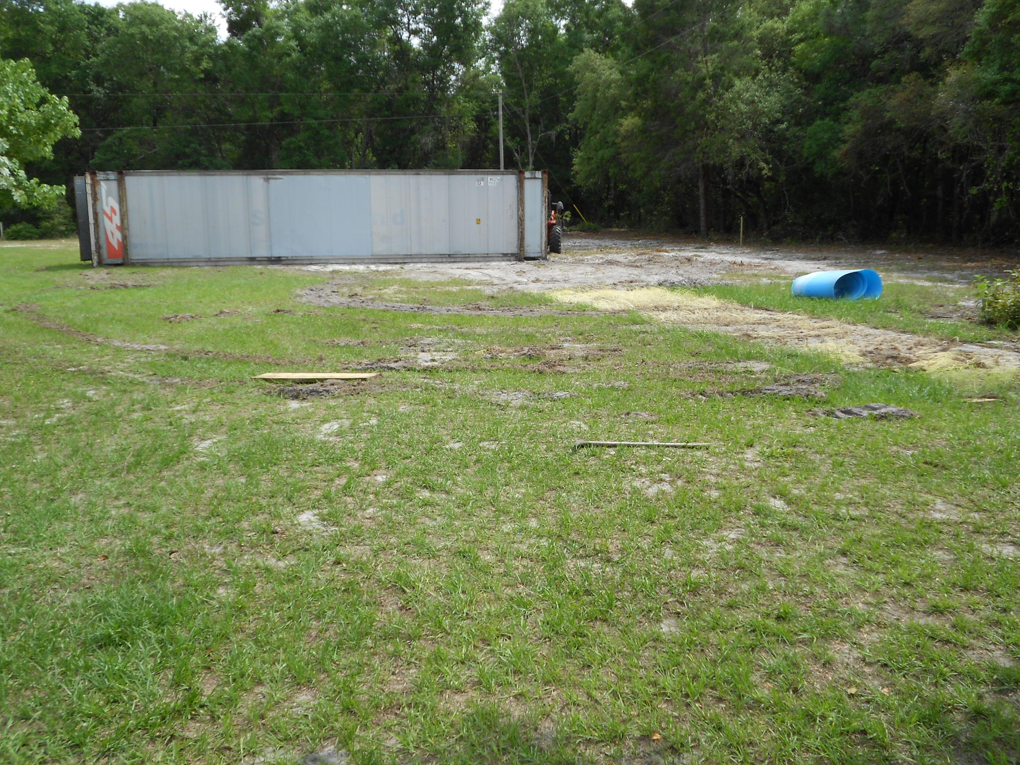

I used pine logs and my tractor W/FEL to move the container to its final location. Lifted up a corner added a log pulled it 8 or 10 feet added another log and so on. I did not want to skid it because I had a number of pine stumps an inch or so above grade that would hang it up. Once in the final position I used a 3 ton hydraulic jack and various size pieces of 12"x 12" x 2" and 4" thick concrete and pressure treated 3/4" plywood to level it at about a foot of clearance between the rails and the ground.
