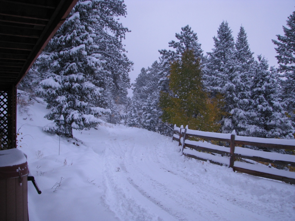

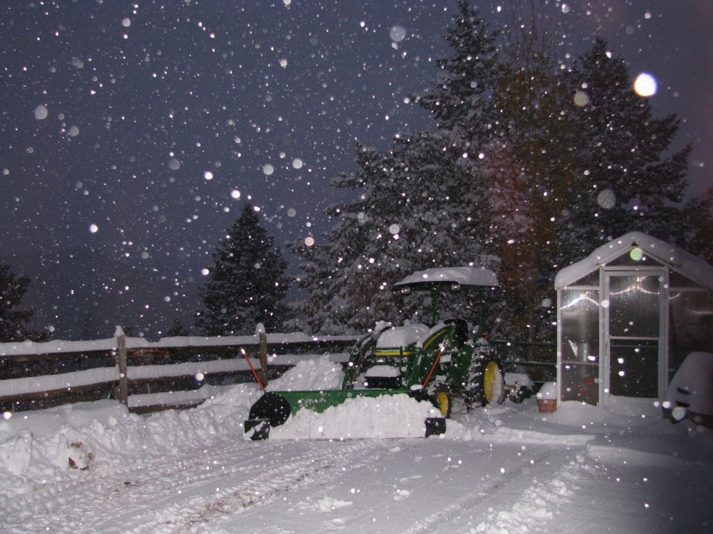

My best advice is to get a snowblower, and not a plow if you have significant, long lasting snow like I do. It usually starts in mid November and doesn't stop until mid April. The first picture below was taken on April 11th of this year and the second, a day later after two snow storms on consecutive days:
Throwing snow avoids all of the drama associated with pushing snow. You won't ever have to move it a second time. I could not fathom how much time it would have taken to move the snow in the second picture with a FEL (5 feet of wet, heavy, dense snow). Actually the second area would have to have been plowed all along and the grass below it would have been dead most of the spring.
You won't get ticketing for pushing it into the roadway as happens up here, or get sued by the county if your pushed snow in the roadway causes damage to a county plow truck.

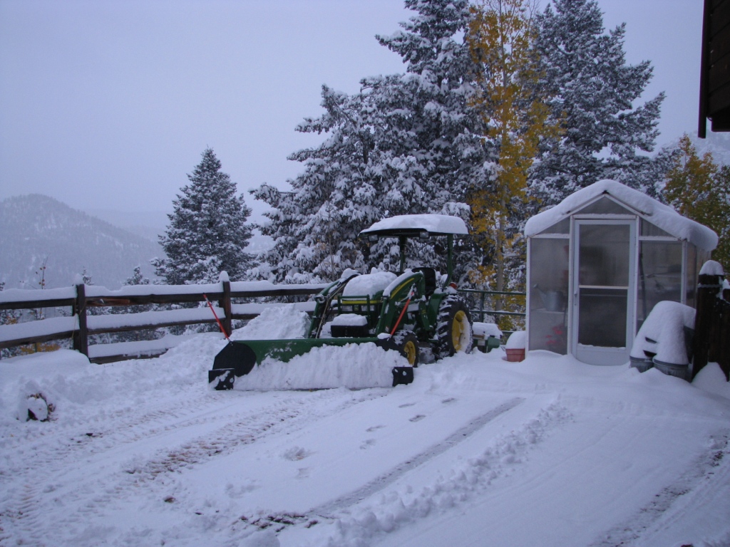

I have a FEL mounted blade that works very well for me. Plowed 10" yesterday. Never needed chains on my R1's but don't know about R4's.

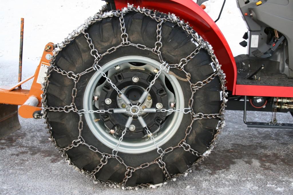

I have a long gravel driveway on a fairly steep hill. Without chains on my R4's, I could not make it up my road with the slightest dusting of snow cover.
Those are serious chains.:D
