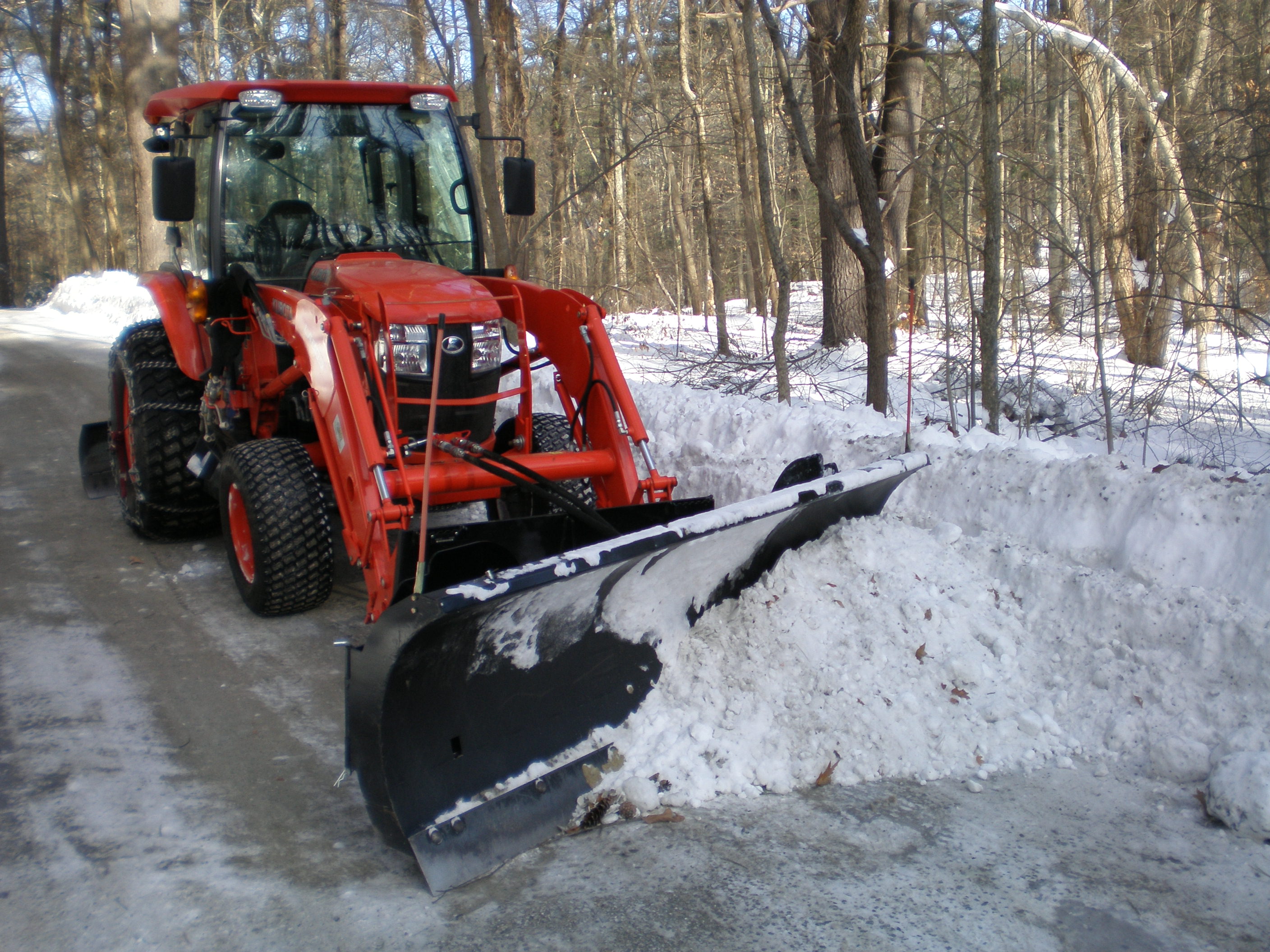

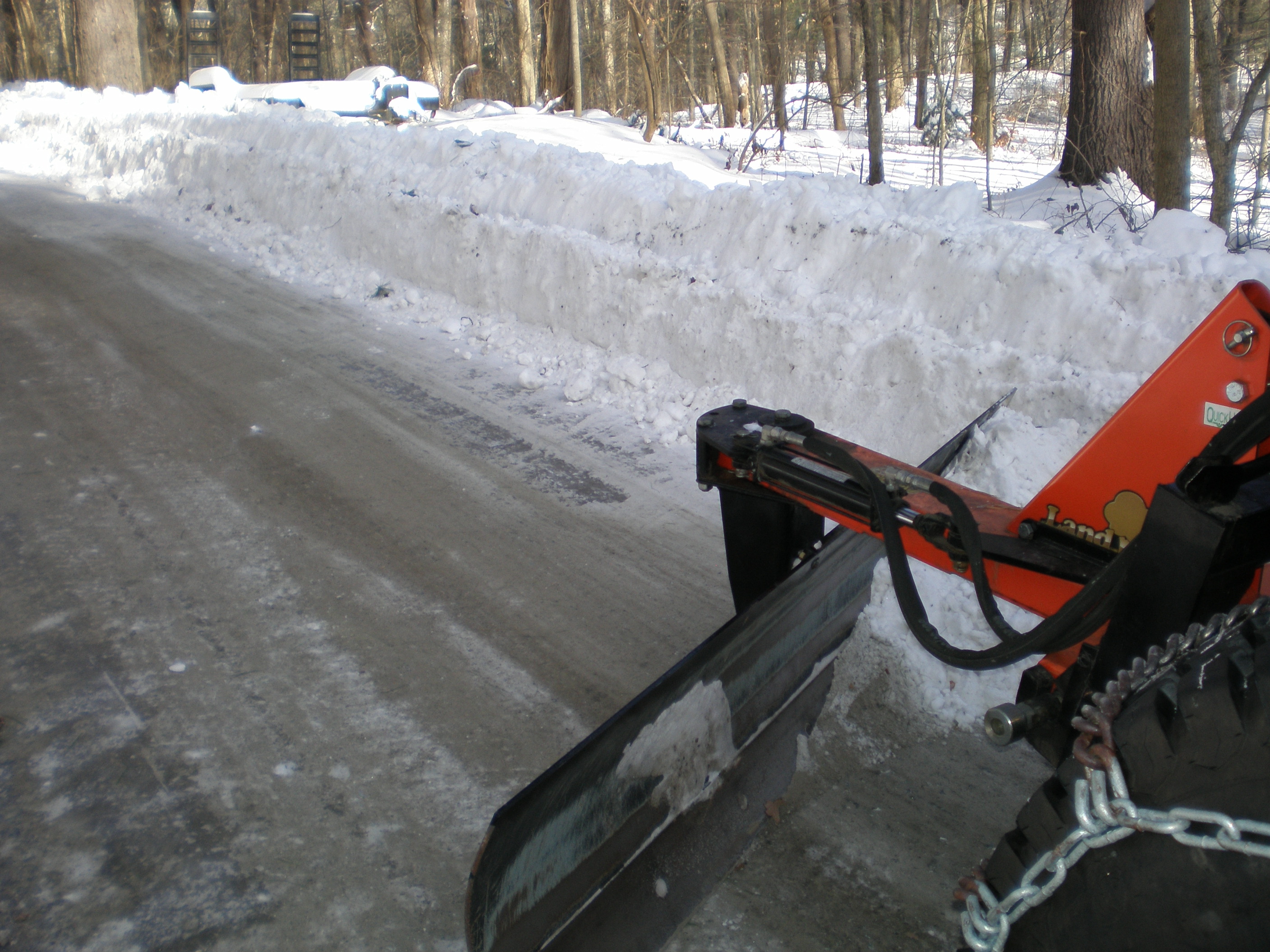

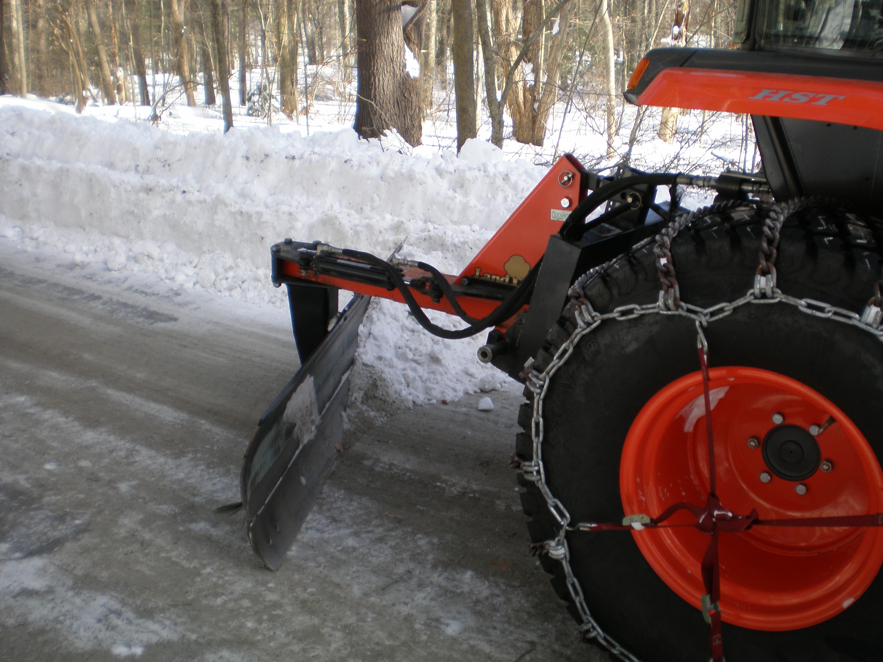

Front plow rear blade here. I use them at the same time. I also plow a couple streets, courts and entrance to a subdivision.
A front bucket would be a major pain with spill over. However, if you did say a small driveway or needed to relocate the snow as appose to just pushing it to the side, a bucket would be fine.

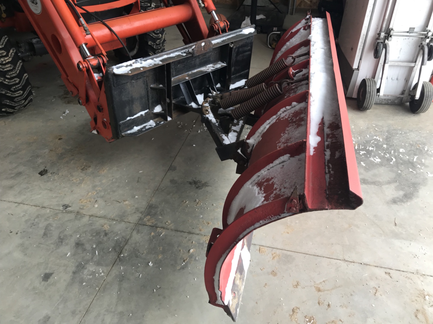

Also know, a front plow has trip springs for when it makes contact with a hard object: a bucket is a hard impact and there will be a loser. Wether it be the tractor side, the object or curb you hit or both.
