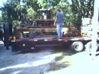

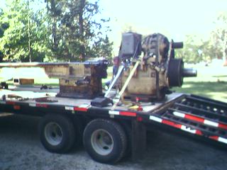

You have been given several good ideas and the two best are Pour concrete first and hire someone to move it. We moved a 27 x 96 American lathe a couple of years ago and learned a lot. We took the gear head off the bed and the tail stock off. The head alone is the size of a diesel engine and the tail stock weighed at least 500lb. Just getting the head on the trailer we almost upset a carry deck crane. To load the bed we paid a guy from a septic tank company to bring his wheel loader with forks to finish loading the bed. We learned enough loading that we knew we needed more than we had at the shop. We hired another guy with a larger cat loader with forks to unload the lathe bed first then set the head on the bed. You need concrete under the machine so you can level it and keep it from falling over. A couple of gantry cranes would help move it around. In your case I think I would hire a rigging contractor with a heavy duty fork lift to set it where you want it. They should be insured so it they do drop it you are covered. We have used a roll back to move other machine tools. A good operator can set the machine pretty close to where you want it. I can give you a number for a guy in Sullivan IL. that we use to move machines. He has the equipment and expirence. LeBlond makes some sweet running lathes. It should give you years of service.
