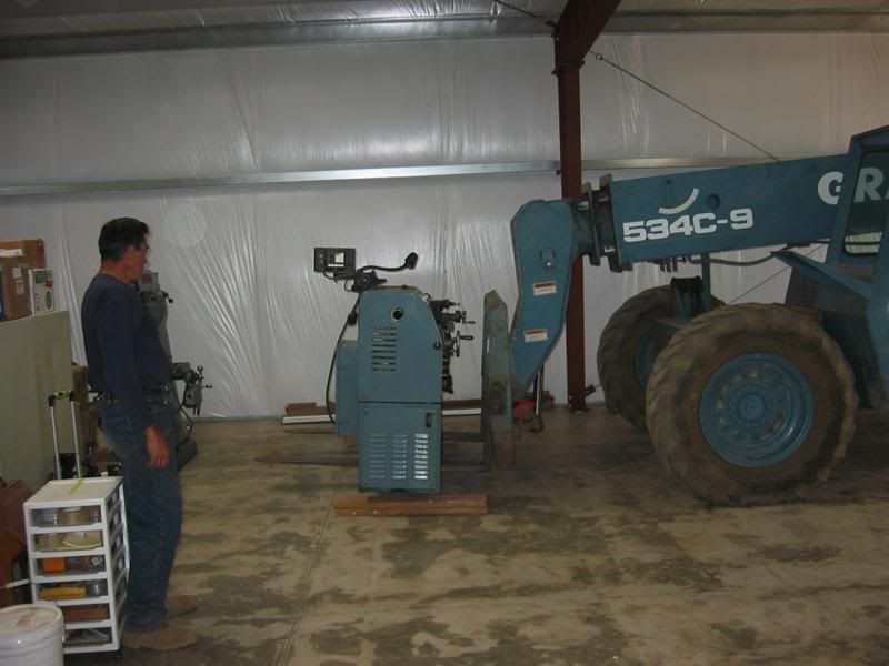

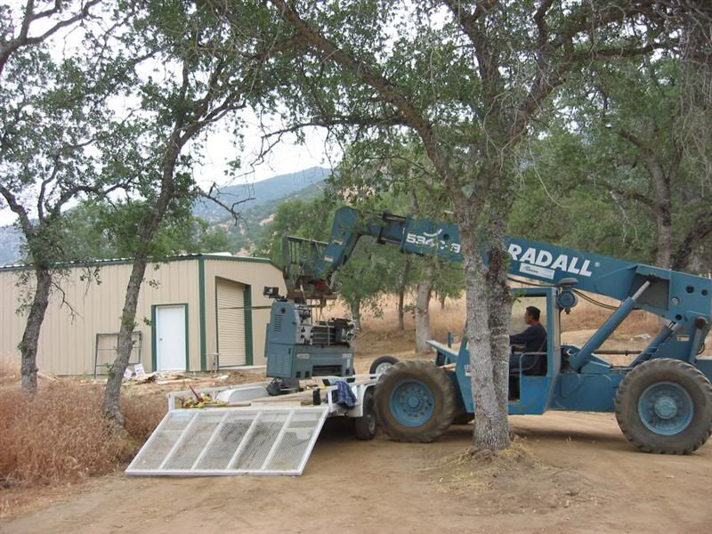

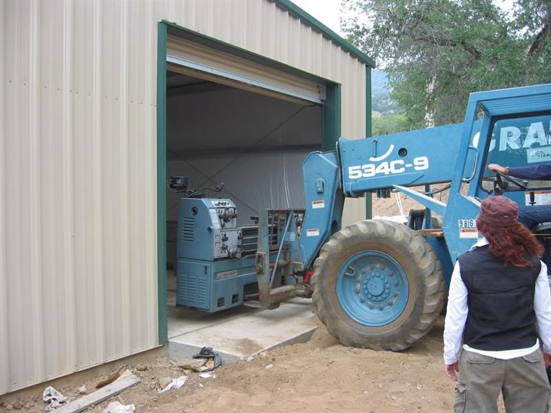

Steve,
I just got through moving my big lathe to my new barn/shop. In fact I moved all my machinery.
I was lucky, I have a fork lift at my Rancho home and loaded the lathe on the trailer myself. It was all it could handle. I took the lathe up to the property and lucky for me, the construction guys still had their Gradeall there. I borrowed it to get the lathe off the trailer because everything is dirt. I used the Gradeall to place the lathe into the barn. But my barn has a 6" to 8" concrete floor. The next week I took the fork lift up on the trailer. It was all it could handle too. When I unloaded the fork lift at the property, into the barn, I used it to place my lathe. My 5,000lb capacity fork lift barley lifts the lathe. It's wheels are too small for dirt or gravel and sink in.
My suggestion is to concrete your work shop first or you will be pulling your hair.
Not just now but later too. First, your lathe needs a super good concrete floor so you can level it and it will remain steady and stable under load as it's used. I've seen pits dug out for much larger machinery so the floor under some was like 3 feet thick just so the machine could remain steady, stable and repeat. Second is that once you have the concrete floor in, your options for moving it will be multi-fold. And in case you don't choose the right spot the first time, you can move it again. I've used pipe and a good pry bar many times to move machinery by myself. Not easy but surely about a hundred times better than trying it on gravel.
You could try the plywood thing but I'm telling you I drove my forklift onto 3/4" plywood over dirt.
The fork lift weight alone caused the front tires to go right through it. I couldn't believe it. Even loading it onto the trailer I put another 3/4" sheet of plywood down which supported the tires. I drove it off the trailer and onto a naked 2 x 6 and cracked it. Now add a 5 or 6 thousand pound lathe onto that forklift and you could have a problem.
Just my 2 cents...
Rob-

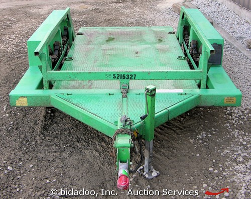

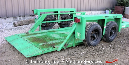

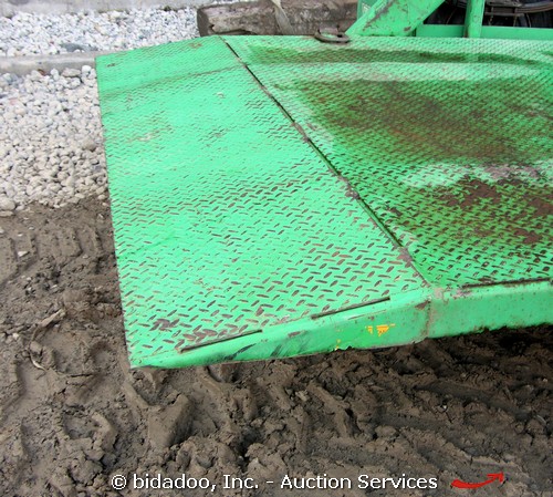

If you had the spare change and lived near Seattle this little rig would work for you. The bid right now is $3100 at a place called Bidadoo auctions.Bed Length: 12'
Bed Width: 6
Hitch: 2-5/16" ball, coupler type
Adjustable tongue height
G.V.W.R.: 9,690 lbs
Curb Weight: 2,700 lbs
Payload/Capacity: 7,000 lbs
Hydraulic lift Bed
D-Rings: 6
Tires: 8-14.5 good condition
Tandem Axel
Suspension: leaf spring
Wiring: 4-way; end is cut not functional
Color: Green
Onboard Battery Charger
Quad electric drum brakes
