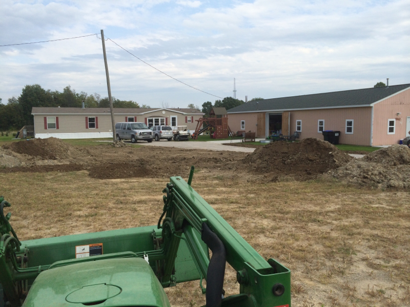

Hay bales and dirt moving. The guy who bales my hay came today and left me 16 bales of hay. I was able to get it under tarp before it started raining. I also was able to spread some dirt.
