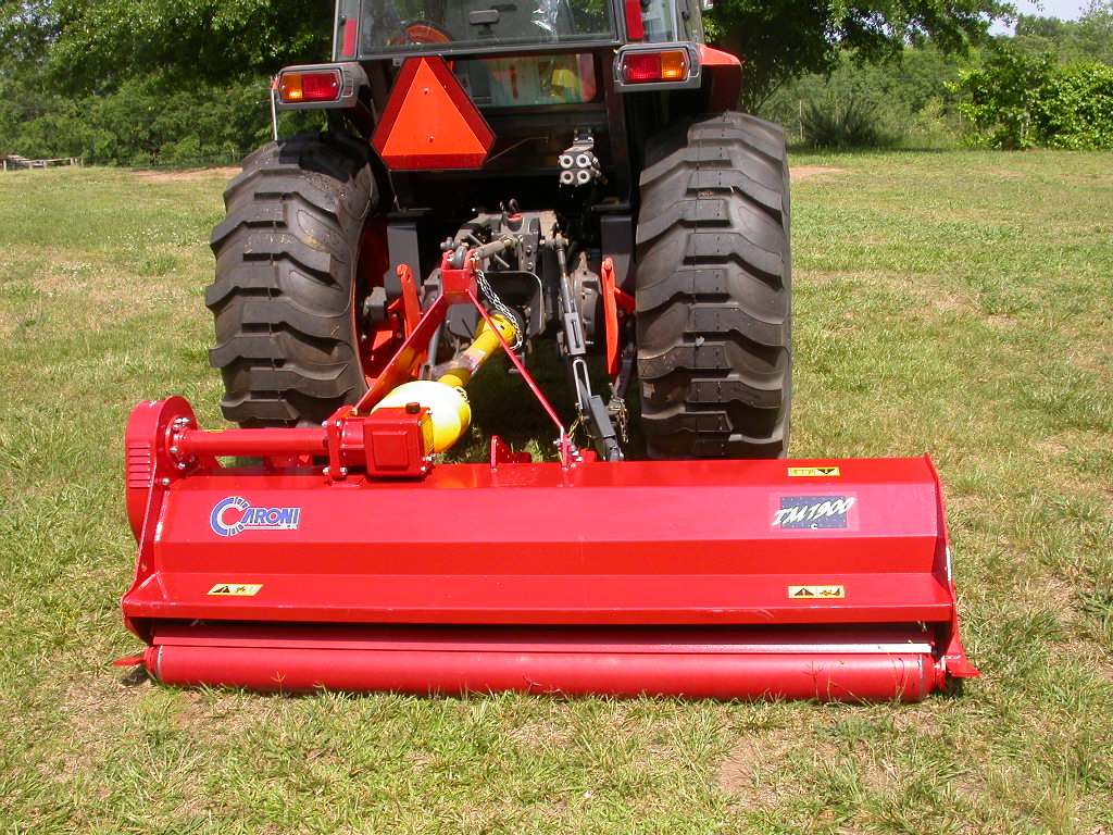

I hear this all of the time, however I have never seen a flail mower in use. Along our highways, I see batwing cutters everywhere.
My dad has a new 6' wide Caroni TM1900 flail mower. It's awesome. $1,800 from AgriSupply. Mows almost as smooth as a finish mower, has the rotary-cutter benefit that the blades are on shackles, yet they rotate vertically & extremely rarely throw anything out away from the tractor. And, the right side extends from the tractor by either ~ a foot or ~1.5 feet (your choice; it's adjustable). I don't sell them, just a big fan. :thumbsup:
attachment.php
If I hadn't just spent lots of $$$$$$$$ on new mowers, I would have seriously considered getting one and probably will someday in the future.
