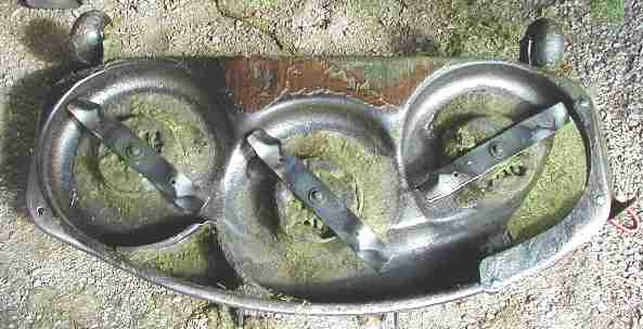

I've mowed with mine for about 10 hours now after brushing on a thick coat of slip-plate. I have mowed the grass dry, wet, and tall and have just hand-cleared the build-up (mower off) by reaching under.
I took the deck off the other day and this picture shows the result. The shiny areas are where the slip plate has totally worn away back down to bare metal.
As others have said, an occasional re-coat is necessary but all-in-all I'm pleased with the result.
