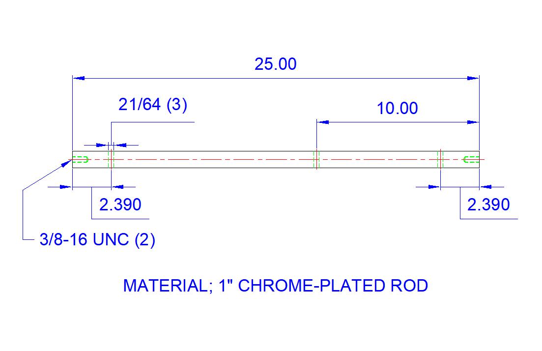

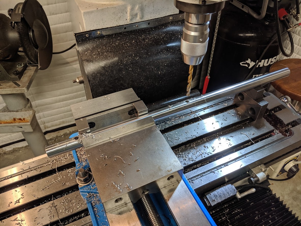

Over to the mill, drilled 5/16" holes, each end to hold 5/16" screws which would retain a 1" washer IMG_20190918_092052.jpgon each end, and the center hole(s) to where the deck would be secured. IMG_20190917_162049.jpg I drilled 2 holes in the center, just so I'd have some play where I'd center the mower deck in case it tended to lean one way or another. It's a good thing I did, the second off-center hole ended up being the winner.

Guys, if you wanna build the same thing, here's the dimensional drawing for drilling the rod: mower dolly rod.jpg You don't have to really go to 0.005" tolerance...but I'm **** retentive about listing dimensions. :D

Guys, if you wanna build the same thing, here's the dimensional drawing for drilling the rod: View attachment 622742 You don't have to really go to 0.005" tolerance...but I'm **** retentive about listing dimensions. :D

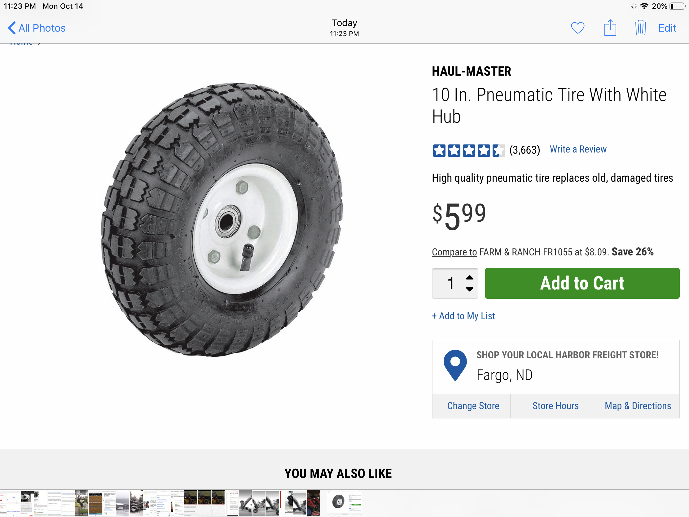

I just called the iron shop this afternoon and ordered two 12 inch pieces of 1 inch solid stock and I also ordered four 10 inch pneumatic tires for 3.99 each on sale with 5/8ths hub bearings from Harbor Freight and tomorrow I will pickup nuts, washers, bolts and pipes.

I was thinking of doing something just about like that but then went what the heck and went this route, with the wheels, iron, washers, nuts and cotter pins I am into this for about 32.00 dollars.
