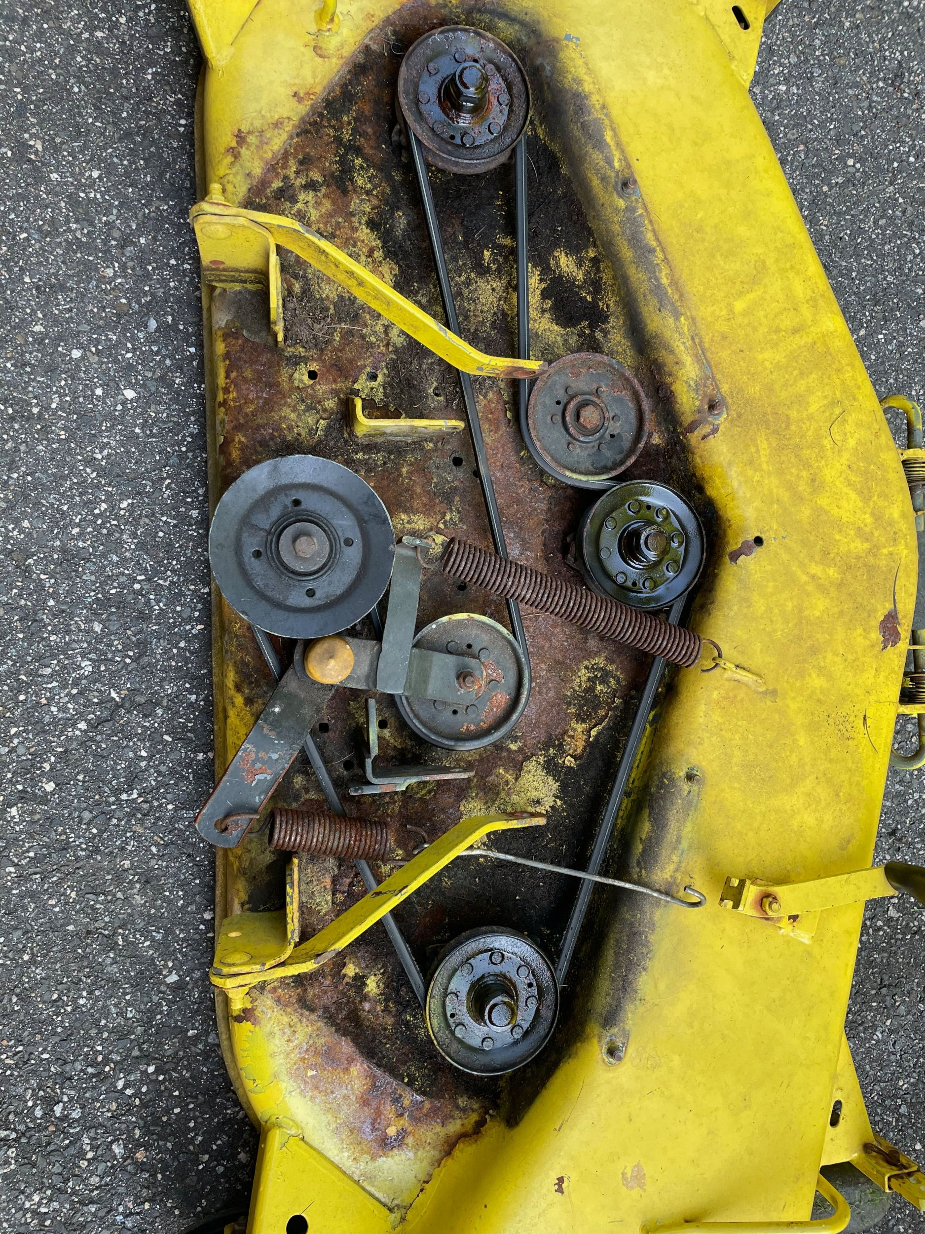

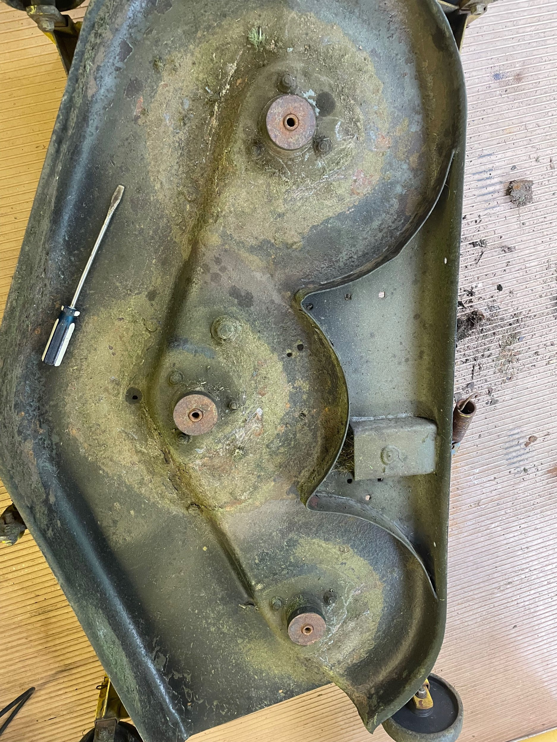

Got the bearing removed the blades, etc and WTH is this? Sure doesn't look like all the pictures and videos I've seen. So right now stumped in how to take the spindle apart. Frustrated because it should have been an easy job but it sure doesn't look like it. I wonder if on this model mower only way to fix the bearings is replace the entire spindles and pully's... oh well nothing ever simple.
/ Mower Deck Parts #8
/ Mower Deck Parts #9
I'm not sure, but it appears that the spindles can be removed from the top of the deck. You need to get that belt off and then remove the bolts hold the spindles to the deck.
Then you can take the spindle to your work bench and get the pulley off.
Richard
/ Mower Deck Parts
Richard

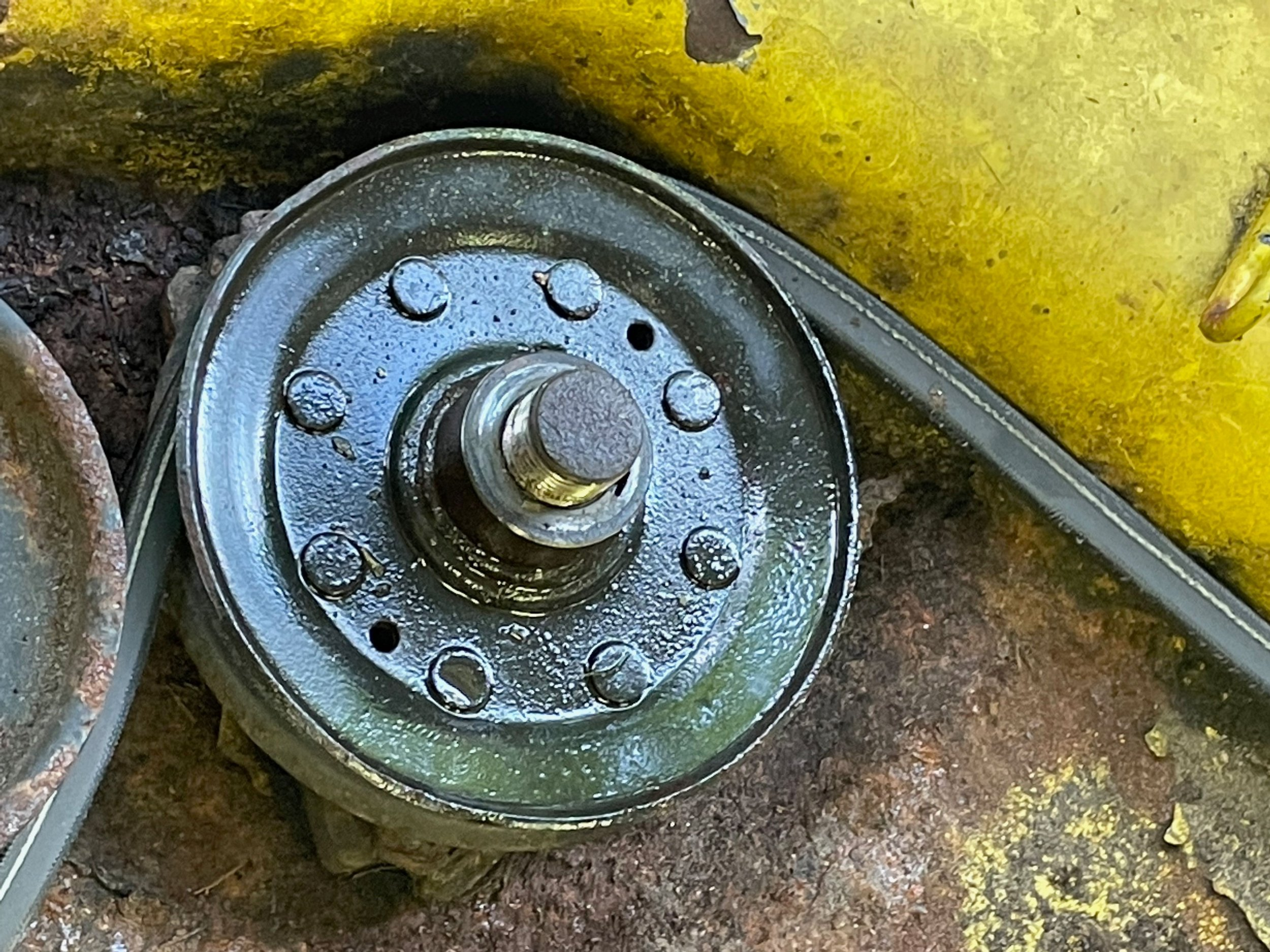

Yep... have to remove the spindles and use a hub puller for the pullies! The pullies are keyed to the shafts as opposed to the newer method. Turns a simple job into a real pita to install new bearings but unless I replace the entire spindles there's no way of doing it! Grrrrr Don''t even know if the newer spindles would work and finding some 35 years old is probably not going to happen. Oh well that's what I get for having a machine 35 years old.... lol

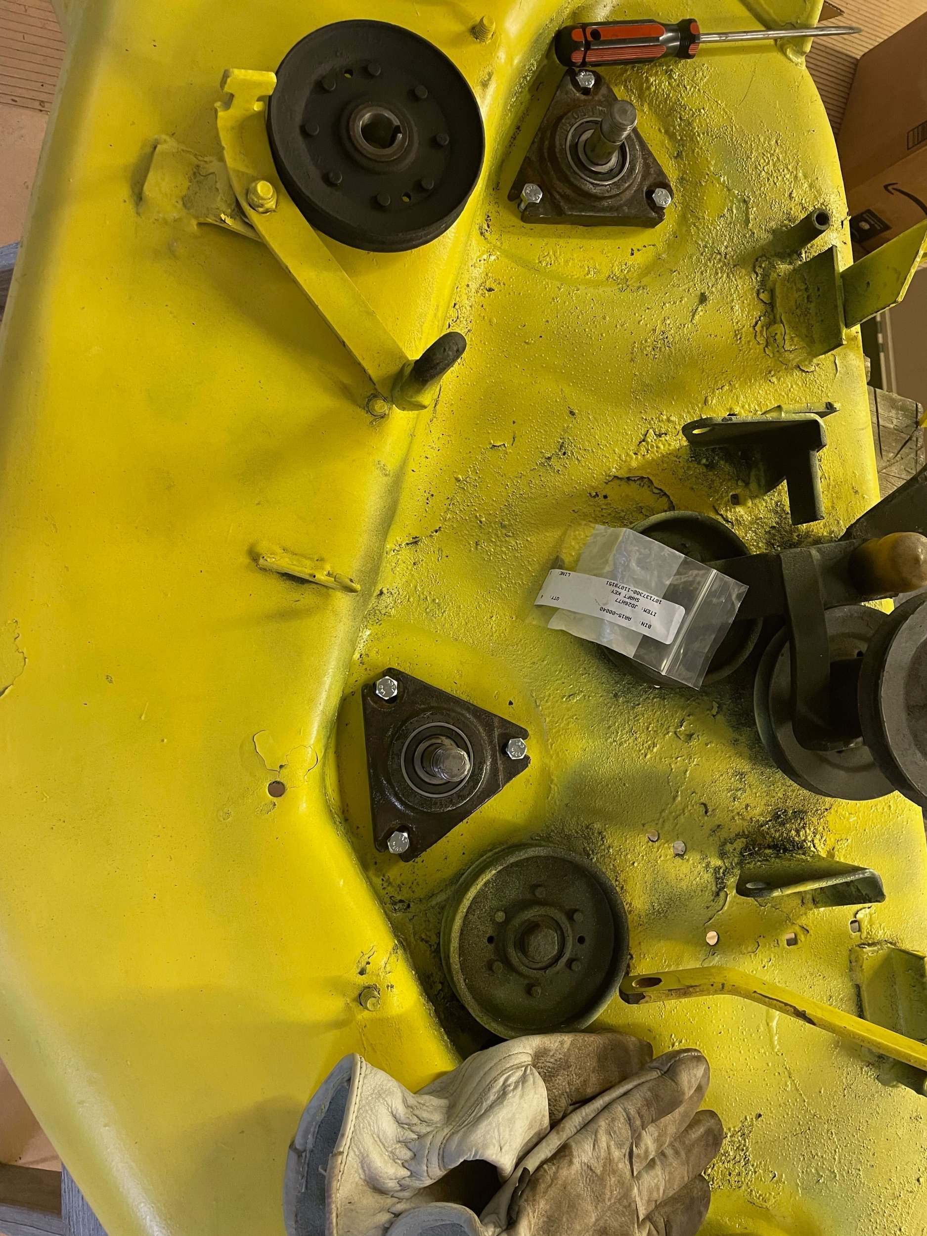

Thanks to those folks that helped me get the bearings changed on my 46" 35 year old mower. It was more of a project than I had planned to be honest. However it's all finished and fired it up today. Mower ran nice and smooth so it was a worth while project. Hopefully now the mower will out last the owner! lol

Did you press the shaft through or were you able to extract the pulleys w/o damage?
/ Mower Deck Parts
#13
I removed the 3 spindles and worked them on the shop bench. Had to cut (grind) off the bolts holding the spindles to the deck as they were completely rusted and snaped off. Damaged 1 pulley and purchased another new one. If I had a bearing press it would have made the job much much easier. If I ever did it again I'd buy or rent a bearing press for sure. I froze the spindle shafts (-9F) and heated the bearing to 200F. Even doing that it was a real ***** and damaged some shaft threads. Had to take them to a machine shop which fixed the threads so I was able to salvage them. I think the key to doing the job much better and eaiser is having a small bearing press. At least it's done and I learned a lot doing this project. FYI complete spindles are still availabe at almost 300 bucks a piece! NO WAY I was spending almost a grand replacing them! lol Yes I'm cheap.
