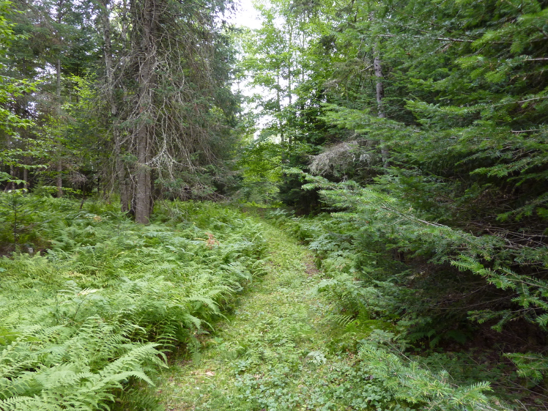

When we first bought this place there were very few trails I could take the tractor on. They were very rough skid trails loaded with stumps, boulders, hole, ruts, and side hill slopes so I bought a self contained bush hog to pull behind the wheeler. My intention was to get a bush hog for the tractor when I got my trails fixed up. I have lots of tractor trails now but the 4 wheeler is so manuverable and the mower works so good I have not felt the need for a tractor bush hog. It is a heavy duty unit compared to the Swisher's. They would need reenforcement for my use IMO. Mine was made by Fuerst. Unfortunately they are out of busines now. We use our trails for logging and to ski on.

The trails look nice :)
