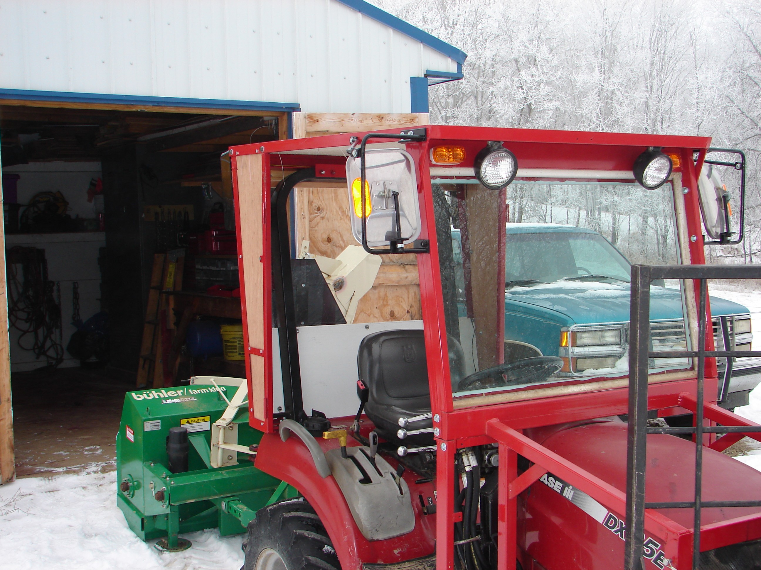

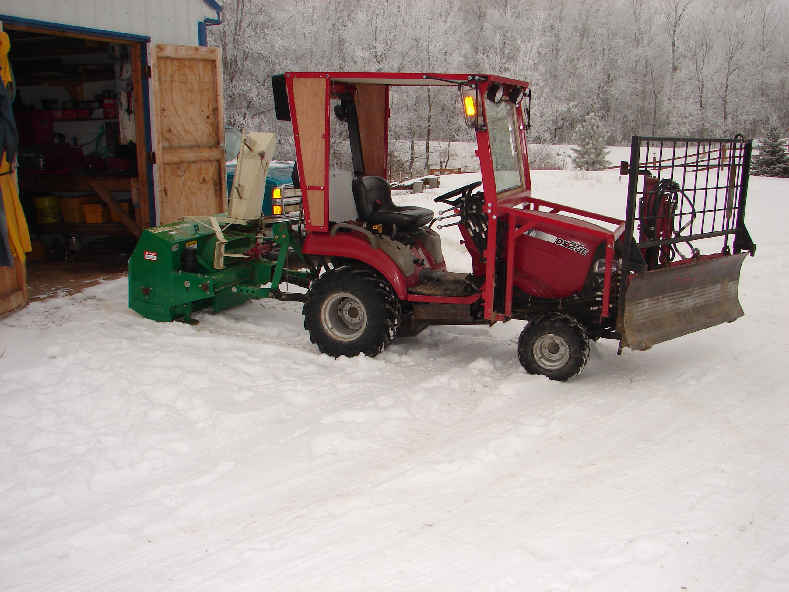

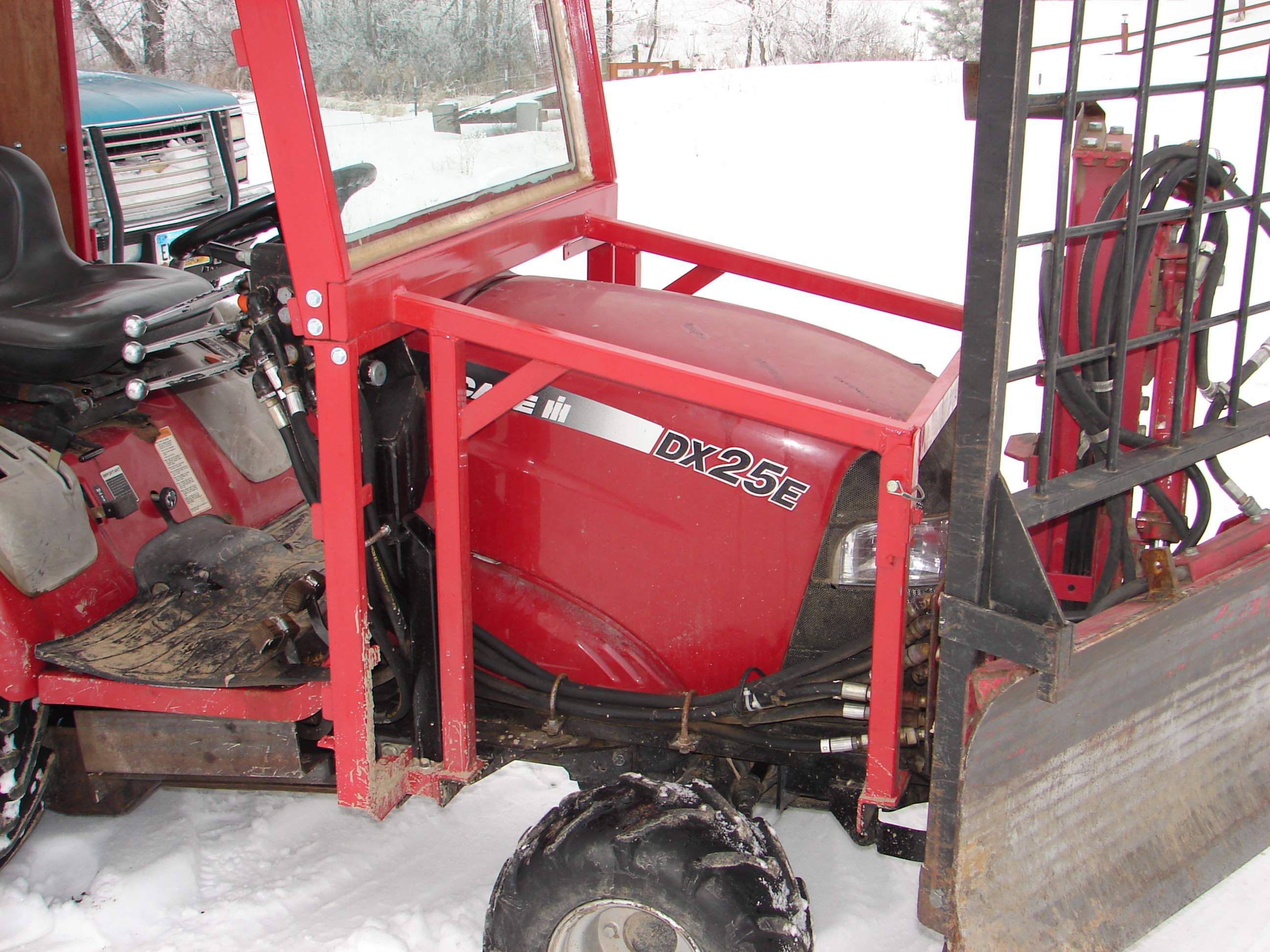

I'm also from the ND Turtle Mountains, and I create and maintain trails, thus far about 2 miles worth about 8 ft wide on our own property. I have a tractor modified for just that work.
My first picture is of the tractor, it's currently rigged for snow removal, but for trail work there would be a 4' brush hog/rough cut mower behind it. For new trails, I chainsaw cut anything bigger than two inches. 2 inch and smaller I drive over with the dozer about 6" off the ground, then the brush hog chops them up. I have to go over a new trail between 2 and 6 times to pulverize all of it. Notice the brush guard on the dozer. If you do not have this guard and a cab you will forever be slapped in the face by brush and trees.

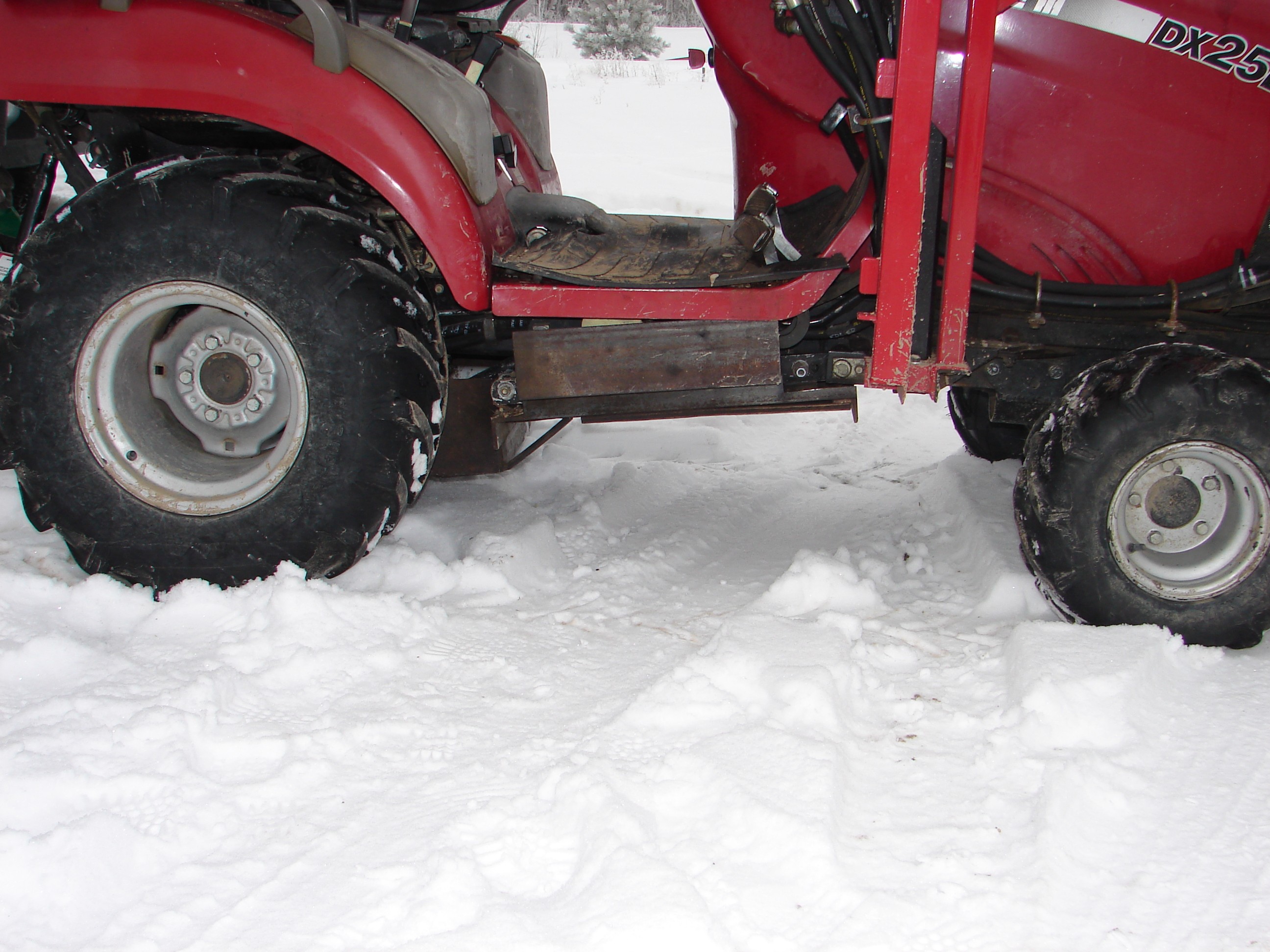

The cab is made quite strong for small trees 6" or smaller to fall on it. Safety glass in front, plexiglass in rear. The cab is unfinished and in progress. Another picture shows the engine guard. This is so trees falling or scraping will not ruin the hood. Another picture shows the underbelly guard. This is needed to prevent the drive shafts, hoses and other items from being ripped off or bent while going over brush and small trees. This belly pan quick detatches in the same manner that the tractor's belly finish cut mower does. Another is of the mirrors, they are in a braced guard to prevent trees from ripping them off.
This setup gives practically no trouble. The brush hog does a very good job, it's a heavy duty ag model I picked up at a place called Runnings, which is a local version of Tractor Supply.
There is another rear attachment used for skidding logs as this tractor uses the same trails as logging trails to get firewood. In addition to skidding, the attachment has a electric cable winch for drawing logs to the trail, forks and grapple for lifting logs to cut into fireplace lengths.
Hope this helps all.

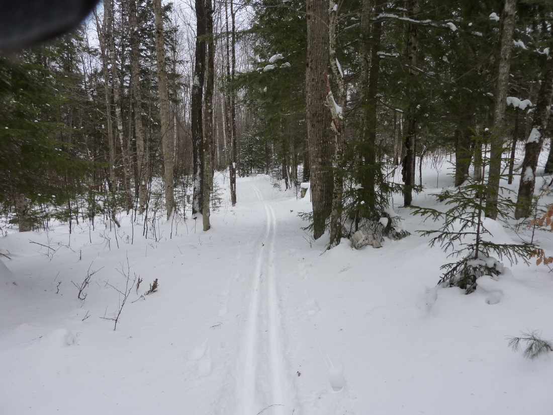

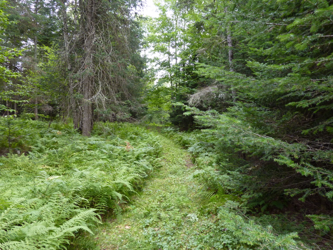

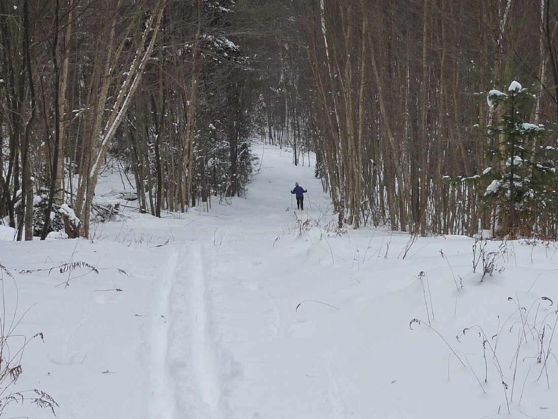

When we first bought this place there were very few trails I could take the tractor on. They were very rough skid trails loaded with stumps, boulders, hole, ruts, and side hill slopes so I bought a self contained bush hog to pull behind the wheeler. My intention was to get a bush hog for the tractor when I got my trails fixed up. I have lots of tractor trails now but the 4 wheeler is so manuverable and the mower works so good I have not felt the need for a tractor bush hog. It is a heavy duty unit compared to the Swisher's. They would need reenforcement for my use IMO. Mine was made by Fuerst. Unfortunately they are out of busines now. We use our trails for logging and to ski on.

The trails look nice :)
