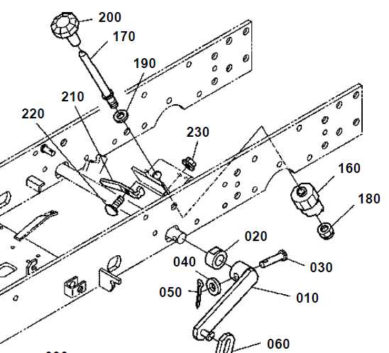

I've been trying to get my mower height control to work ever since I got my rig. I set it to the top or any other setting and the mower goes right to the ground, every time. So I pulled the mower off and crawled underneath it. It appears that the mounting bracket has either come loose or is totally broken off. I can rotate the knob and feel the cam turn underneath, but the whole shaft can wiggle around and be pulled up and down. I've got a parts manual on cd, but I can't tell from the drawing where/how this bracket mounts to the frame.
Anybody got any advice? This is a BX2230 model with the 60" mmm. Thanks!

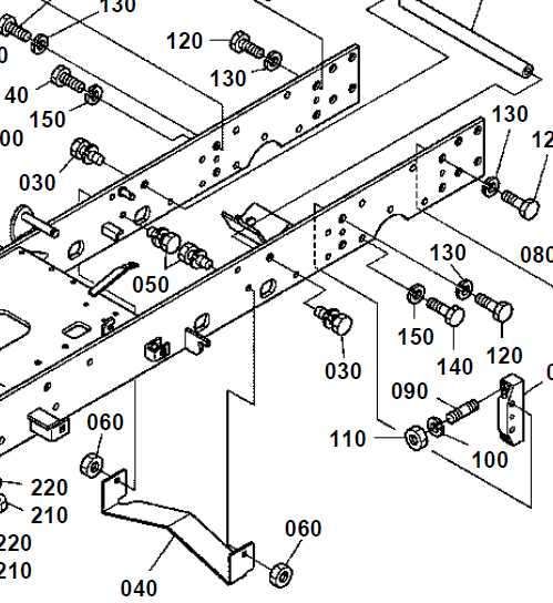

I've got a cd parts manual. Here is what I found there.
The fact that this angle bracket exists in not only the mower height control drawing, but also in the basic frame drawing with the HST guard and the tie rods makes me think it is part of the basic left side frame.

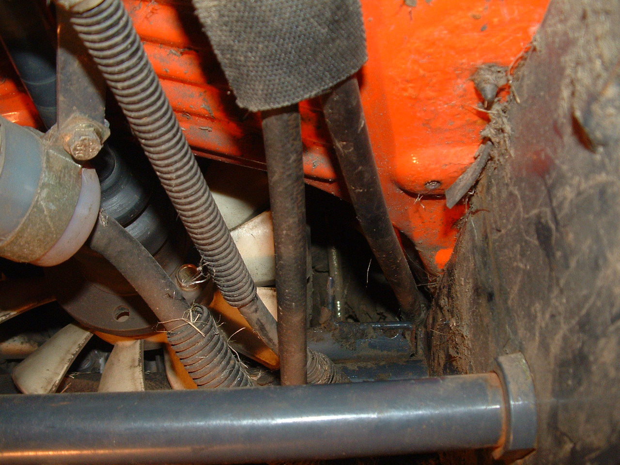

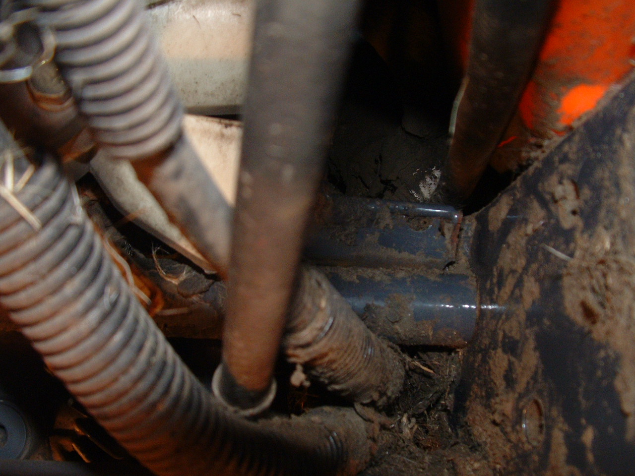

I wasn't even sure this was the right part, but the little tooth that points up and to the front sure looks like what I see under my tractor.
Sorry, I can't seem to get the camera in a place quite as good as my eyeball.

It is hard to tell, but it looks broken to me and your rod should not be able to rotate freely or go up and down.
I am disabled, or I would go out and check my BX2660.
I am assuming you have checked to make sure the nut has not come off the end, mine on our old BX2200 did that once and allowed the whole assembly to wobble around.
