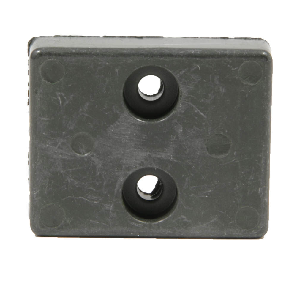

   / Mower idler pulley #26
This is the brade pad I am referring to. View attachment 3740166
The picture is turned 90 degrees so the rivets holes would be installed horizontal. The spindle pulley brake edge will wear a 1/4 inch groove above and below the rivets holes and will start on what would be the vertical edge and wear until the grooves reach about the 1/2 way mark across the pad before the pad is worn through and the metal spindle pulley starts making contact with the metal backing plate.
Got a link and part number for those pads?
