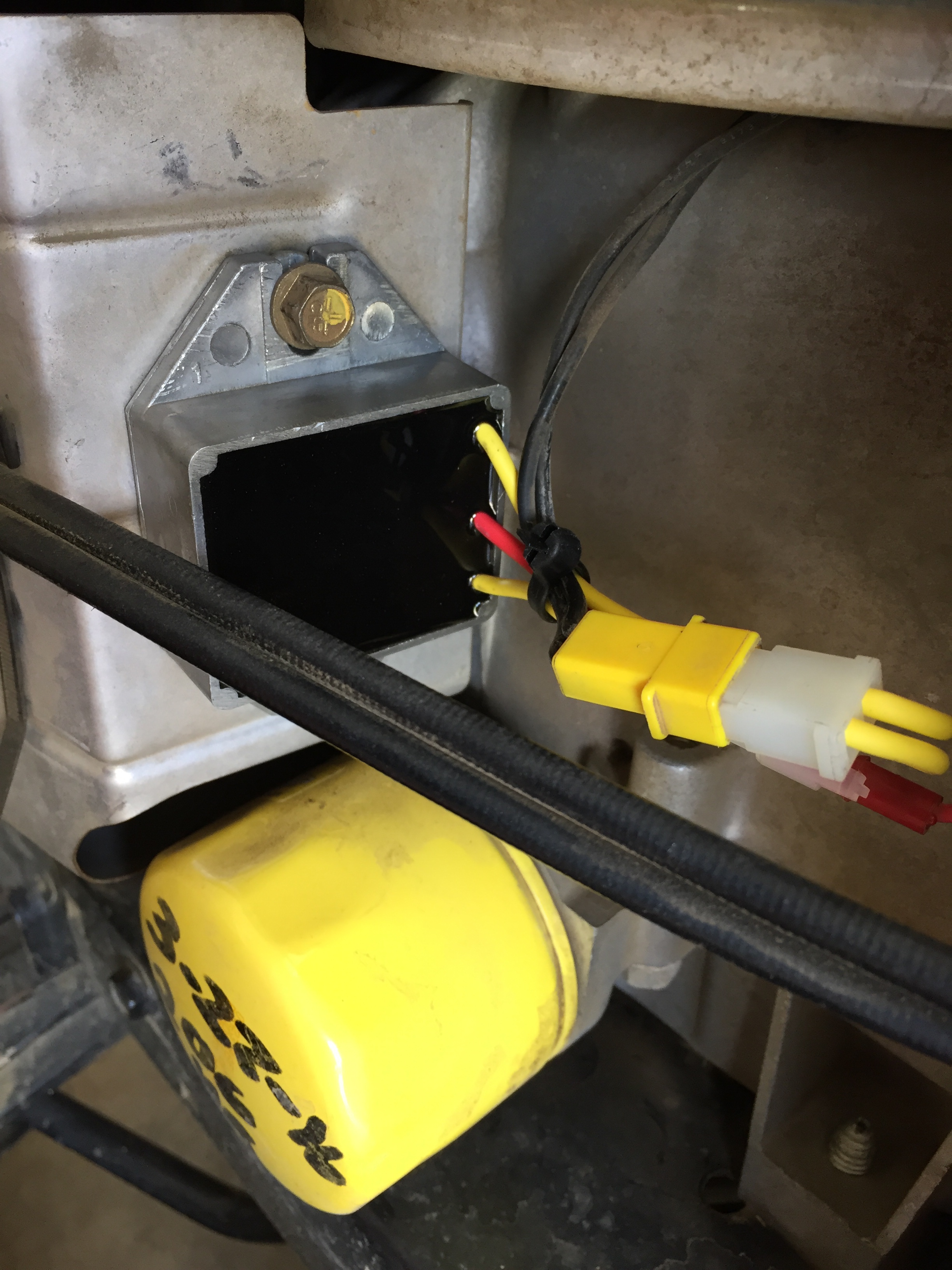

I had one go out on Gravely rider with Onan engine. $75-100 for replacement, but I put a $15 generic one on and it has worked fine for years.
   / Mower is acting funny, what do you think is wrong? #23
There it is, $12.50 in all its glory professionally installed I might add lol.
I'm getting 33v AC out of the alternator and I'm getting 13.3v DC at the battery, my problems are solved.
Excellent! Should last a while. Nice when things go right, and fairly cheaply too.
I didn't even price a OEM regulator, I just found one on Amazon and ordered it, if I get 2 years out of this one, I will be very happy with that.
