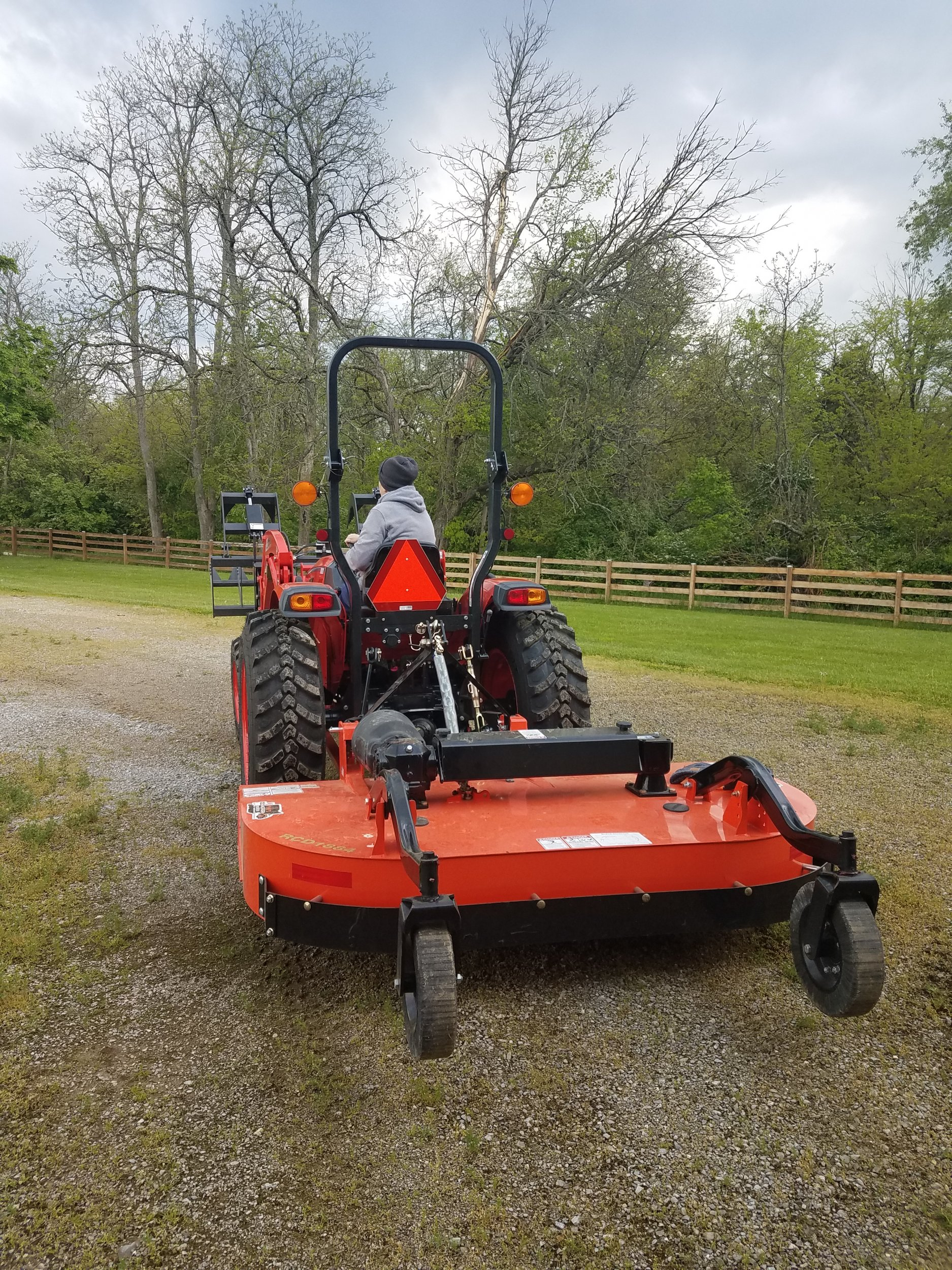

I am considering to buy a Land Pride RCD 1884 you might want to check it out.
RCD18 Series. Rotary Cutters. The RCD1884 is a smooth-top, offset cutter that performs best in grass-only applications. Being dual spindle, the cutter is shorter in length than single spindle 84" cutters; the reduced length allows for better maneuverability in tight spaces. The 10" offset makes the RCD1884 a good solution for applications
Wheelbarrow, I just bought a RCD1884 when I got my DK4510. Have been real happy with it. I did have to cut ~6 inches off of the PTO shaft, no big deal. It is considered a light duty brush mower but I basically use it like a heavy duty finish mower. I bought it specifically for the reasons you stated, especially the shorter length.
"Like a heavy duty finish mower" is a great description and might be the perfect tool for these situations. How smooth/clean is the cut?
/ mowers. #47
Considering it is still fairly new (~20 hours) it cut very well. The dual tail wheels helps to keep the deck level on uneven or rolling terrain, something that my SQ60 didn't do so well, especially backing up. The first time I cut the grass was pretty high considering that I had to wait for my tractor, and so I got a late start. The grass was mostly waist high, higher in some places, so there was some winrow effect and clumps as can be expected, but the cut was clean. The second and third mowing cleaned everything up nicely. Probably not as nice as a finish mower might but looks very good now. IMHO the winrow issue is less from the cutter and more from the tires knocking the tall, thick grass down and it not coming back up fast enough to get cut. I still have my Sqealer to use on my trails and for cutting brush. I figure these blades will stay sharp awhile just cutting grass. They recommend 35-60 PTO HP so it seems too big for OP requirements. The 900 LB weight and short length make a nice counterweight for my grapple. You do have to remember the offset though, took a chuck off of my barn door second time out. Instinct is to center up through gates and openings, but you learn very quickly after something like that. :LOL:
Also, cleans up nicely with a leaf blower with the smooth top.

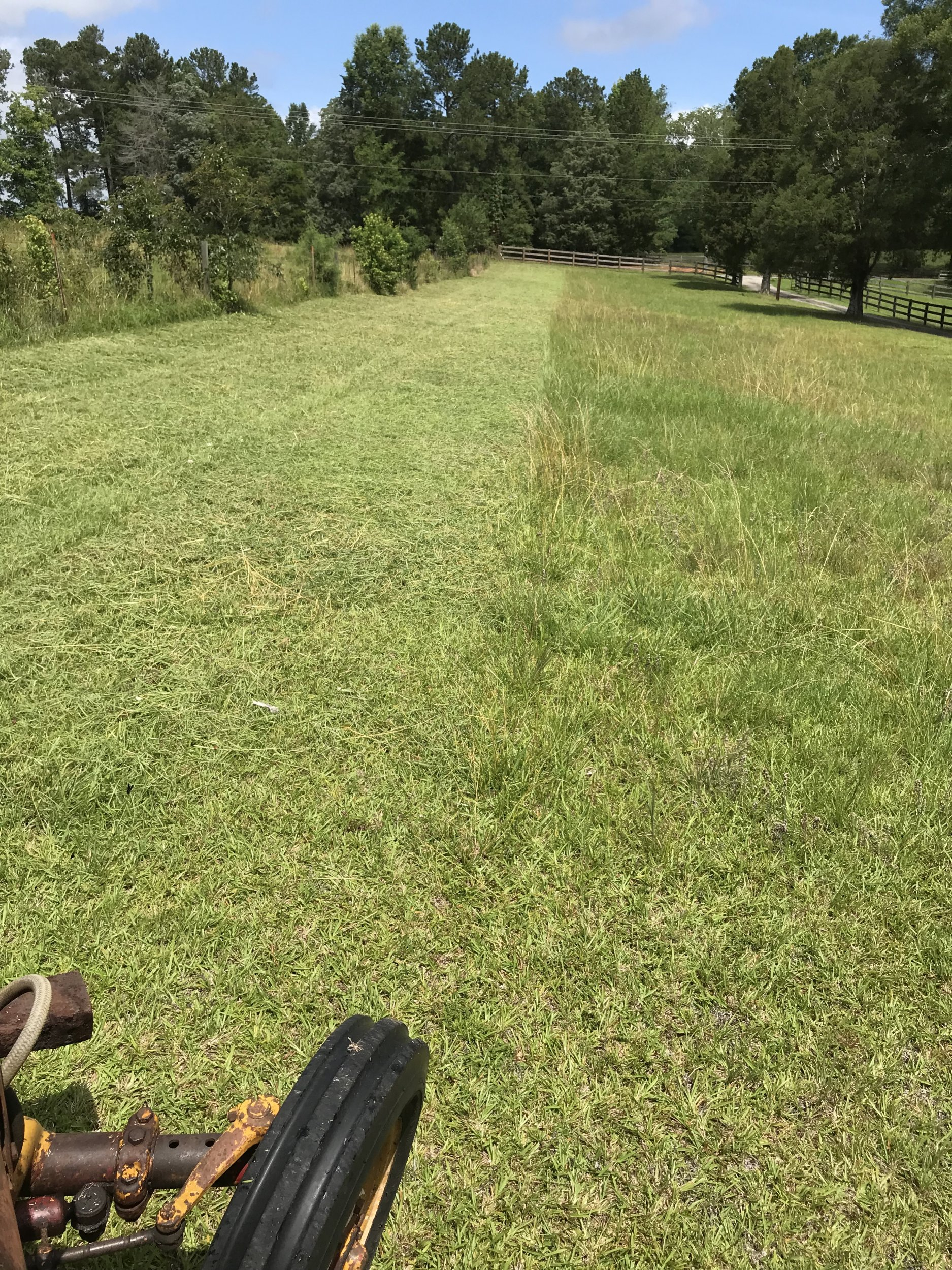

Alamo 96” flail mower results with a 37 PTO HP tractor.
