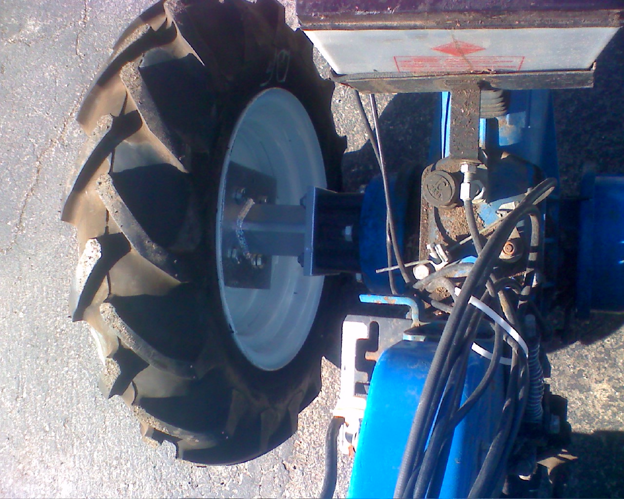

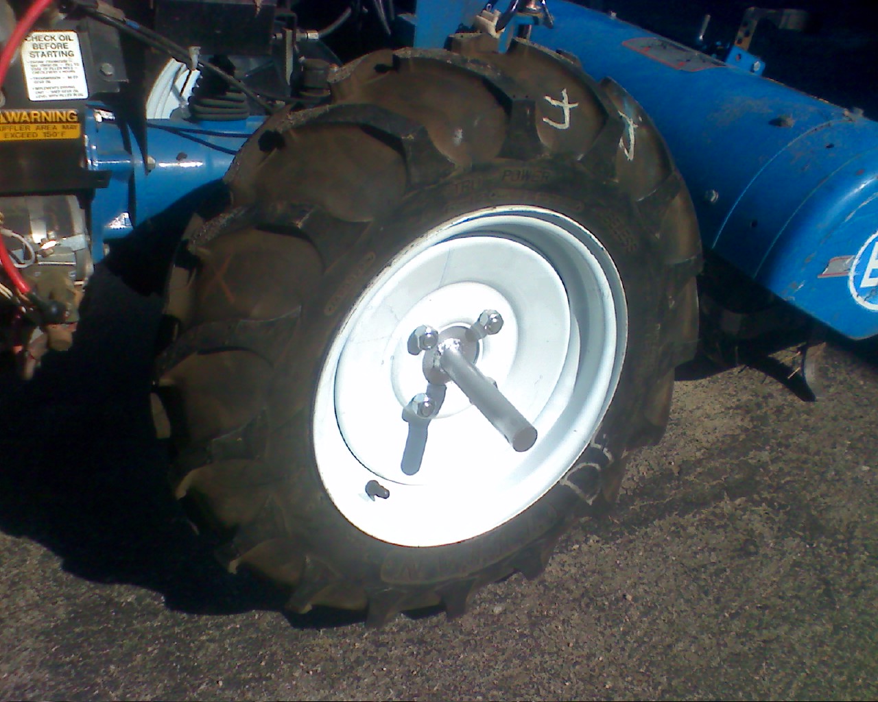

My biggest concern is the fact that it doesn't pivot at the connection like the sickle mowers and brush mowers. With the rigid connection, I don't know how it would do going over rough or sloped terrain. I've been meaning to talk to Joel about it, but haven't. Perhaps there's an adapter that would give me 15 degrees of flex like the other mowers.
The wheel width is whatever you wanna make it. Right now, mine are 26 inches center to center (32 at the widest), but I have the 5 total inch fixed axle extensions, some custom made 9 inch total extensions, and trailer rims instead of the stock offset rims. I think the total width standard is 22 inches for my machine with stock offset rims. Your 853 should be the same.
I posted some pics of my custom made adapters. They're sized to fit the BCS hub on the inside and trailer rims on the outside. I welded the round stock for free weights right on the extensions, allowing me to use the other ones on my 730.

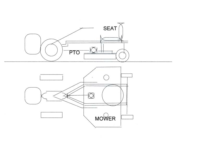

Hi! I think for two acres you need 40 in. mower and sulky.This is the best for you.
But For FUN I make a plan for PULL a finish mower from a two wheels tractor. .
So you have a mower and a sulky in same time.
You need a 1 3/8 PTO adapter. You must verify ROTATION Mower vs BCS. If you can find a 1000rpm mower.
60 in. mower can need 20 HP engine. but with a Lower ground speed can work. Good Luck! Oldmech

What would it take to connect a Gravely deck to a BCS?
This is making me ask again as to whether you could connect a 60" deck made for a standard tractor. As I stated in my original post, they are only lifting them to load and unload. Otherwise they are supported by the four wheels.
BCS PTO turns the wrong way, as far as I know, to connect to a Gravely deck. A standard 60" Gravely deck just requires the Gravely Conversion kit for the Center Mount 60" and uses a QH setup.
