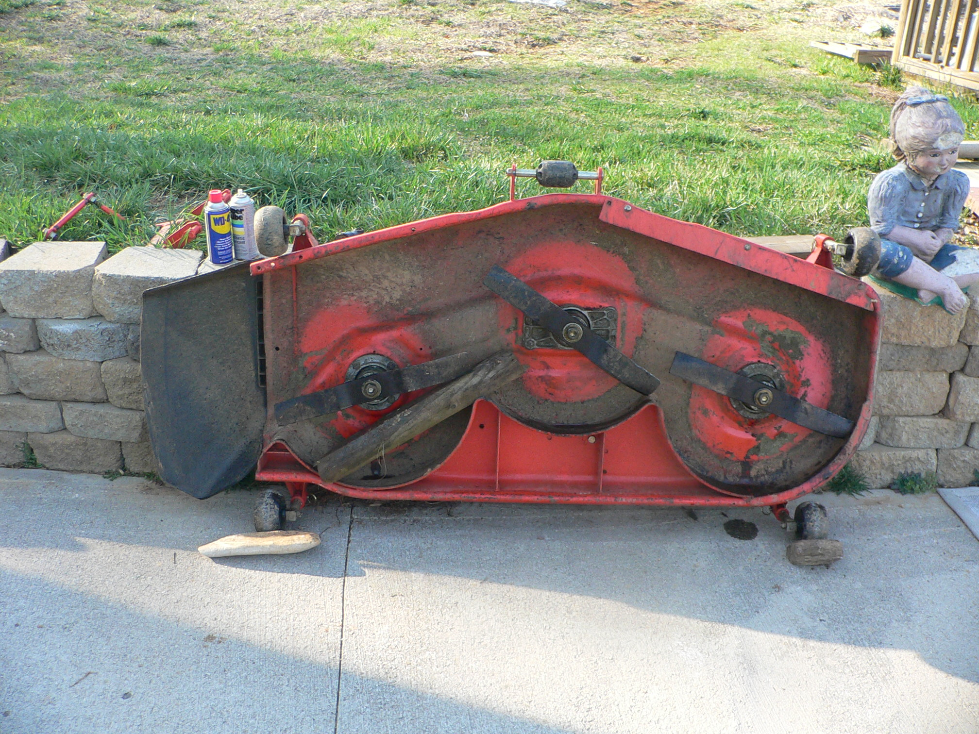

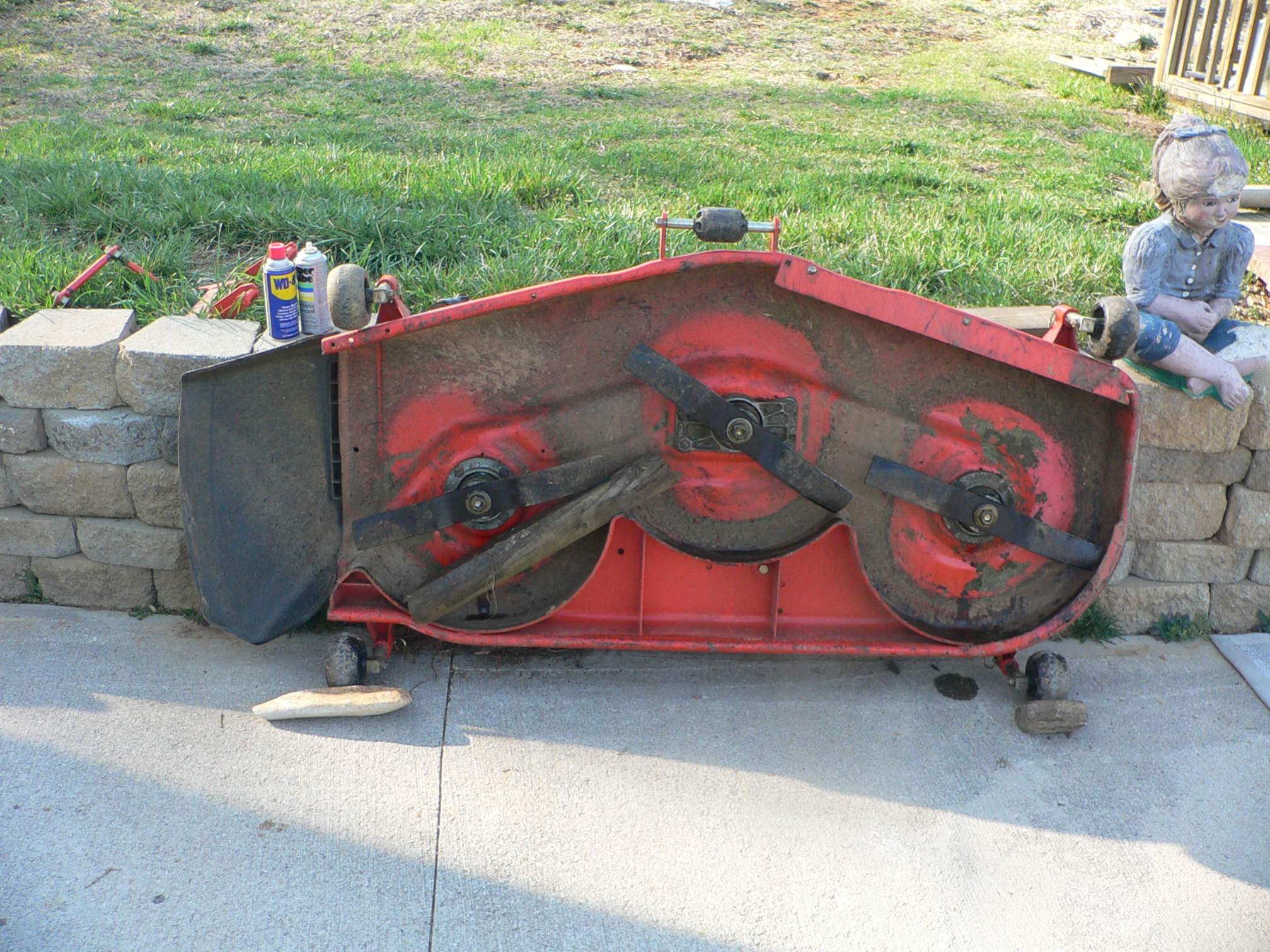

While I have my deck off, I want to replace or actually get a spare set of blades so can sharpen one set when I decide I have time and then replace them when they dull, just rotate them. I finally tried my air impct wrench on my tire removal and it's great so I want/need to buy a socket to fit the bolt holding blades on. What size socket? It's also opposite of righty tighty and lefty loosee isn't it?

Since no one has answered you yet, they look the same as on my B3030. They take a 30mm socket & they're right hand threads.

Thanks guys. 30MM it is. Right hand threads mean opposite of most threads, right? Means I have to turn these to the right to loosen them and left to tighten them?

They are normal Righty Tighty, Lefty Loosey.

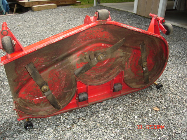

Interesting... here's what the red version looks like. Notice the smaller nuts (24mm) on blades....:D
You're right-- air impact wrench darned near compulsory to remove those nuts!

Decks off for fluids and filters service, don't have breaker bars or torque wrench and do have air wrench.:) I'll be more careful of what I cut with my new blades while I sharpen these old ones and maybe won't have to change them again until next service when deck will be off again.

Wife brought the 30MM 12 point socket. Put it on air impact driver and those bolts came right off without even blocking blades. Put new blades on and reversed direction of impact driver and they locked down in just a few seconds. I've now discovered a tool that I don't know how I've lived without it for this many years. It loosened and tightened so easy and I was even using my small compressor that won't hardly fill a portable air tank. Barlows is a good dealer, Kennedy is a good Dr, Tohill is a good dentist and air drivers are great.:laughing: Now you know how I feel about it.:)
