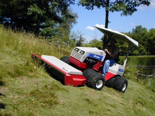

Another tractor to consider is the Ventrac 4200 31 hp turbo diesel. When equipped with dual wheels it is rated for continuous operation on slopes up to 30 degrees. See attached photo (slope of 28 degrees) and the Ventrac website Ventrac . The Steiner brothers who own Venture Products have been in business building articulated 4WD tractors since the middle 70s. A loader and over 30 other attachments are available.
I am delighted with my Ventrac 4200. I own it specifically because I have steep hills to mow.
JackIL
