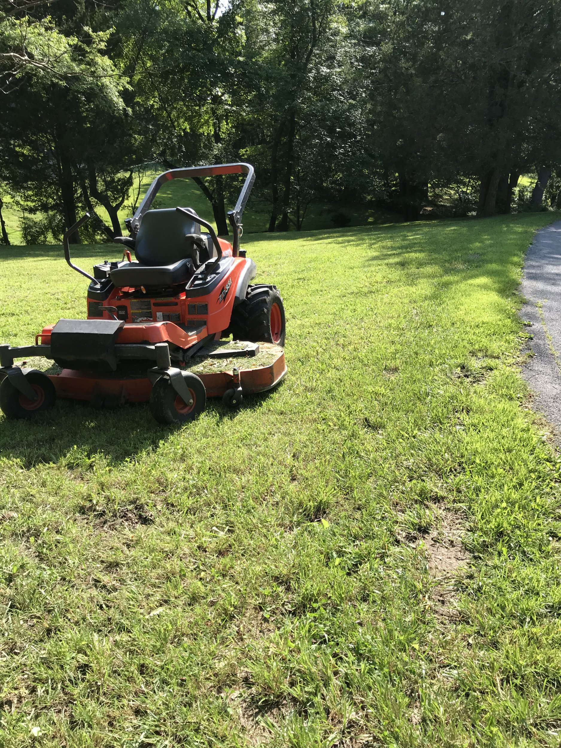

I disagree with Randy, zero turns handle hills better than a rider. Mine's a commercial unit and would put it up against any rider out there. It's wider than my old rider and has a lower center of gravity.
Agree. Zero Turns can mow very effectively across hills, too.
Also, if you put traction tires on a Zero turn, it’ll go anywhere you dare to go.

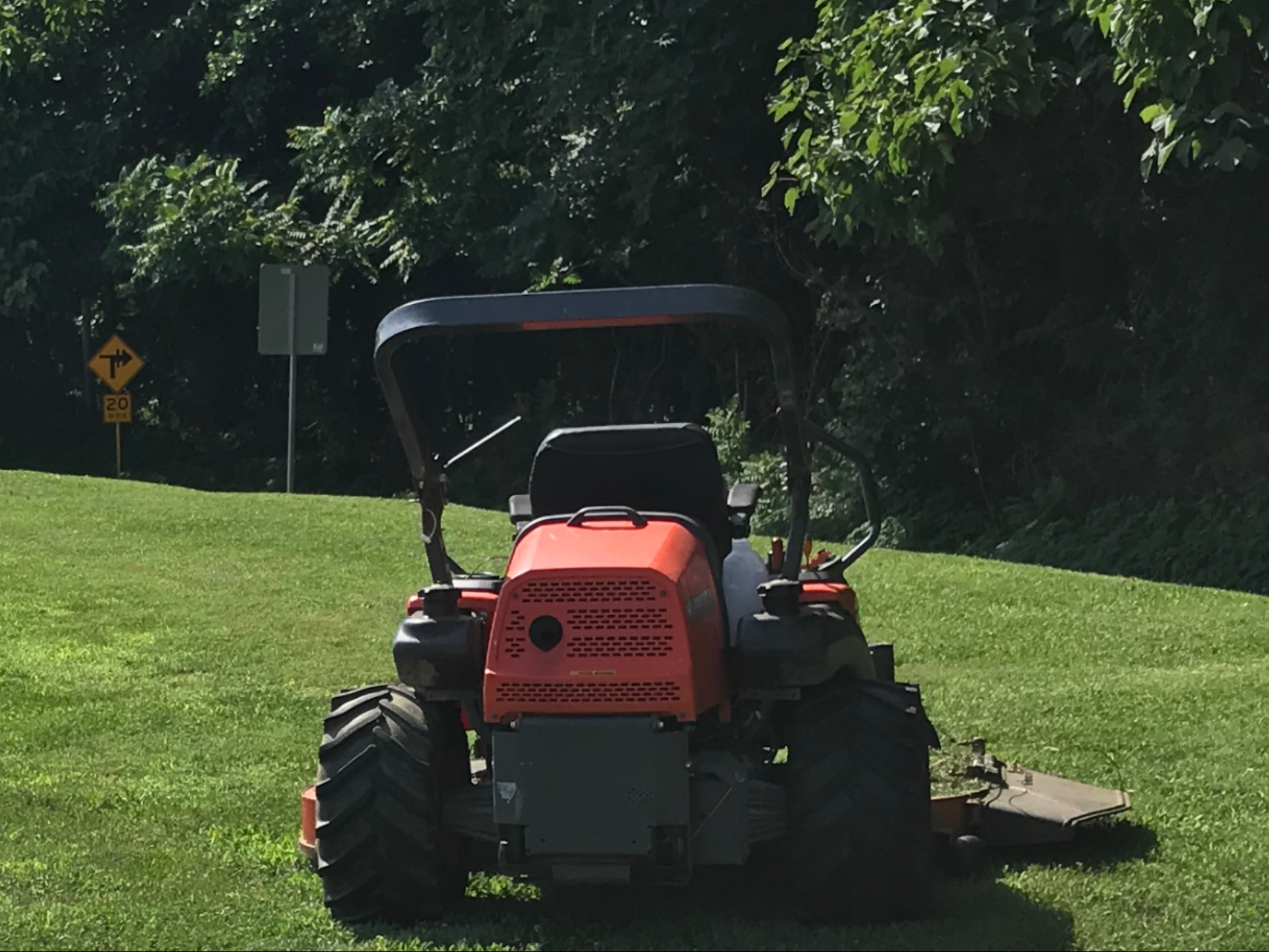

According to my gauge, I’m side mowing 50% grade on my property with my Cub Cadet Pro Z. Anything over 45% gets your attention (roll bar up, seatbelt on) and I’ve experienced some slippage at 50% on wet grass.
My machine isn’t rated for 50% but manages it reasonably well.

Were either of those ZT’s designed for mowing hills? If not, I’m not surprised they didn’t work. I demo’d several bar/lap style ZT’s and all slide down my hills.
I too can mow my hills with a 4WD tractor. I did it for over a year. I had to mow straight up and down in 4WD. It was sketchy at best and I couldn’t mow around any of the trees on the hills or the tractor would get tippy (that’s with loaded tires and 2 inch wheel spacers).
I began researching machines designed for hillside mowing and eventually purchased the Cub Cadet Pro Z 560 S KW. I couldn’t be happier.
This ZT has saved me over an hour of mowing time and is much safer mowing my hills than my previous tractor.
