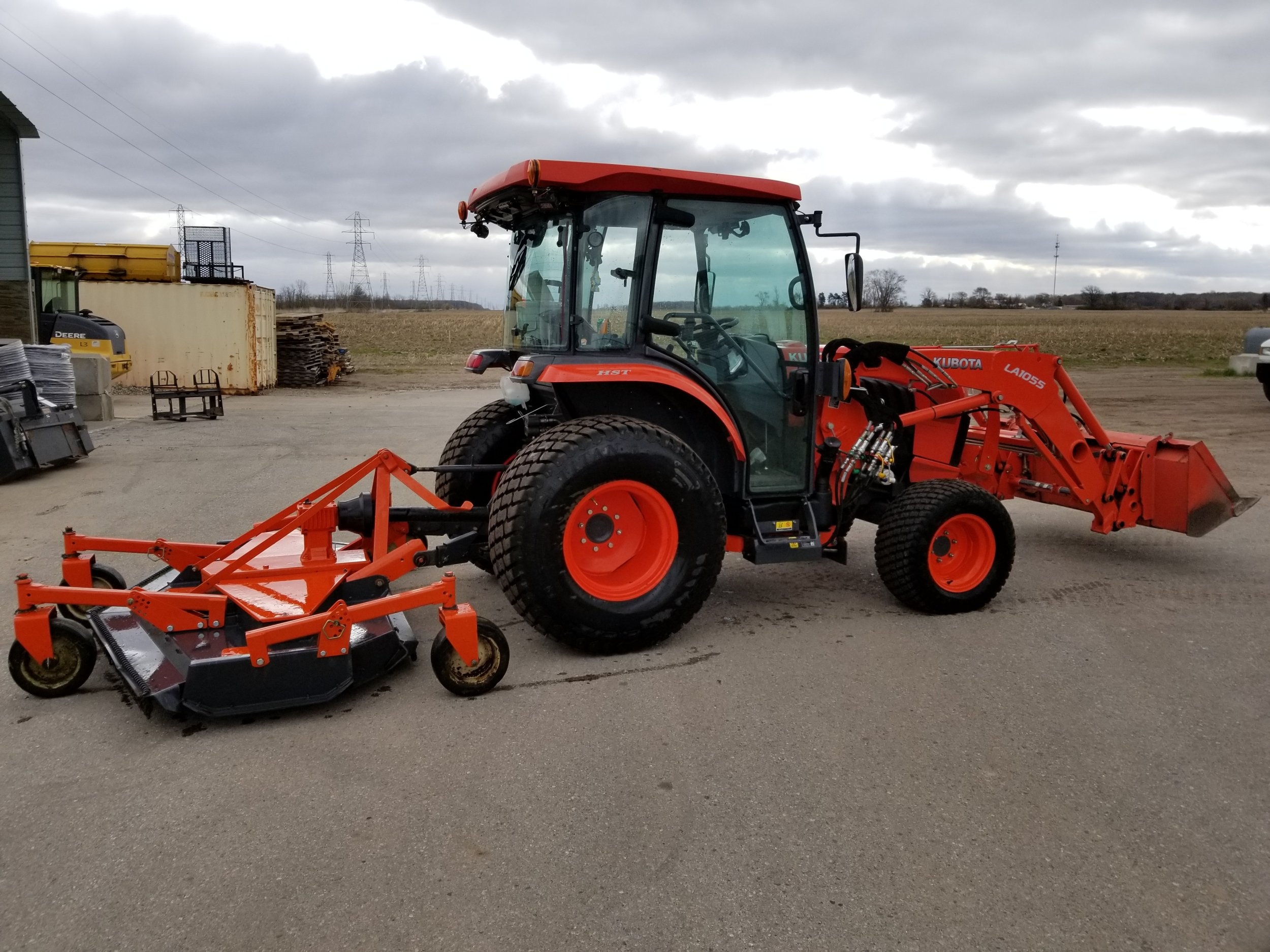

I use either a 90" rm990 woods 3pt mower or a 15' woods flexwing behind an l6060. The 15' is nice because it lets you slow down and not get as beat up on bumps but it gets pretty inefficient if you have to work around obstacles and takes a big trailer to transport and requires lots of maintenance. The 90" is a great all around easy transport, low maintenance, easy to use, super durable unit. Even being a model from the 90's that I found on craigslist for 1000 bucks 7 years ago its been reliable and easy to work on.
The thing Id be worried about is turf damage and ruts. the fields I mow are industrial building sites and park fields where it doesnt matter. even with a much lighter tractor and turf tires all around I can still peel up some grass if im not careful.
