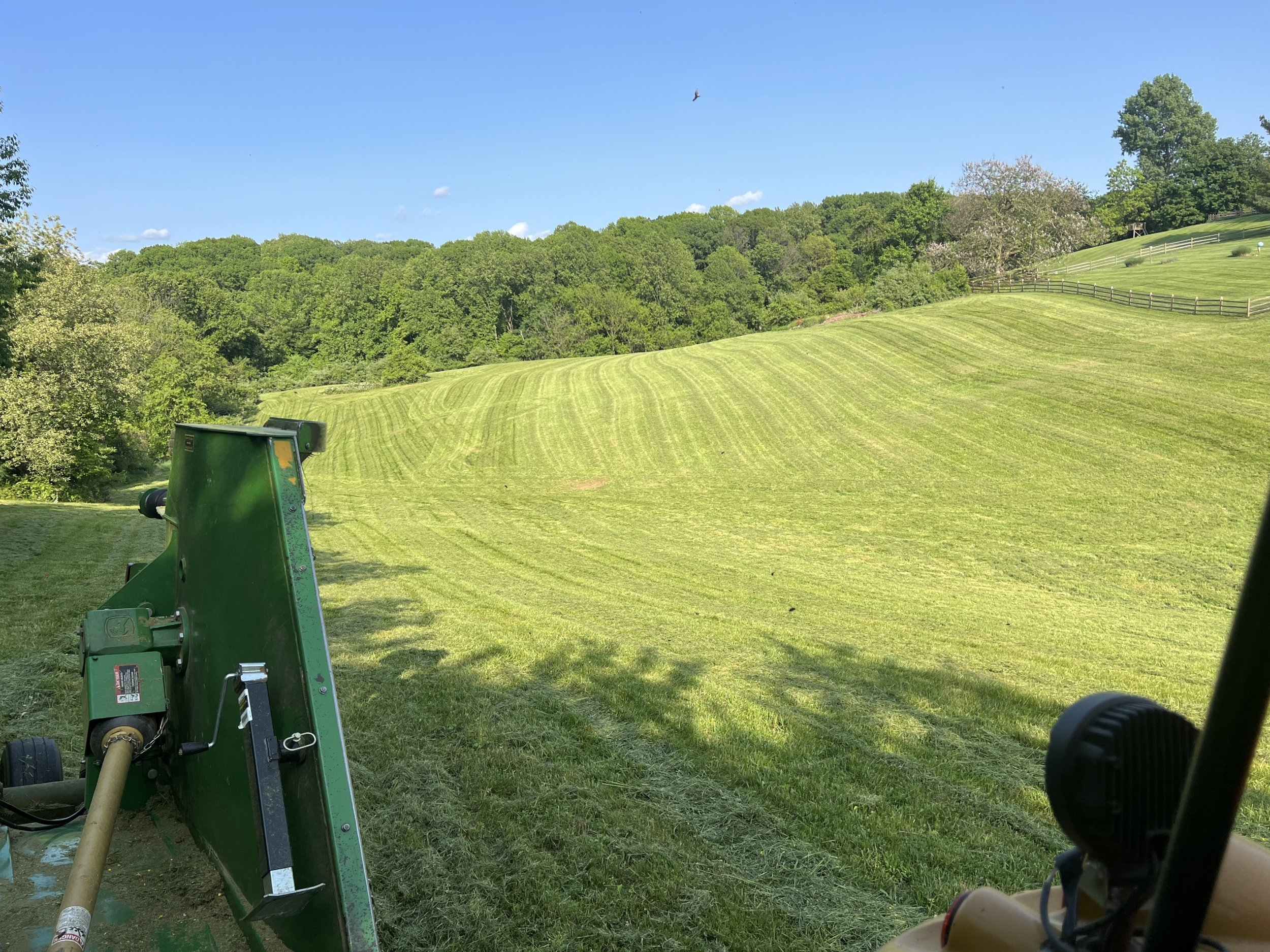

One other thing of note: You’d be surprised at how nice of a cut a traditional 15’ batwing bush hog can do on lawn grass with sharp blades. Those finish mowers are fine, but a bush hog is much tougher and you could cut properties with rougher grass.
Looks great.
What speed are you running to get that nice of a cut?

We will only do quality cuts. No mohawks. All fields will have same cut height.
I run 2.75-3.25 MPH.
Takes longer, but we retain customers forever and get new ones every year.
I mow about 1,000 acres of fields per year.

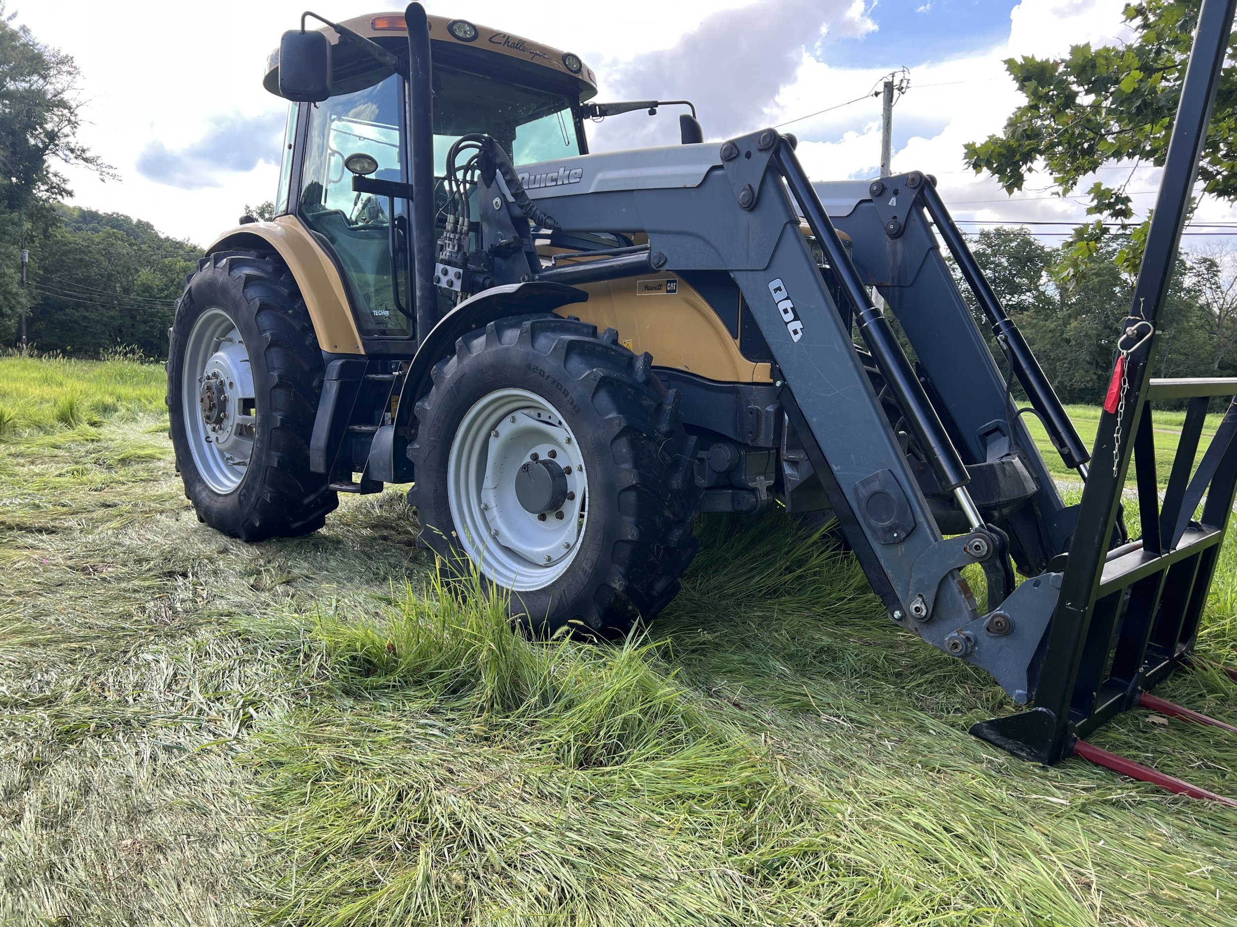

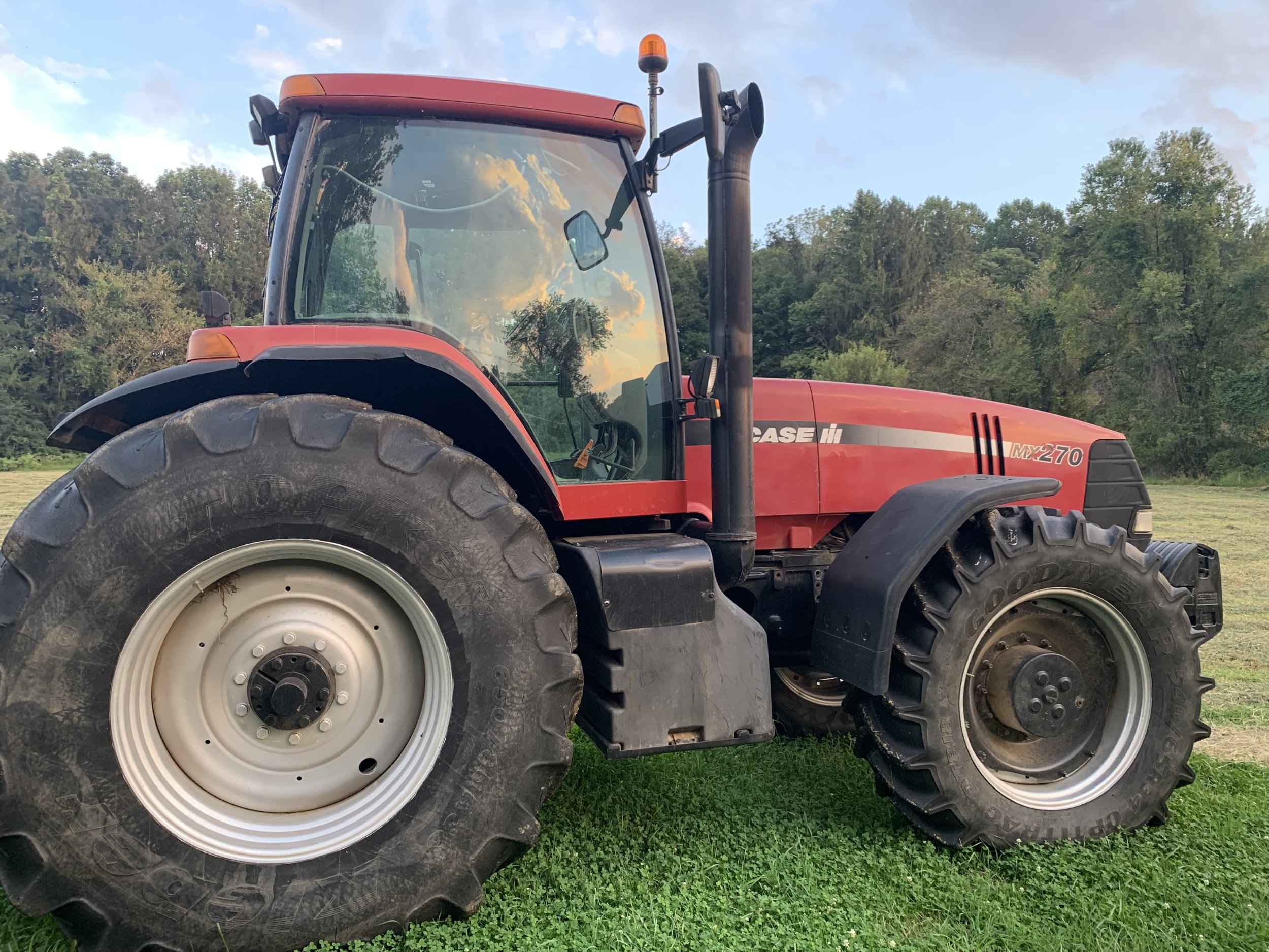

Lots of truth in that.
I always encourage tractor buyers to buy a tractor with the largest possible tire diameter and the heaviest weight possible over horsepower or bells & whistles.
This MX-270 tractor has no suspension other than an air ride seat and it rides better than the Challenger MT535B which has air seat, air cab suspension, front suspension and loader suspension!
Don’t get me wrong, the Challenger rides real nice, but the sheer weight of the MX-270 @ 24,000lbs won’t allow the tractor to lift up on one side if the other side goes into a hole. The Challenger will still rock side to side a bit even @ 15,000lbs.
