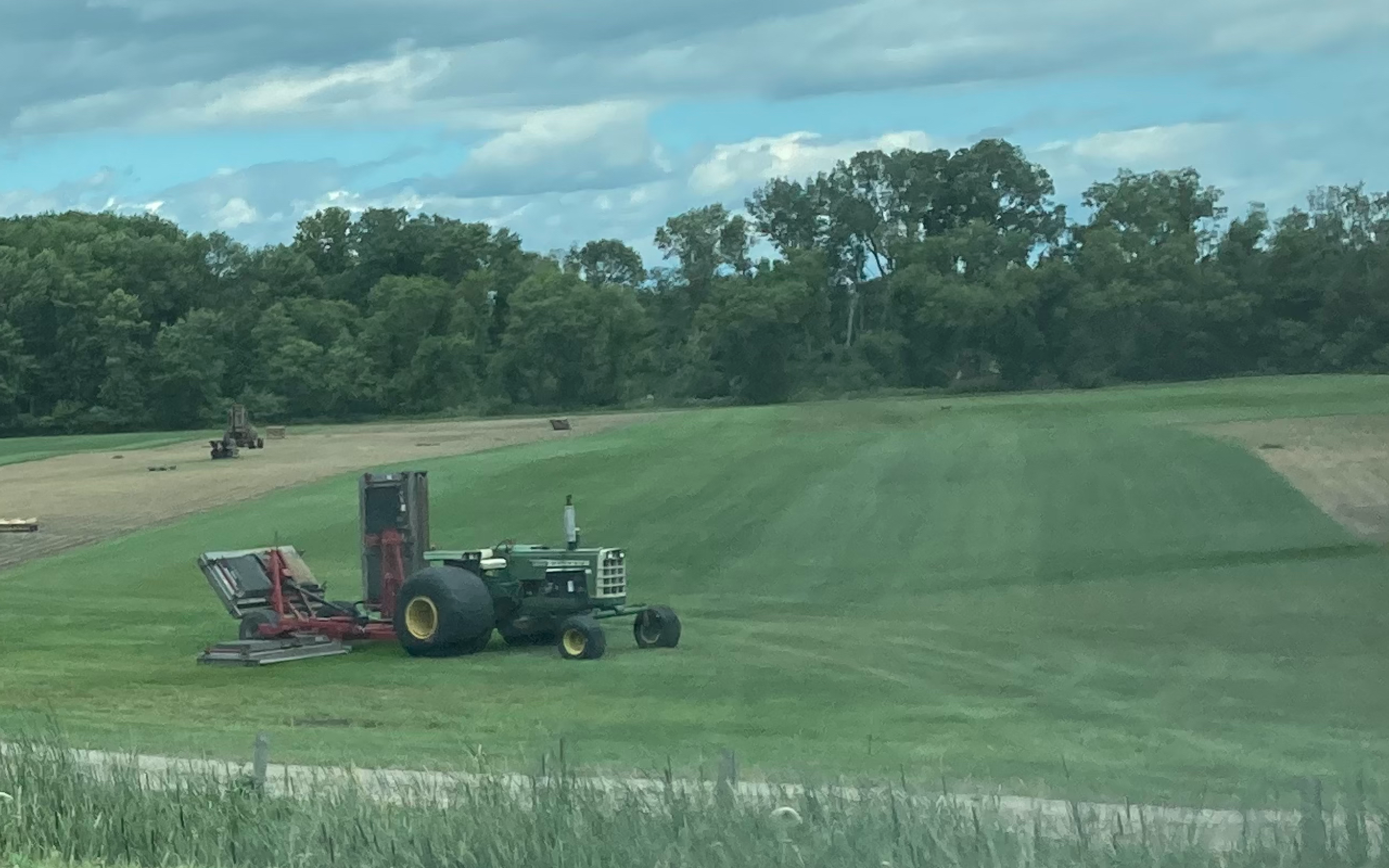

A friend of mine cuts 200 acres of grass. he bought a 15ft bat wing for his 100 hp tractor. he ended up trading in tractor for 125 hp. the 15 ft was just to much for the 100hp.

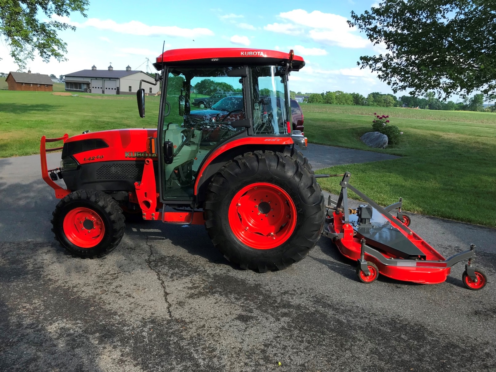

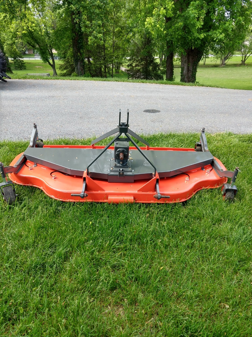

Went through several setups and added some grass since we built here in '89. Latest and best so far is a Caroni 7-1/2' deck I restored behind the L4240 with R4's. I can do the current 3-1/2 acres in an hour if I hustle and bounce around, but prefer taking an additional 15 minutes for a smoother ride. It marks less than the previous tractors and turns tighter than the smaller ones did. The rear discharge makes it easy to mow in different directions. (Color is really orange, not sure why the one picture looks so red)
