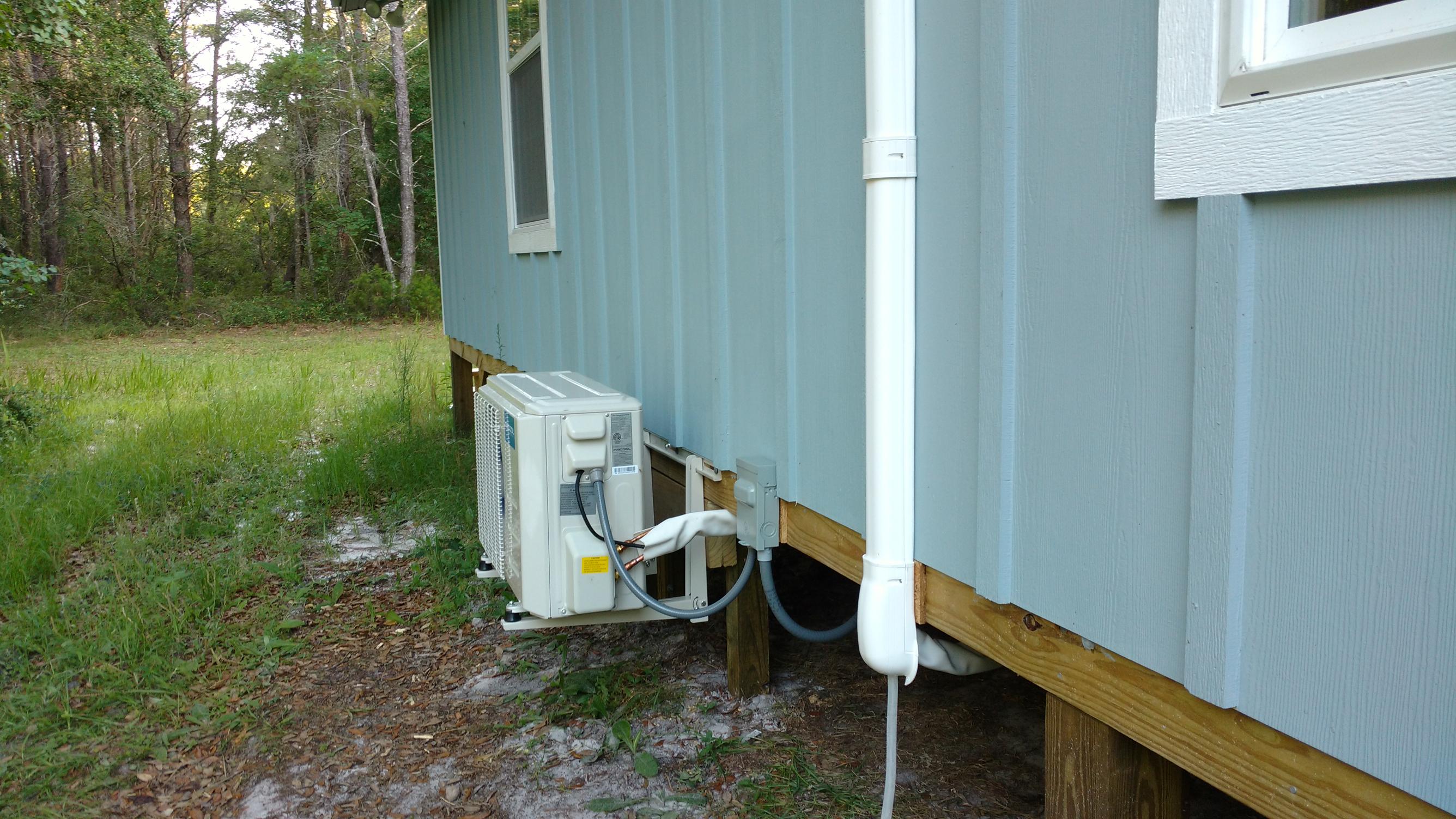

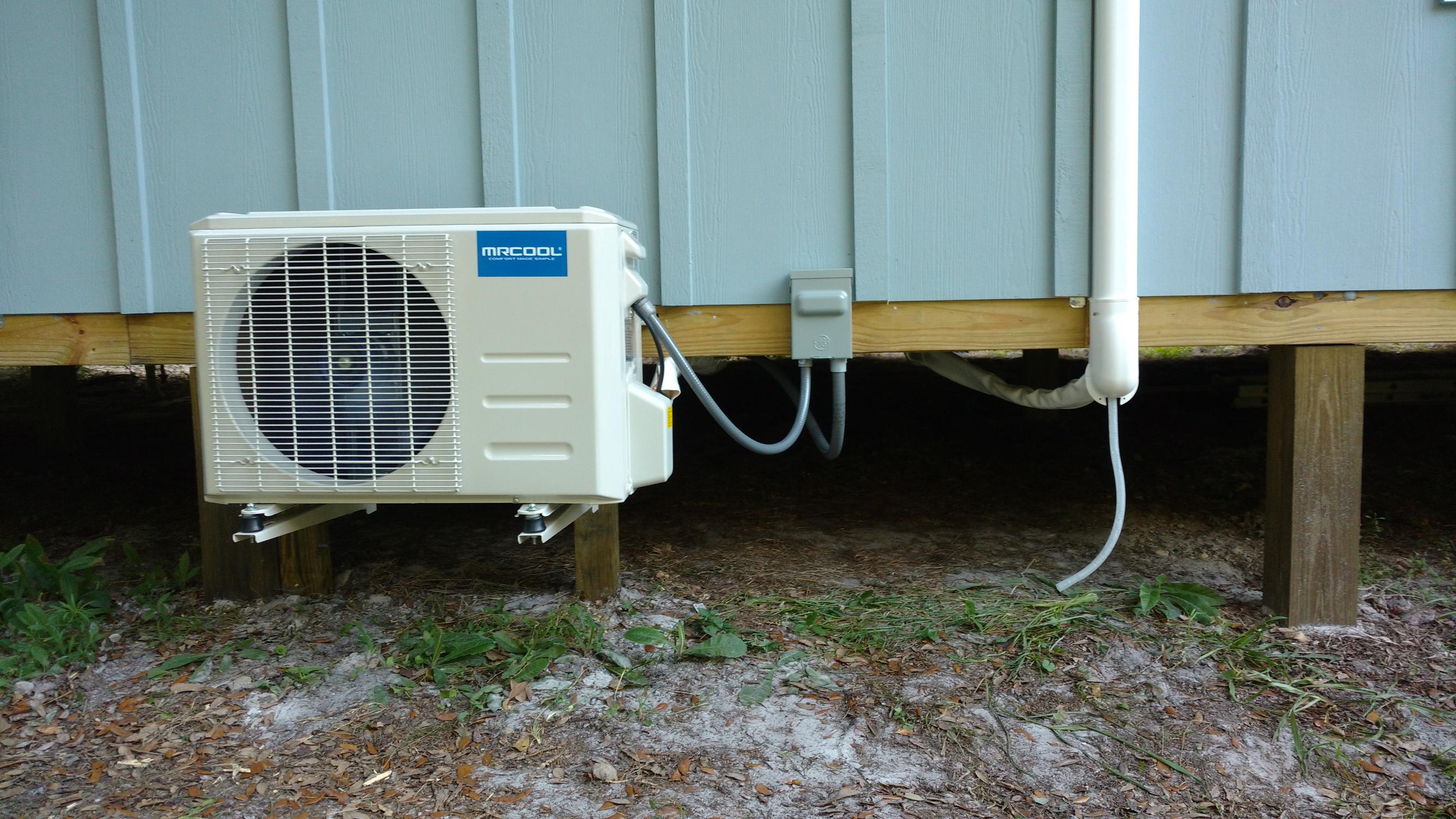

UPDATE/ I finally got around to installing my 18k Mr Cool DIY mini split in my hunting camp and so far I am very impressed with it, it has no problem cooling the 800 square feet camp and is unbelievably quiet indoor and outdoor unit, the best part was not having to hire an A/C contractor, I was able to do it all myself, I would recommend this unit for cooling to anyone, I will have to wait till winter to give an update on the heat pump portion of it for heat. Charlie.

I used a lineset cover that I bought off of Amazon and I just routed all the extra lineset under the floor joists and strapped it to keep it from going anywhere, I tried to make it as neat as I could.

No sir, I ordered it off of Amazon as well, but I ordered the mini-split from Costco as it was several hundred dollars cheaper than anywhere else, seems like that wall mount bracket was less than $50.00.

Looks good, Nice job.
