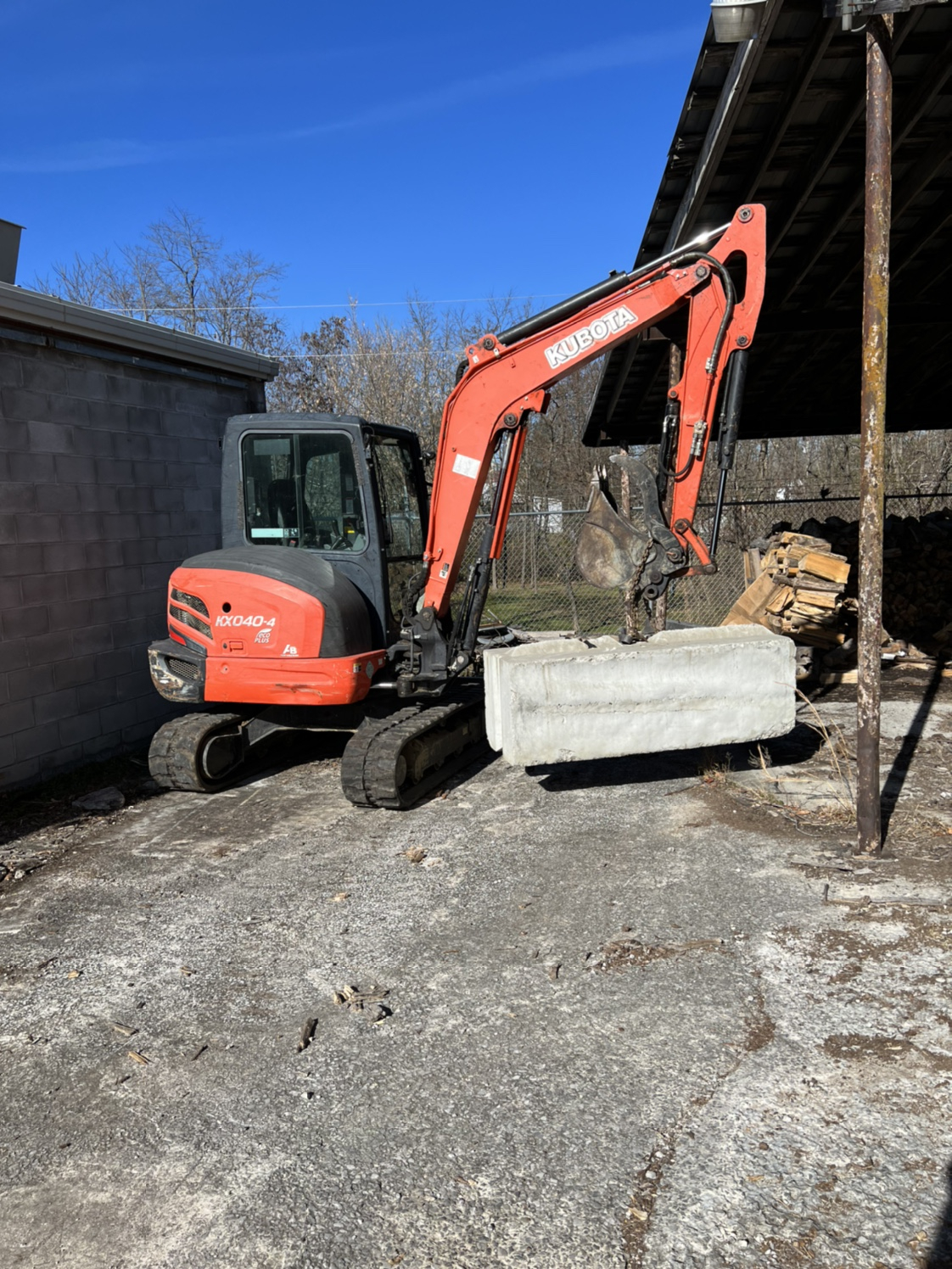

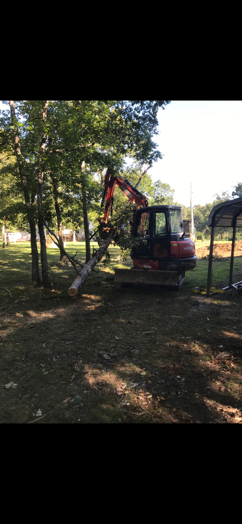

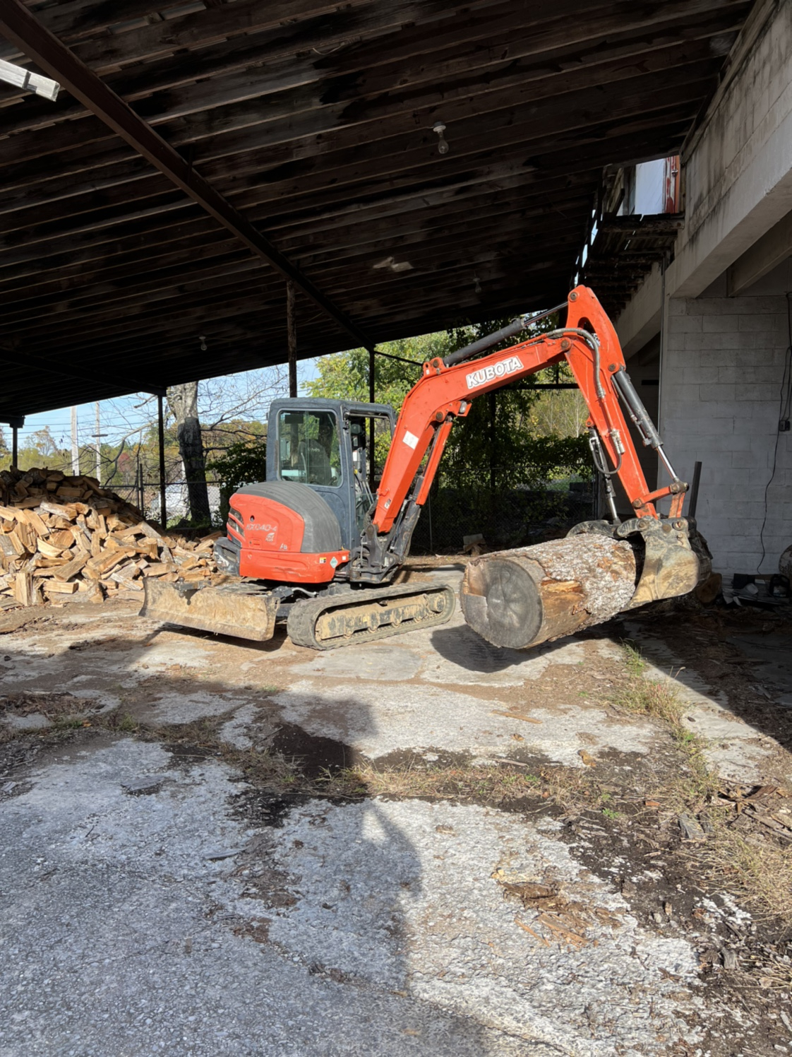

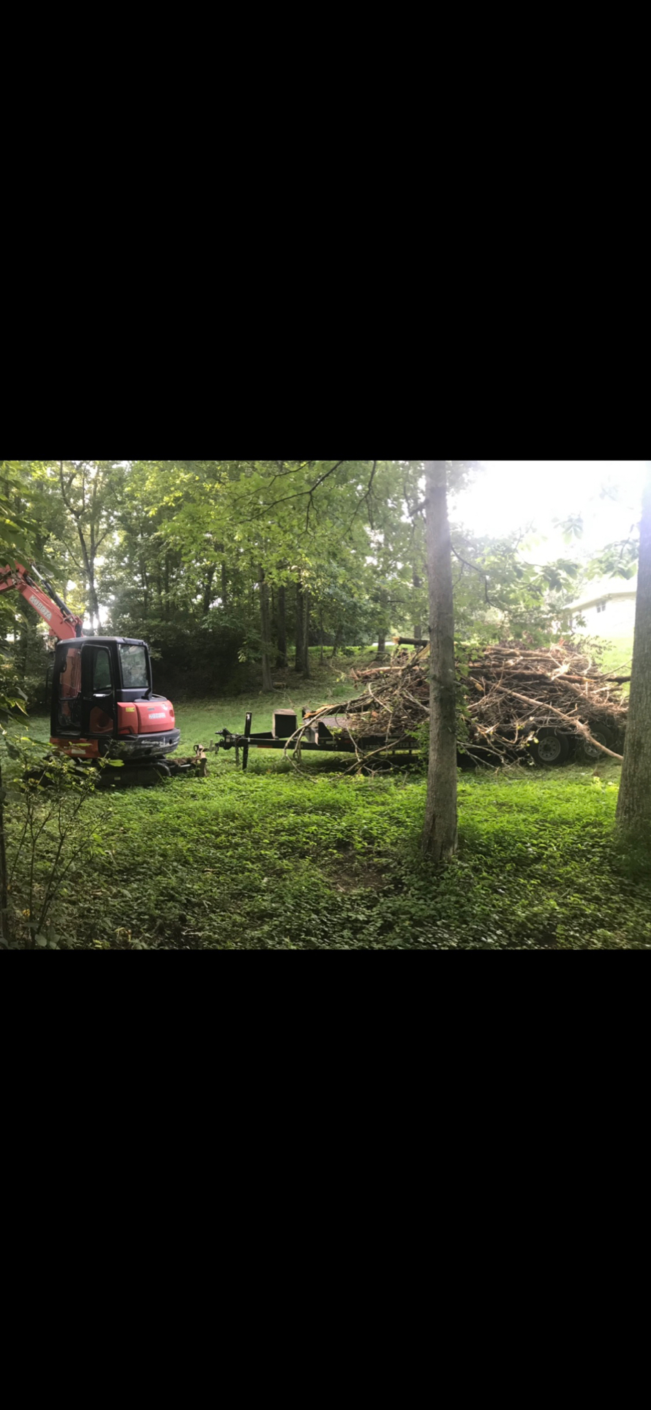

A mini excavator is actually decent for moving logs. It drives slow is the main downside but it can carry logs sideways which is nice when your trail isn’t very wide. Sure a tractor could drag it but that gets dirt in the bark and scars the ground. You can also pull a trailer and load it with the mini x to help with the low travel speed. I assume he doesn’t literally mean lifting stuff over peoples head. Not very many machines are rated for that. But a mini x is actually good at lifting stuff. You’d need a pretty big tractor to match what my KX-040 can lift. My L3800 can’t come close. Road maintenance definitely isn’t a minis strong point. I guess if you got a Kubota 40 with a 6 way blade you could do it. View attachment 776359View attachment 776360View attachment 776361View attachment 776362View attachment 776365

Fixa, you are so right on that. I find a lot I can use it for that saves on lifting things or moving things out of the way and create piles that the tractor can grab and transport. Wish I had gotten a bigger one and a 6 way blade. Also using it to grab logs and carry it sideways out of congested area. It is a tool that helps me be better at what I do at 80 years old
And excels at digging out stumps. The ability to index it around the work in progress is great. Using a big bucket with smooth edge is great for leveling. Wish I had a tilt bucket.
