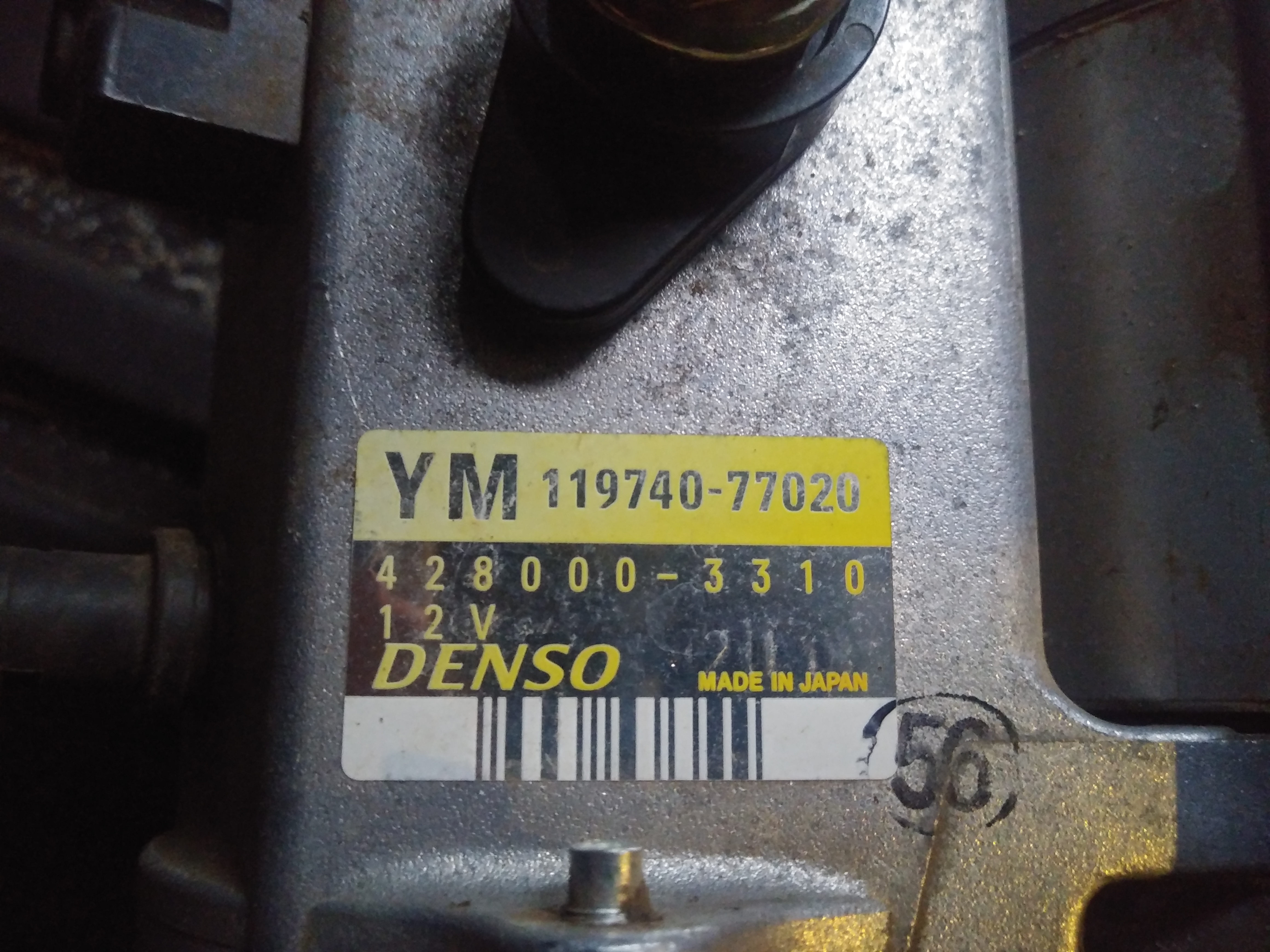

Btw-did a quick google on the YM part number shown-lists as a starter for a variety of Yanmar engines-many on line sources stock it at around $300
/ MT 125 ~ not starting #22
Wow! LS wants $1242.50 for that same starter. It pays to shop around.

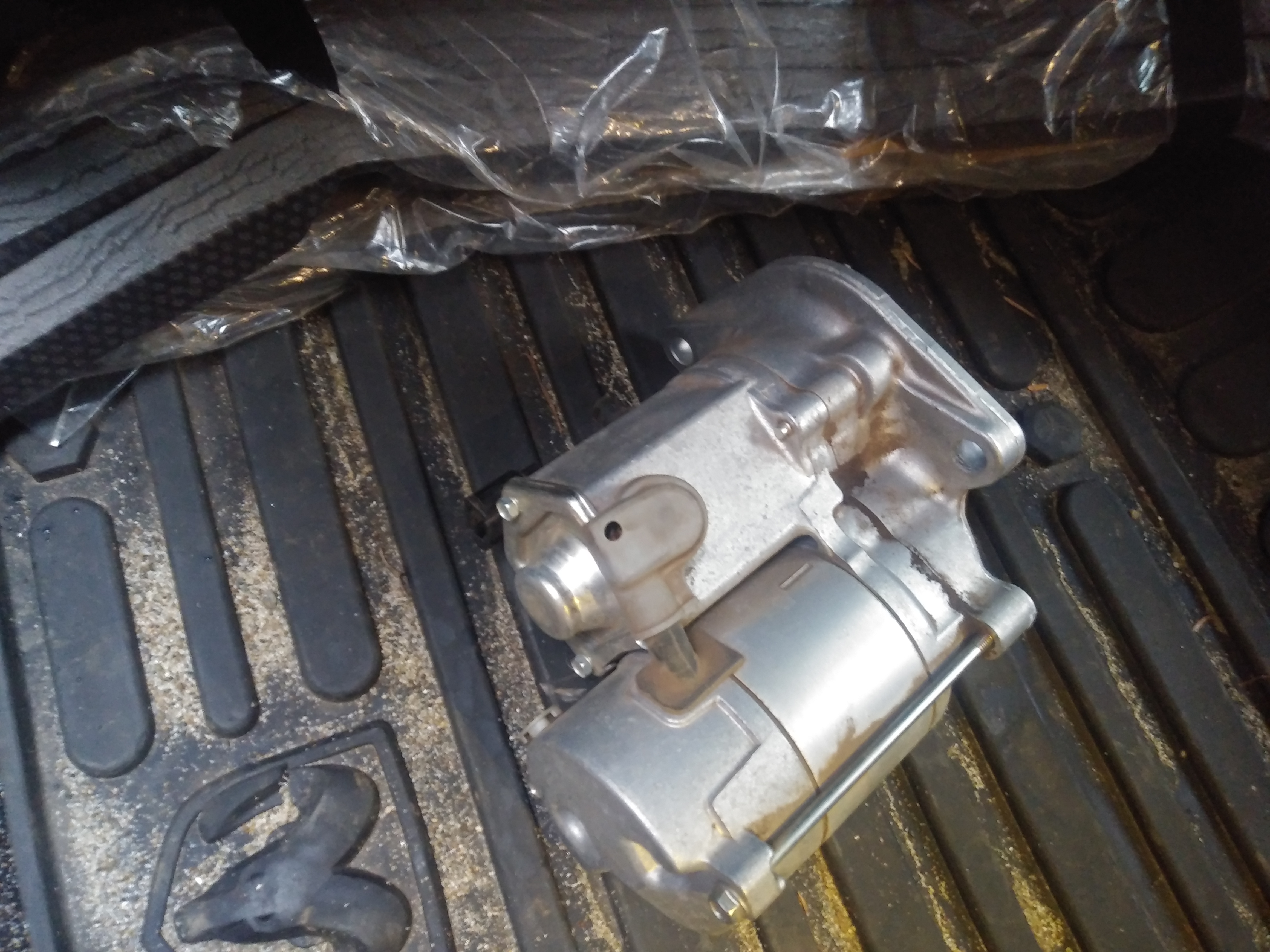

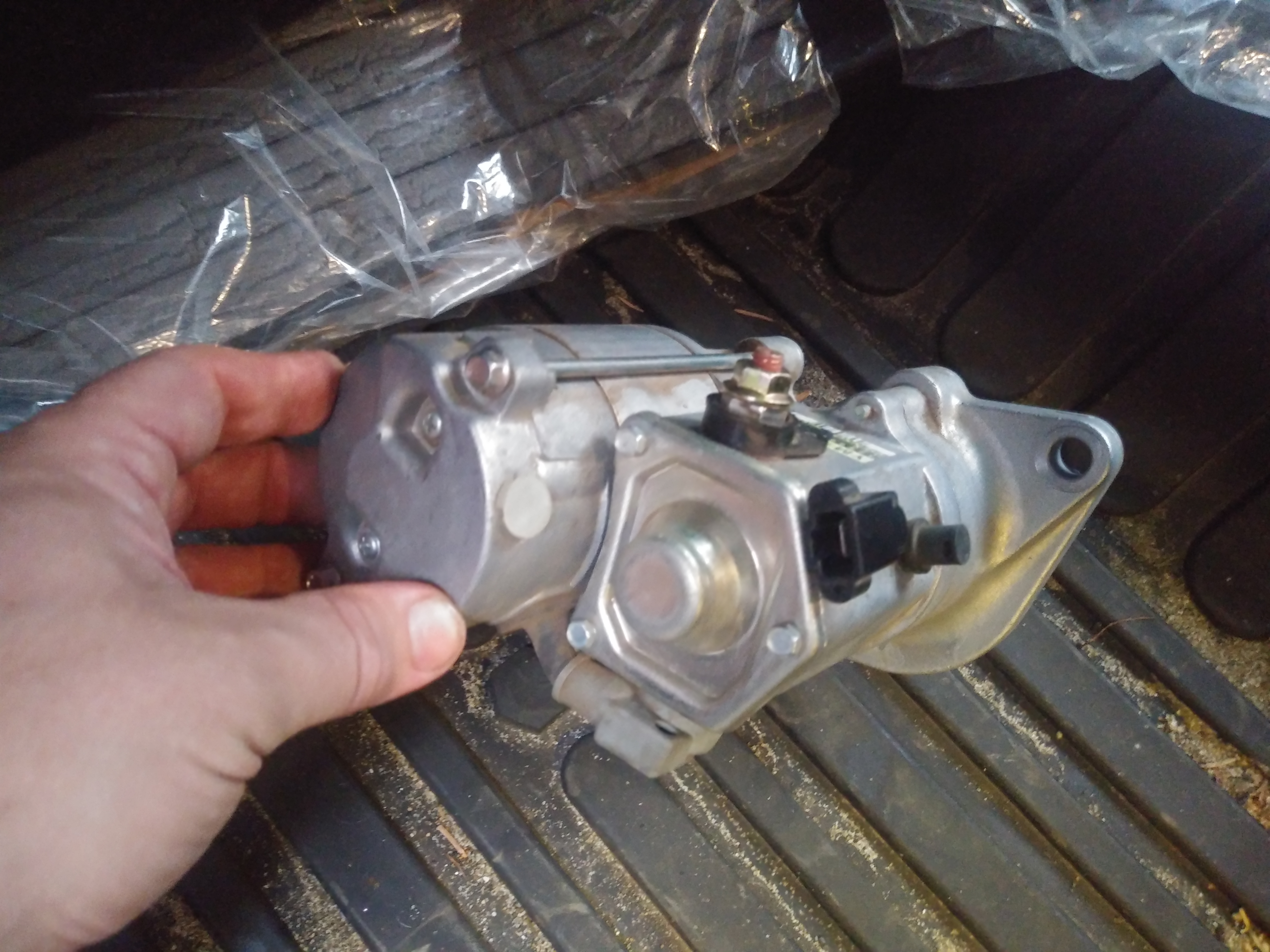

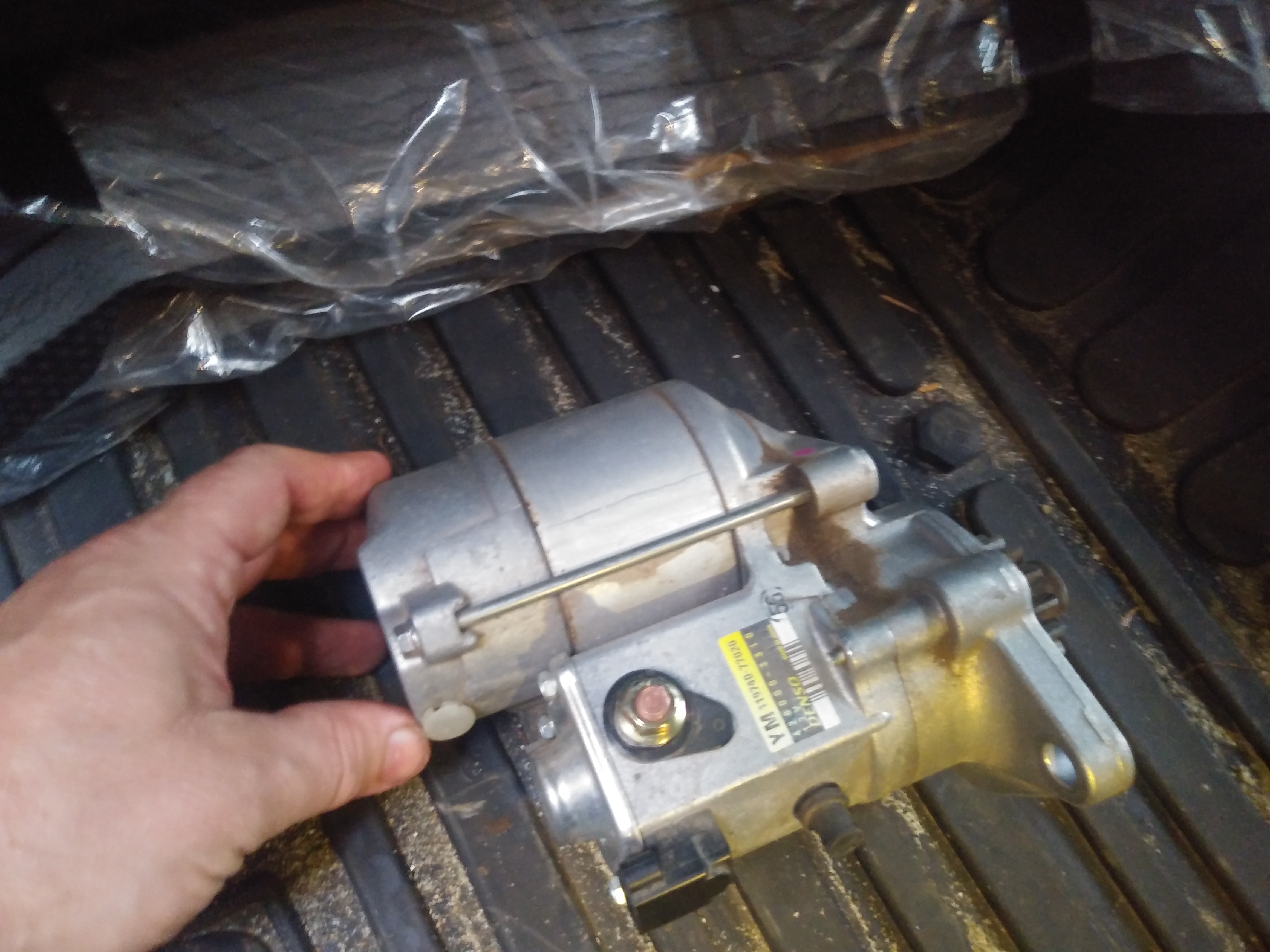

Finally made to Ernst Irrigation in St Paul Oregon. I didn't buy my machine from them,.......but I should have. Eating some humble pie in admitting purchasing from another dealer that doesn't sell LS anymore, due to "not getting along with them." The guys down there run a really fantastic shop. I work in a an industry that customer service is becoming scarce. SHops that chk things on the spot when you come in hardly exist anymore.
They took the time to show me a connector under and next to the fan underneath that they said comes loose too easily and a few other things to look for. They tested the starter and it seems to be working well enough.
Thanks for taking the time to answer and read this thread, will keep you updated.
