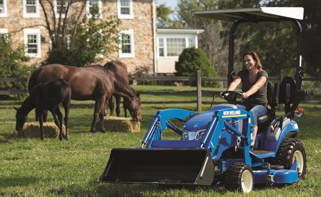

I see that New Holland is also using LS for their sub compact tractor the Workmaster 25s
I know that New Holland uses LS for all their small tractors
/ MT125 #12
That is good to see! The loader lift capacity on the New Holland website matches the lift capacity of the mt125 manual (1005 lbs).

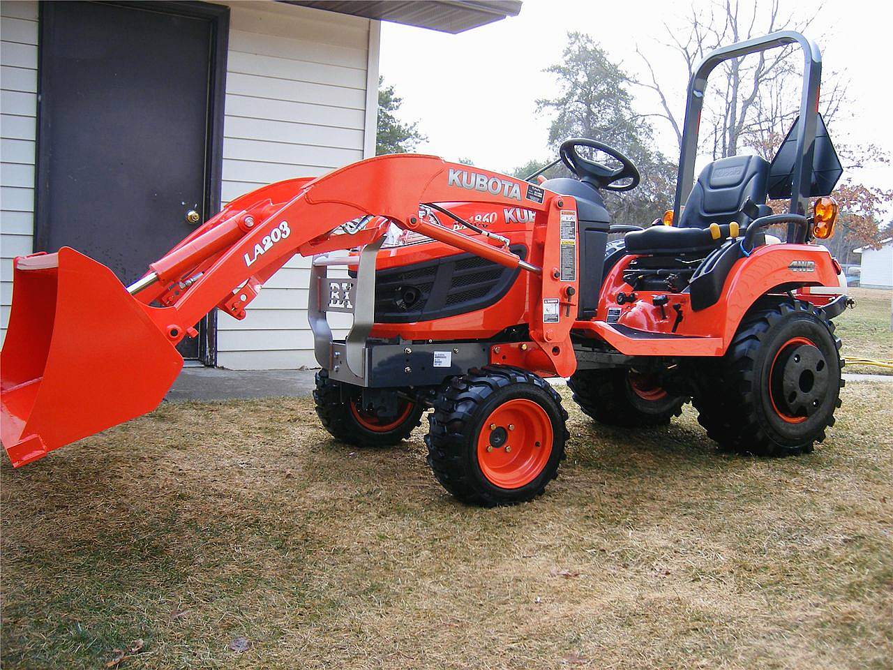

I've had both filled tires and cast iron wheel weights on my sub-compacts. They both have advantages and disadvantages. The wheel weights are ungodly heavy to install and uninstall. If you are young and bench 200 regularly pay no attention to this old man. LOL But, you can remove them is you wish, such as to prevent compaction in the garden beds, etc.
The filled tires I had effected the ride quality of the tractor to a noticeable extent. The ride was more harsh as the rear tires didn't seemed to absorb shock as they did with just air.
Both work. Both work well and are advised to counter weight the loader but also provide more mass, way down low, on the rear and traction is much improved and when pushing snow, they provide an amazing amount of extra oomph, if that's a word.
