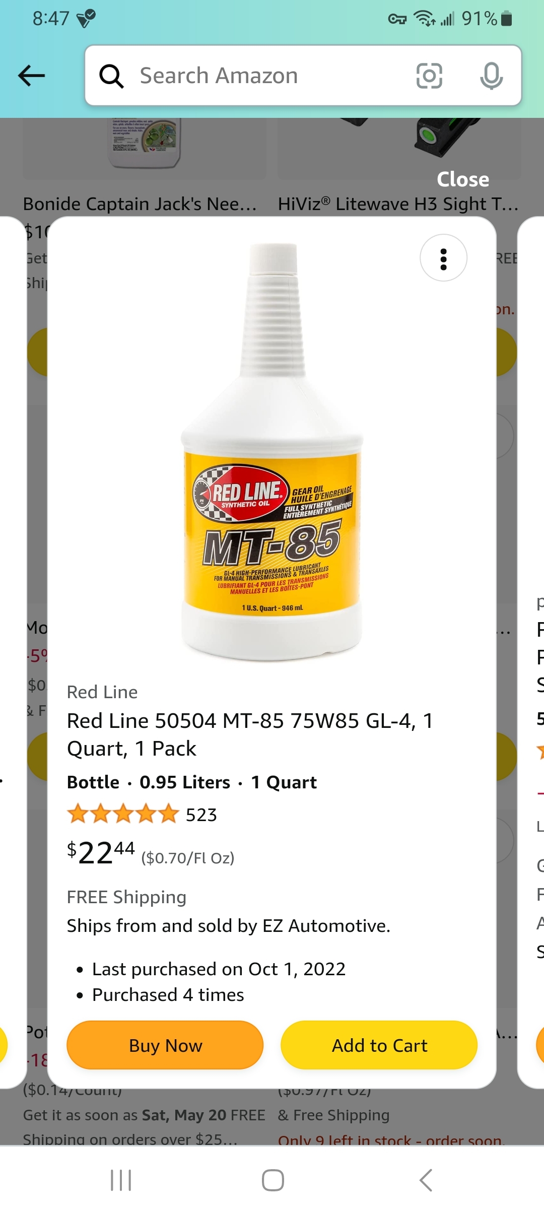

That was my thought as well. I stuck a clean screwdriver into the check port and determined there is oil in the axle, but not reaching the dipstick. Fortunately, there was oil there and it was both clean and not burned smelling. I'll top off his axle with this I have on hand for my cars which use this oil.
