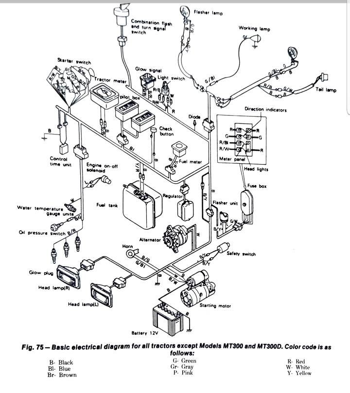

Looking for a wiring diagram for Mitsubishi mt2501fd or similar. Specifically ignition and dash components. I would love to find a repair or service manual but hard to find for grey market tractor.

It's pretty simple, the most complicated part is the standard ignition pinout for the connector.
What are you trying to identify or do?
   / Mt2501fd Wiring diagram
Previous owner lost key or broke it off in the ignition, so the ignition switch has been bypassed. It runs the way it is, but I want to replace the ignition switch so that my warning lights, tach, everything on the dash will work. They ran romex from ignition up to the engine, for? Maybe glow plugs? Kind of a mess
   / Mt2501fd Wiring diagram #4
Yup, that's the only thing to have a button for if they couldn't get a diesel ignition switch.
   / Mt2501fd Wiring diagram #5
This would be the wiring. View attachment Scan Sep. 29, 2021.pdf

Thanks that helps. I’ll order a new ignition switch and tackle that after I’m done splitting this thing and overhauling the clutch
