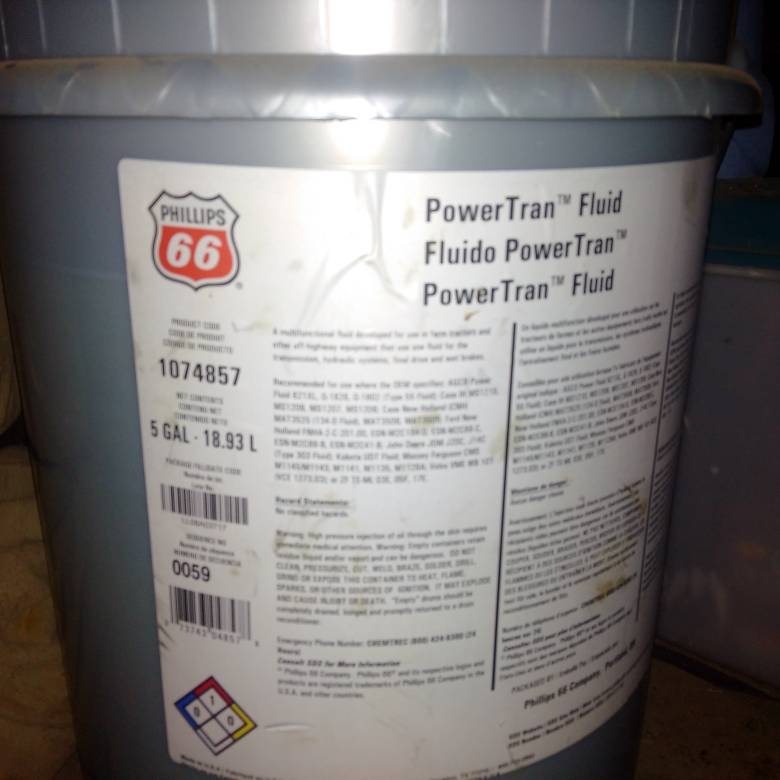

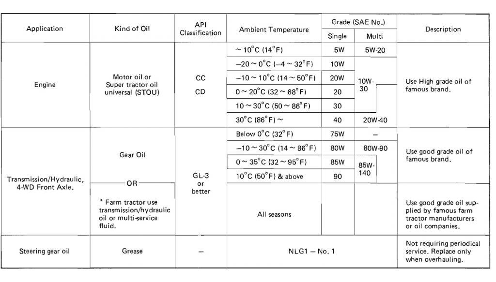

Also, can either one of you tell me what type of hydraulic fluid the MT2501FD uses and how much(capacity)?
I can tell you what type I use, as for capacity it depends on which chassis(es) you have and if you are also doing the front axle.
   / Mt2501fd Wiring diagram #14

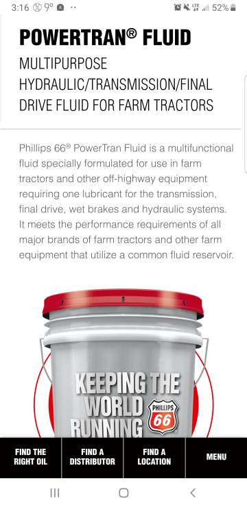

Yeah, there are a couple options in the manual. It's more convenient and easier to buy one fluid. Base call is for API GL-3 or better.
The PowerTran is a Agri rated hydraulic fluid. https://phillips66lubricants.com/product/powertrantm-fluid/
PowerTran Fluid also meets API GL-4 performance requirements.
