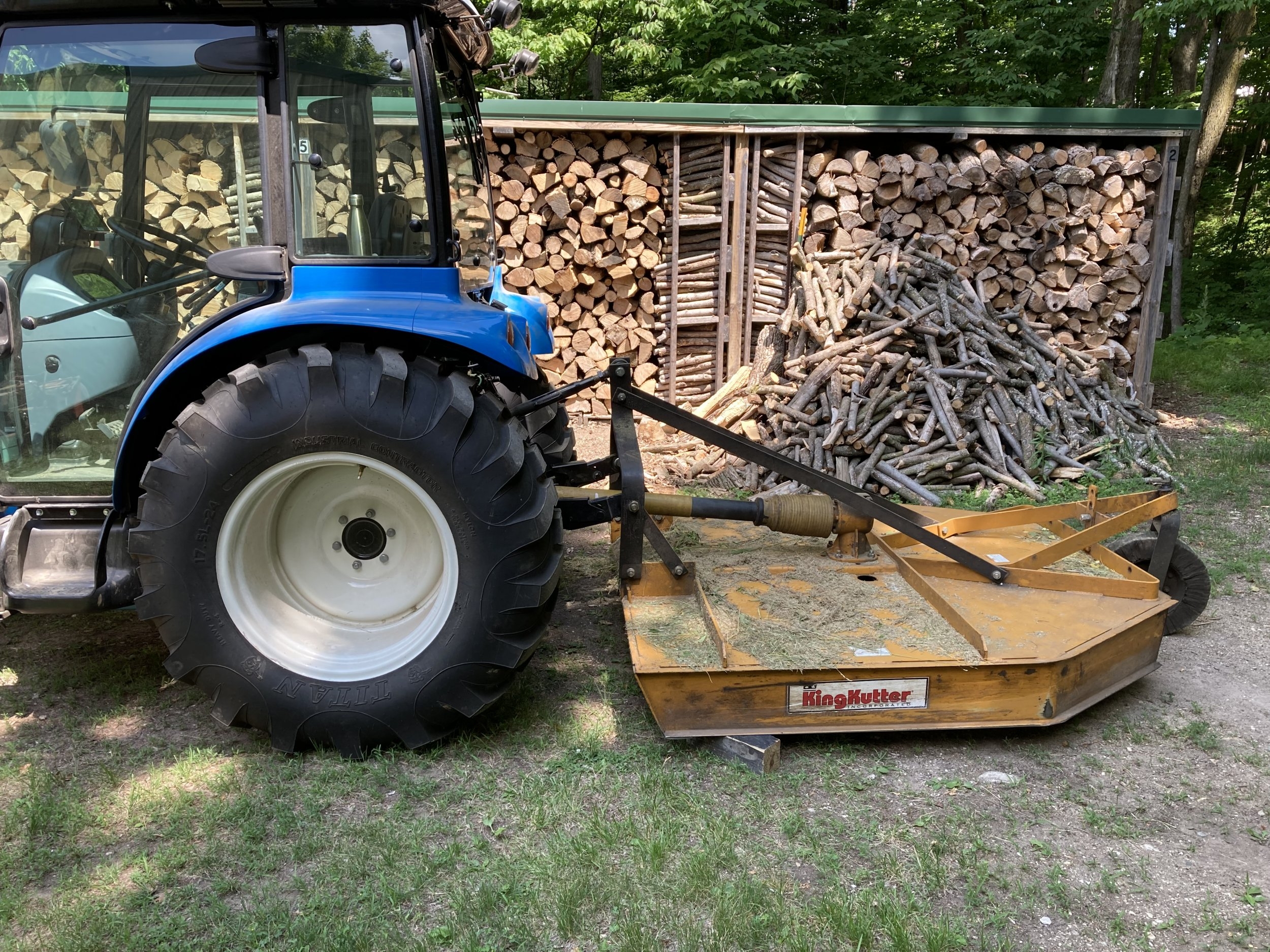

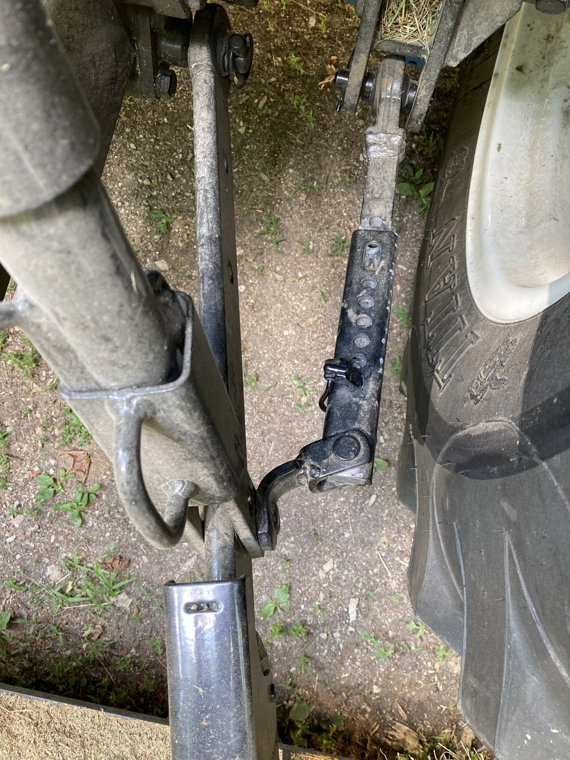

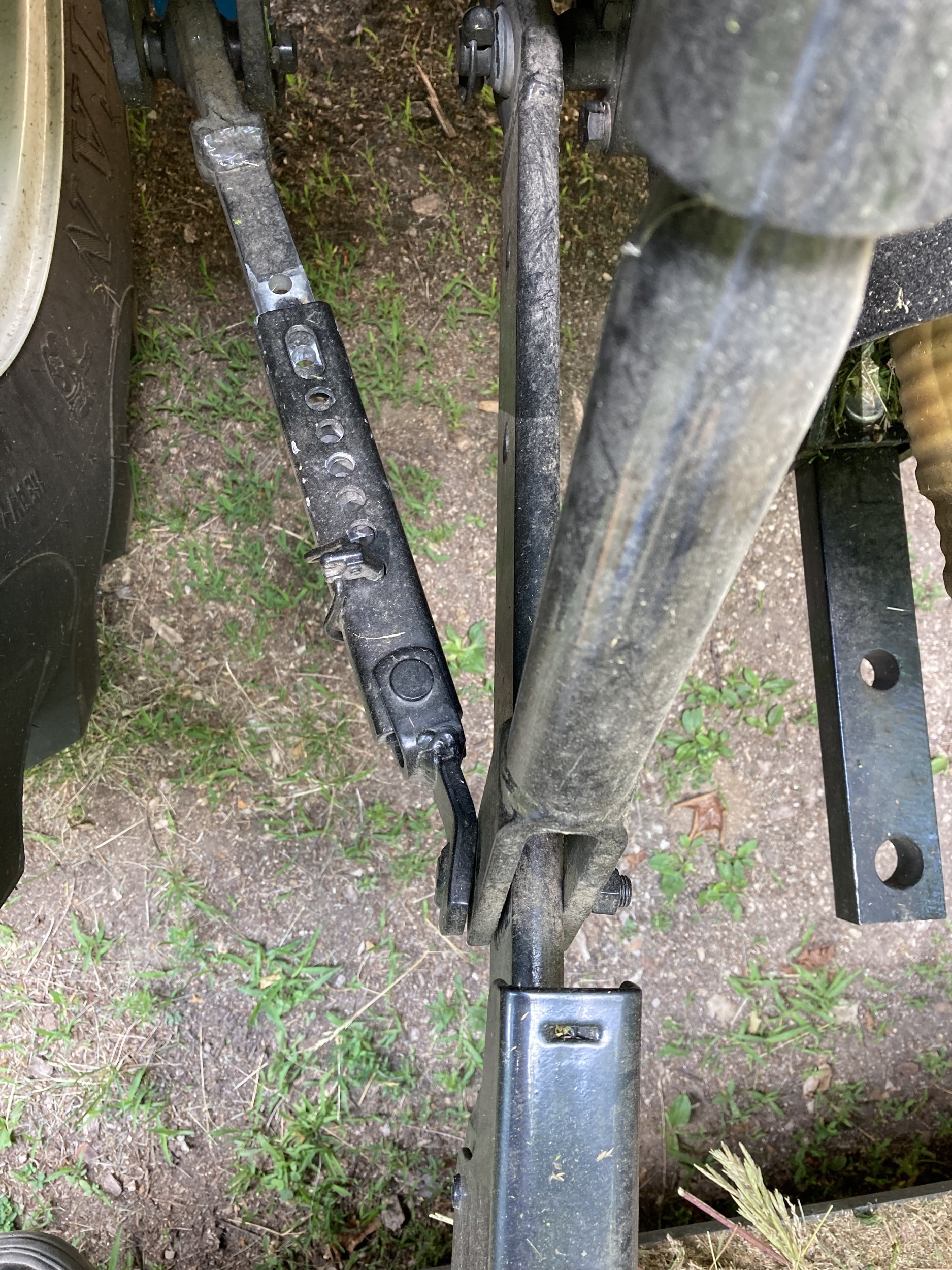

I've had a couple of parts bend on the 3pt sway arms when using my King Cutter 6' brush hog. I've been using this same cutter on my JD 2020 for the past 20 years and never have had any issue with it on that tractor. The first part to bend was the actual multi-hole bar. I was able to straighten and reuse. This time the bolt/bracket that attaches the sway bar to the lifting arm bent. Always seems to happen on the right side. I'm cutting all kinds of terrain including sidehills and flat areas and am wondering if the side loads are creating the problem for this tractor. Is this a weak point? I don't want to stiffen these parts up as I'd rather sacrifice them then break something more meaningful. Once it bends it no longer maintains the position of the implement and there's not a lot of clearance between the tire and the lift arm. I've attached a few photos to show the damage on the right side vs what it should look like as well as my setup.

How much side to side play to leave when you set up the cutter? Do you manage to get it without any side play?
While some of the parts do look slightly on the thin/flimsy side for what they do, I think you need to leave some side to side play. Mostly because the pivot for the lower arms is not perfectly inline with the pit for the telescopic stabilizers, this means the as the 3 pt raises as lowers, it will pull the arms sideways leaving it with some side to side play or completely tight and eventually bend something.
My tractor does the thing, minus the bending parts. It may or may not have stretched the holes slightly but I now set my implements with a little bit of play.
/ MT357 bending parts on 3pt #3
That's what I was going to suggest, what @ptsg said. But also, they will only bend like that if you're backing up and put a significant load on the mower.
I have the exact same mower. It's impossible to mow a field with any obstacles without backing up while mowing. My problem is either backing into the object (rock, tree, dirt pile, whatever) or the mower dives into the ground due to awkward angles + mowing low.
John Deere may have beefier links that can withstand a bit more abuse. My advise is to use the elongated holes in the links to allow for some play, and be careful about backing up.
The JD 2020 does not have the sway bar link setup at all. Beefy 3pt arms and it limits the side to side motion by using steel blocks are on the inside of each arm. These blocks are rectangular so you can change the sway by using the thicker or thinner side. One of the big problems I have with the LS is the ability to full lift the mower as high as I want due to the short lift arms (JDs are about 2" longer). This is one of the reasons I keep it a little tighter from swaying too much since if I keep it loose, contact with the tire is possible when at full lift. When I back up, especially when the terrain is not flat, the rear wheel can make contact with the ground. Maybe this is when it bent but I noticed the damage when I was sidehill cutting and the mower was drifting from center.
I've been using the JD for the more challenging terrain and areas around trees since it seems more stable than the LS and doesn't have a cab so it is lower to the ground, and left the easier cutting for the LS. Next time I cut with the LS I'm going to look at my setup again and see if I can improve it.

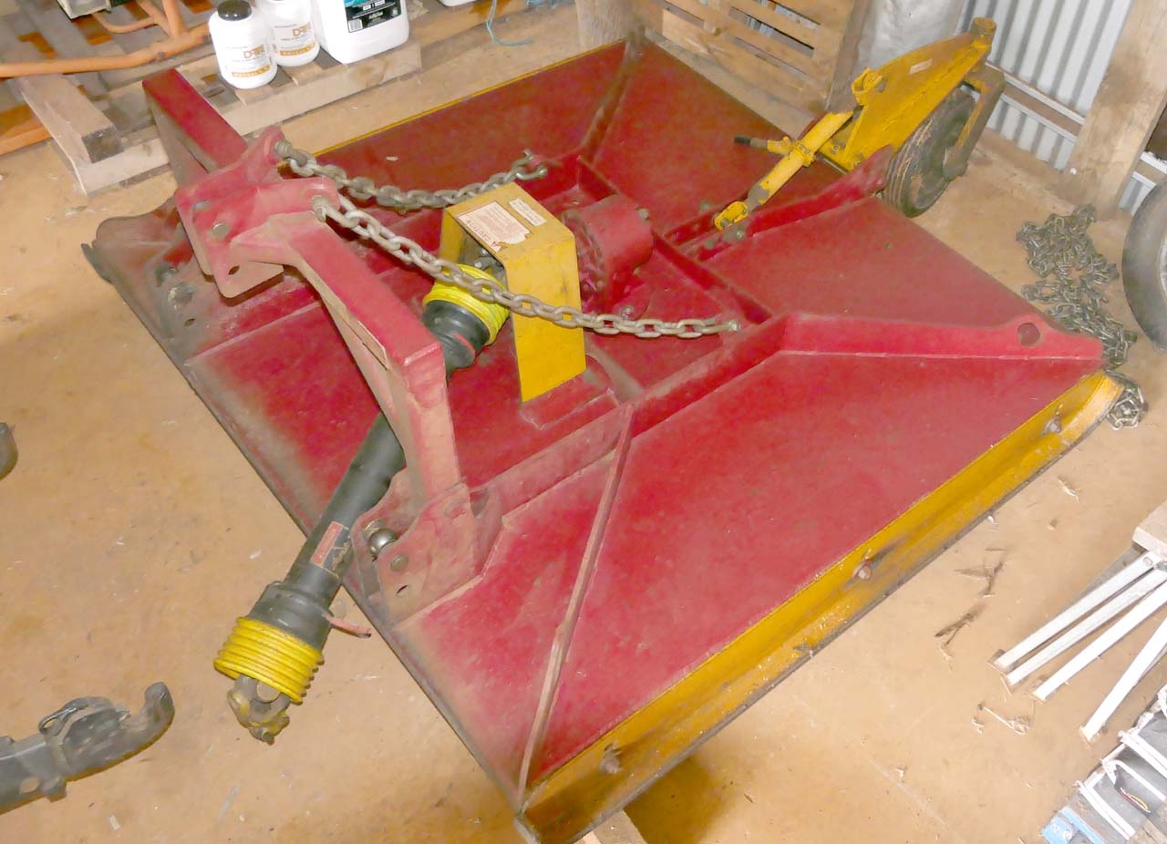

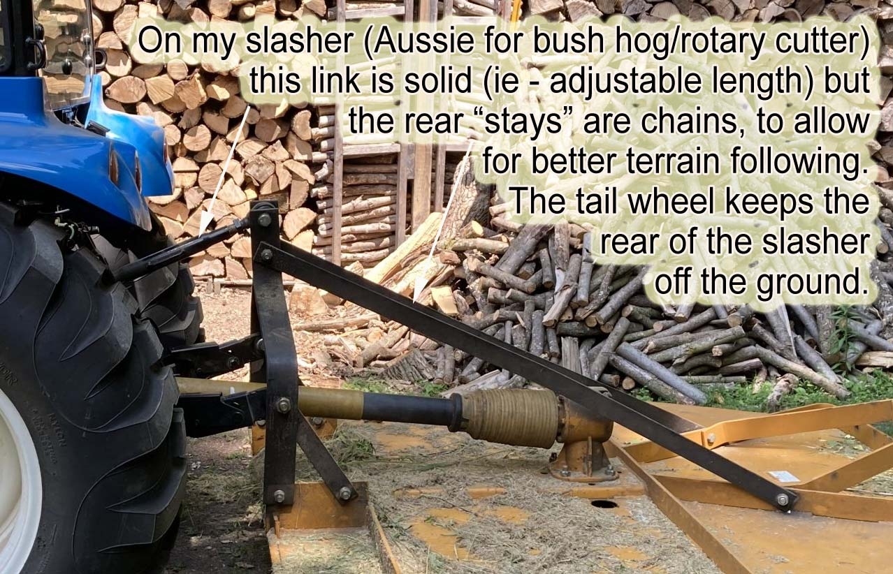

I would think having both solid could put excessive force on some links/parts when going through a dip for example?

I found Oz_Kioti's post on these being chains interesting. What brand of mower is that?
I've had this one for about 20 years now. It's super heavy duty, and was made by an engineering firm about an hour's drive away. As you can see, the head-stock pivots so there's absolutely no stress on anything when going through a dip, or when pushing it backwards up a slope.
By adjusting the top link as required, you can have the chains as tight or loose as you want. I leave them with some slack on level ground, such that when doing sharp turns, I raise the 3PL, which lifts the front of the slasher off the ground and the rear pivoting wheel takes the weight so the back edges of the slasher don't dig in.
In practice, I have it all adjusted such that on the level the side skids are always just clear of the ground.
I ran it behind a 47hp LG (now LS) for many years. There was a fair bit of gear changing involved depending on the slope & amount of grass to be slashed. But since getting the 76hp Kioti three years ago, slashing is now a breeze!

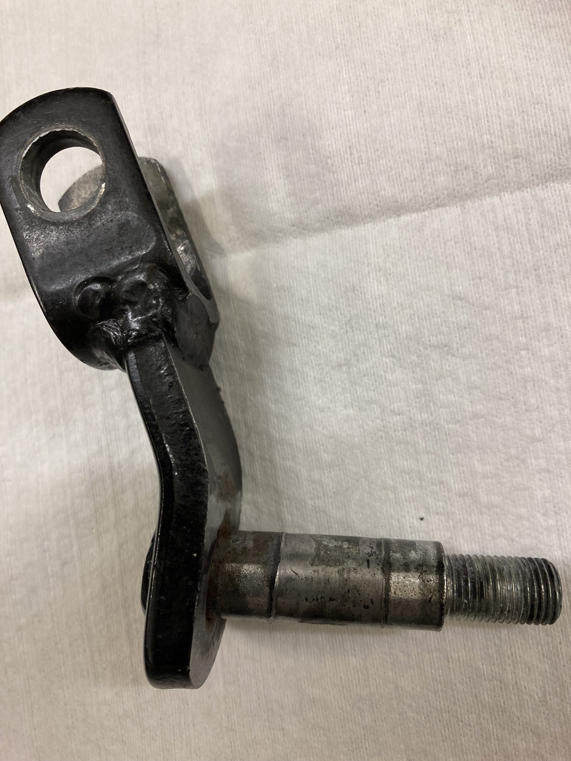

Here's the part I originally bent after I straightened it out. Note the wear pattern on the center of the pin. More than I expected for the low hours on the tractor using the 3pt. I decided to drill the holes necessary to install a grease zerk to hopefully lower the wear.

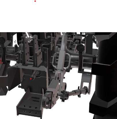

I was at the local TYM dealer and was looking over their tractor line. Seems to be fairly well put together. One thing it is beefier on is the telescopic stabilizer links for the 3pt arms. Much heavier and a better design than the LS. I didn't get a pic but did find this on their website. It has a cast part at the lift arm instead of the bent flat plate so the forces go into the lift arm instead of bending the plate like mine did.
/ MT357 bending parts on 3pt #19

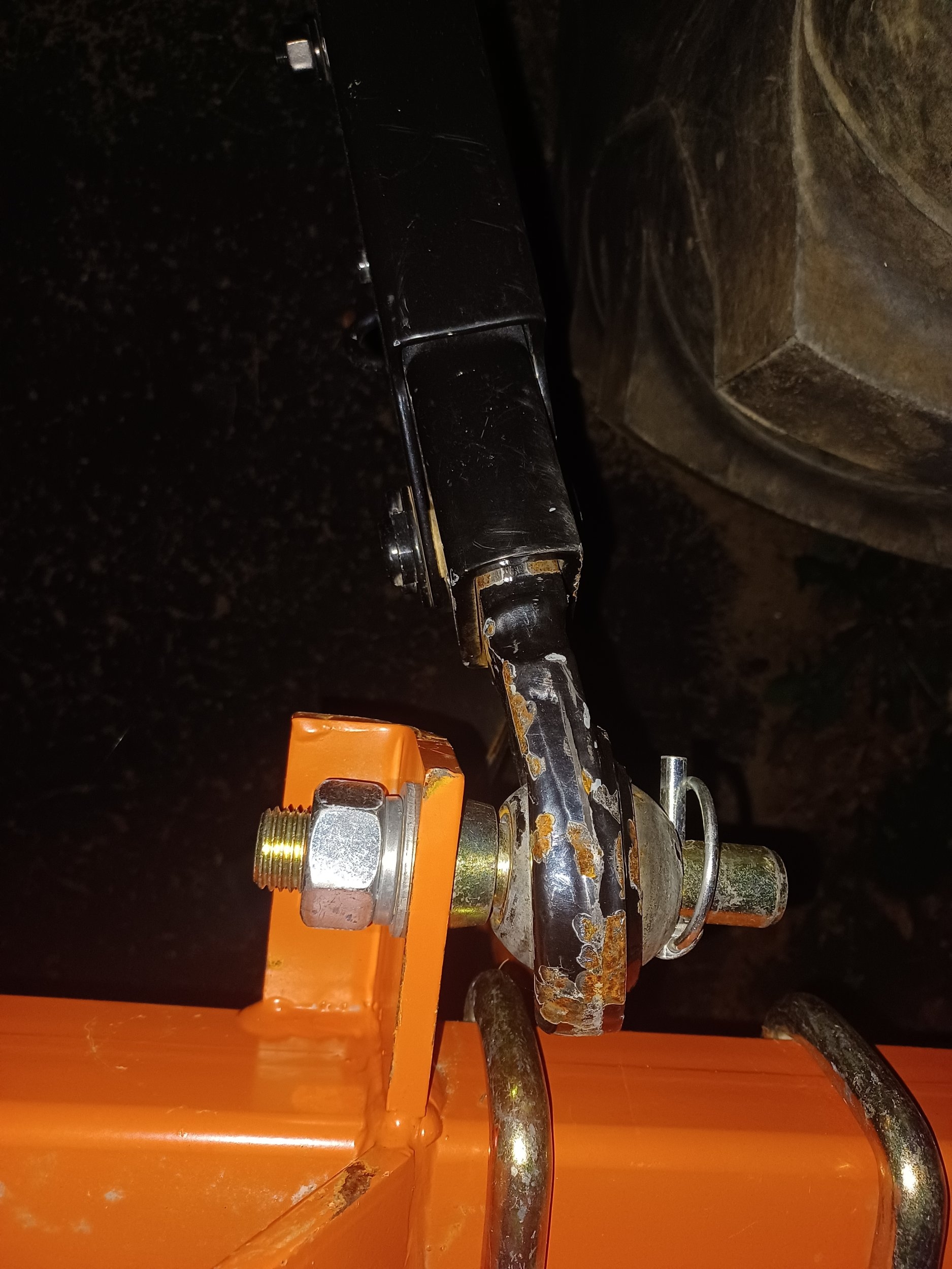

I had this issue as well. I bent and broke the links a couple times, then took them off and replaced them with class zero telescoping threaded links (same design as 3ph top link, but smaller). Problem solved, no problems since. Obviously you have to install class zero hitch pins in the 3ph lift arms to make this work. They fit perfectly.
