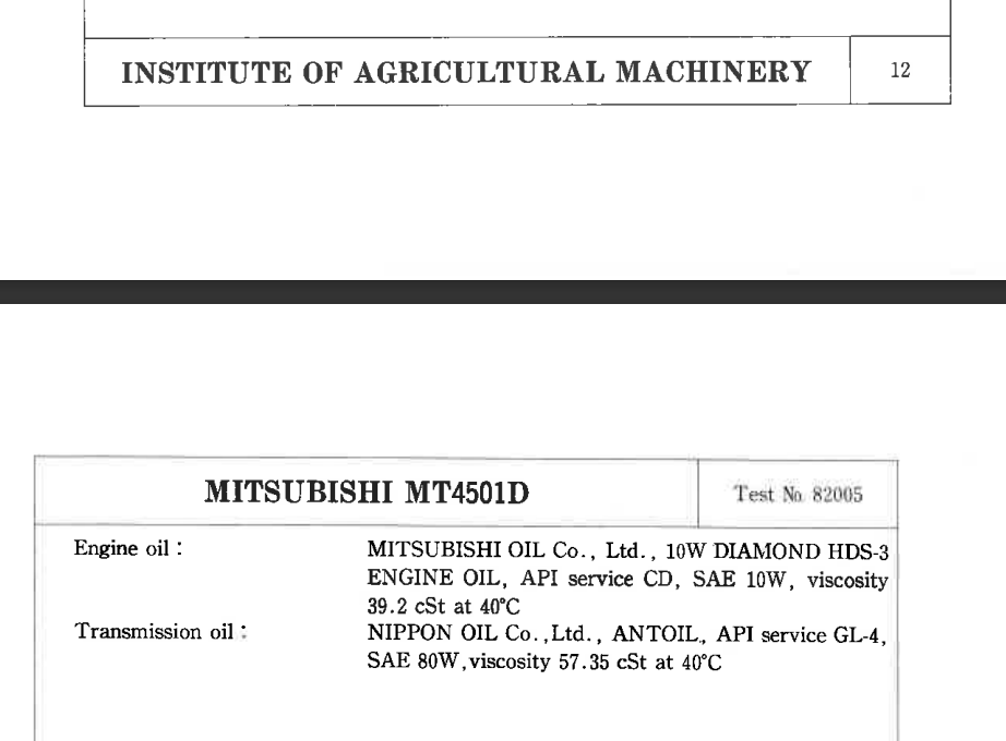

I have an MT4501D that I bought at auction a few weeks ago. Tractor runs strong. PTO did not engage at first. I raised and lowered the 3 point with weight and the PTO started to spin strongly. I attached my 5ft tiller. It took some time to start to spin the tiller but does so until I try to till the ground. As soon as I start to till the motor bogs down and dies. I changed the fuel filter and have a new hydraulic filter to put on. I do not know how long this tractor had sat before going to auction but my guess would be several years. The transmission oil is clear and looks fresh. The hydraulic hoses need to be replaced but are not leaking. Is it possible that the system may need bled? I have an owners manual and see nothing about that. Is it possible the wet clutches are bad? The motor also bogs down in high range first gear and dies. In mid range it runs but wants to die uphill. In low range runs like a champ. Any input or direction would be greatly appreciated!!

The first action to take would be a hydraulic fluid change and clean/replace the filter.
Per the MT4501 manual, this is the hydraulic oil to use.
Here is one manufacture of the hydraulic oil for your machine,
Castrol oils and lubricants for your MITSUBISHI [Tractors/ Tillers] MT4501, MT4501D
CASTROL AGRI TRANS PLUS 80W​
A multipurpose, wet brake transmission fluid for use in hydraulics, transmissions and PTOs. Its SAE 10W-30 viscosity rating makes it particularly suited to regions with cooler climates and where a lighter viscosity lubricant is recommended.
When running just the 3PT lift, the PTO should not begin to spin. Something is amiss.
Recall, these manuals were issued PRIOR to the multi-grade oils in use today.
Thus for engine oil, the 10W would cross over to 10W30 diesel oil such as Rotella T4 10W30 diesel. Japan tractors are engineered to JIS standards and NOT to SAE. Remember that.
