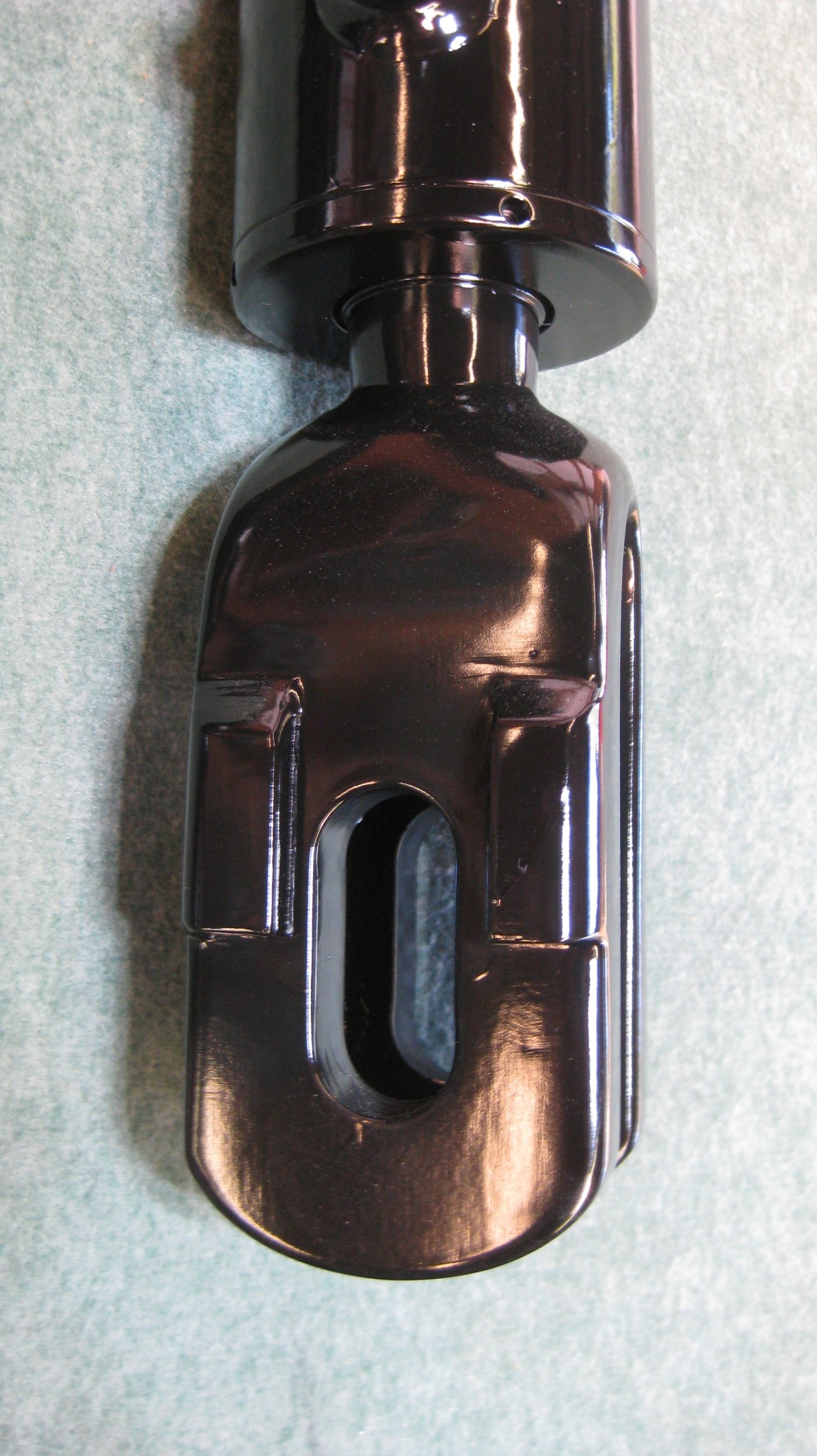

I got a hydraulic top link for the 3pt hitch and now I am having a difficult time finding a good solution for the side link for tilting the 3pt
Wondering if anyone has already solved this?

For a side link look on A and I ag parts. Only place I could find one.

I ended up going with agristore.com and modifying the cylinder to our set up

For the OP, your current hyd top link is a bit on the small side for the capabilities of your tractor.
The hitch has lift capabilities in excess of 6600lbs, you should really have a 3" dia cylinder IMO.

I used the Fit Rite Hydraulics. I figured for cylinder size and to have the factory style slotted end it was a easy pick. Pin on and go.

FitRite is an awesome way to go for sure, I don’t want to wait or spend that much.
The route I went works for light duty implements we use.
Thanks for posting all your options for others to see and also something for me to upgrade too if need be.
   / MT5 Top and Tilt for 3pt hitch #8
Yeah the wait was the only down side. I ordered last fall so I got my kit in the spring. One thing I liked was no check valve but flow restrictors. I like to use them in float sometimes.
